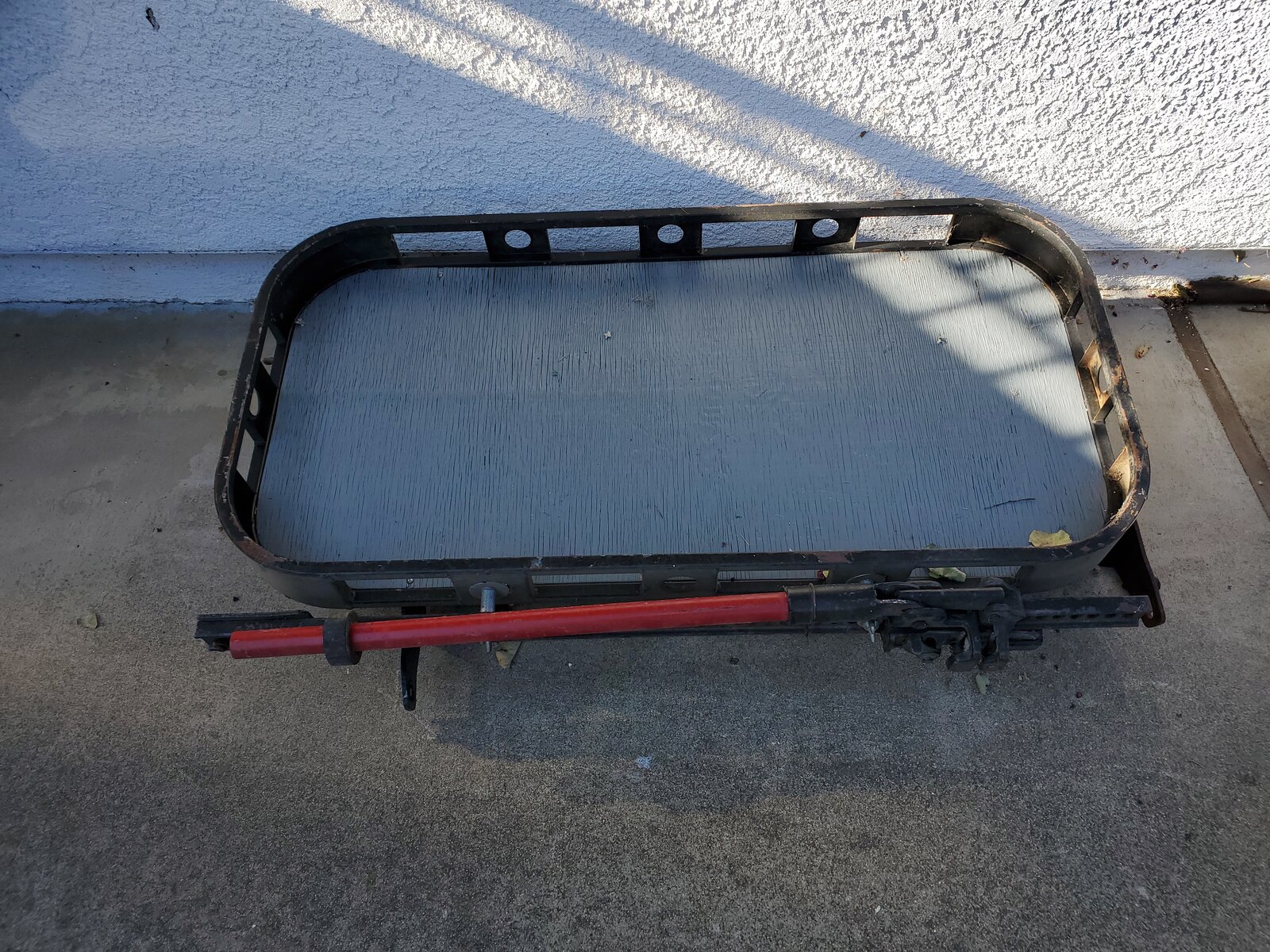

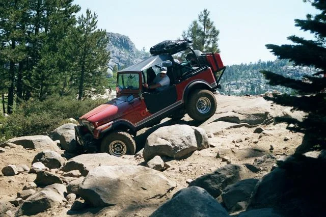

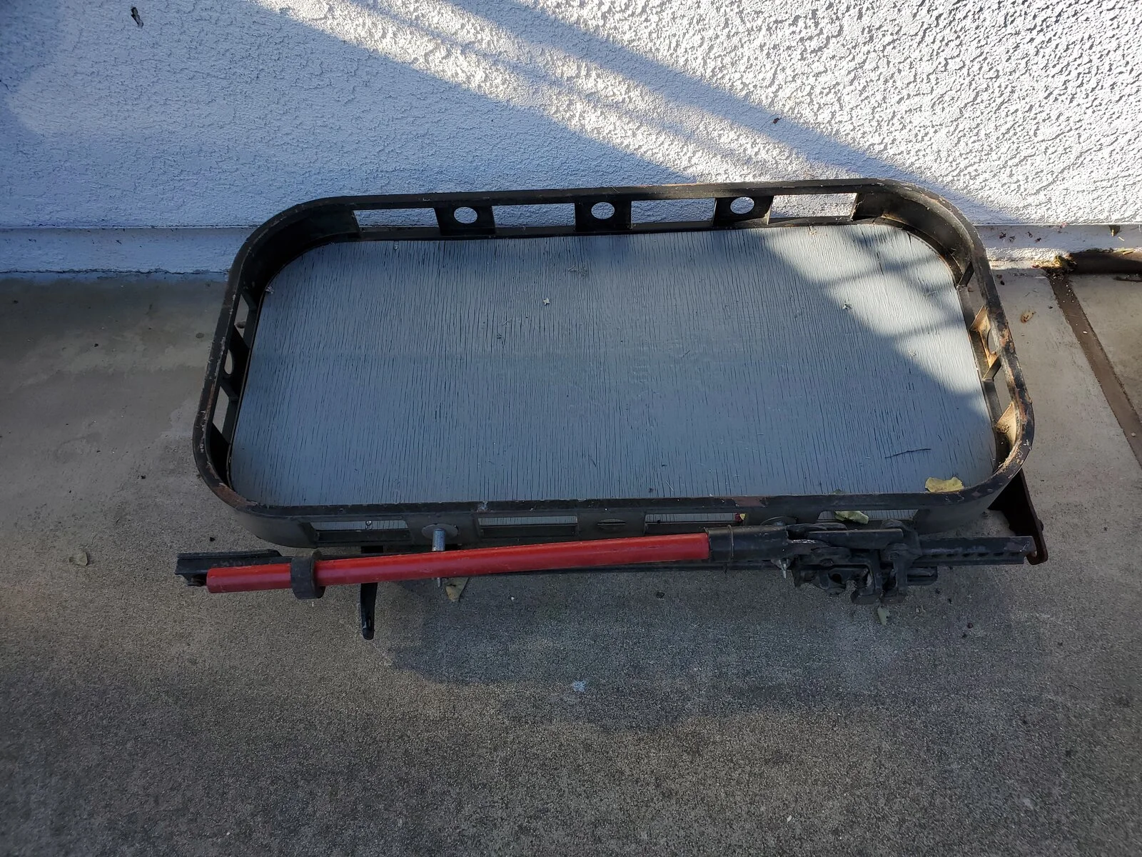

For my CJ-7 I used a small Con-Ferr roof rack over the rear seats, bolted to brackets welded to the roll cage.
I still have it sitting by the side of the garage "just in case" I might need it again, along with an old High Lift that was never used.

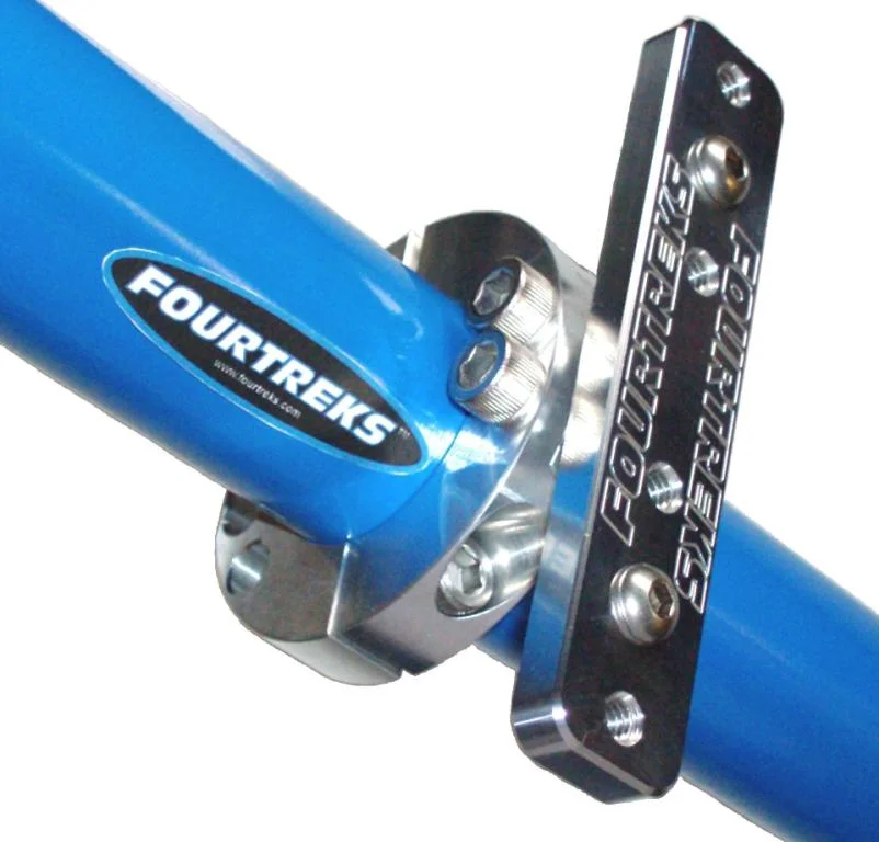

If I were doing it today, I would either use Yakima mounts and two round bars or I would investigate roll bar clamps such as products from http://fourtreks.com and other suppliers, and bolt the roof rack to those.
As for the roof rack itself, figure out the dimensions that work for your roll bar and start googling roof racks and roof baskets.
