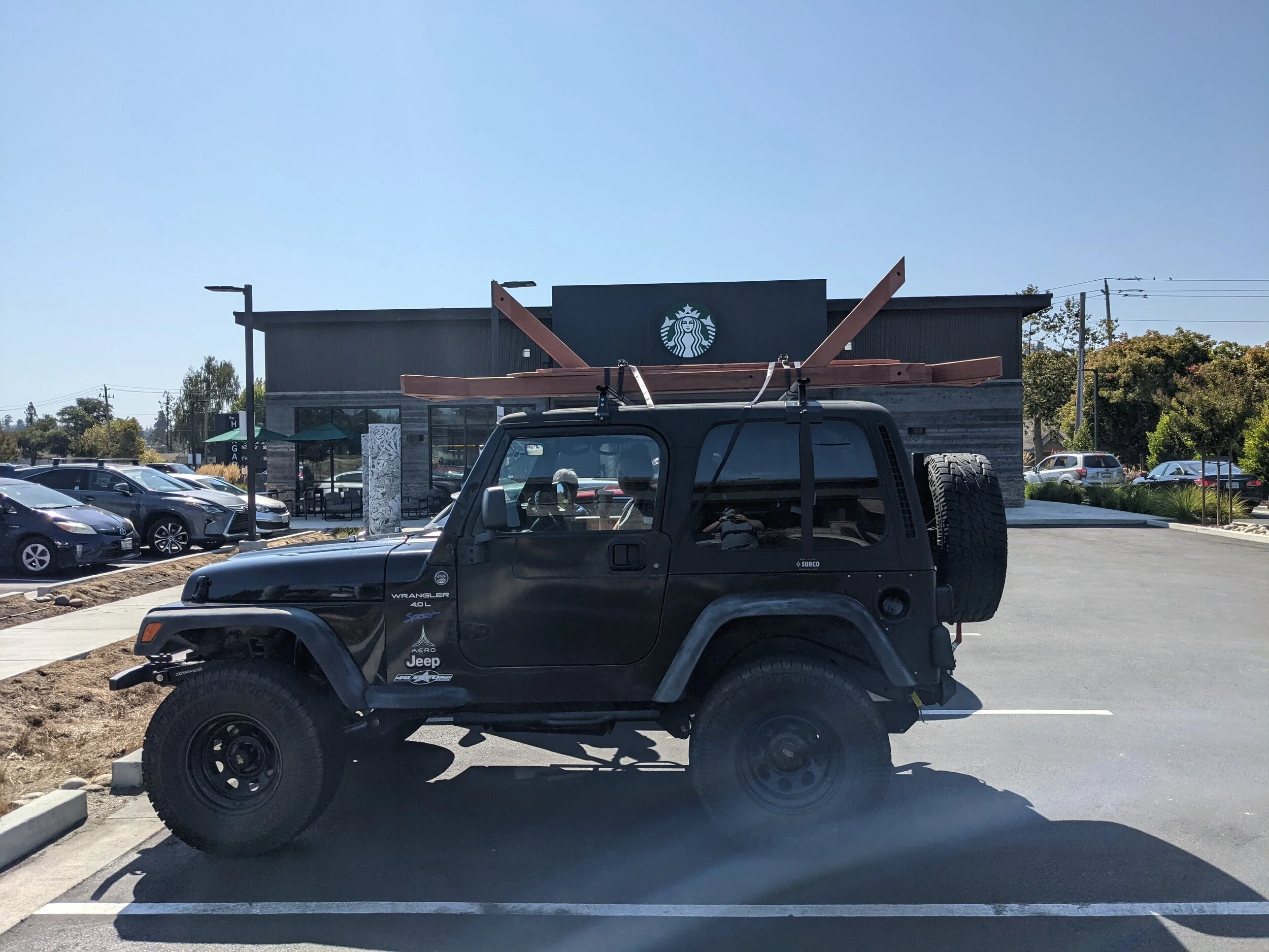

Did anyone end up tying to mount a roof rack sandwiching the hard top with brackets to the cage? I have done some searching and not found much info. I have installed a few on jks with zero leaks and that style of rack is actually supportive and useful.
I keep bouncing between through hole to the rollbar and just running a Gobi. I can't find a way to do the through-hole mounting that lets me sleep well at night. For now, the project is on a funding hold.

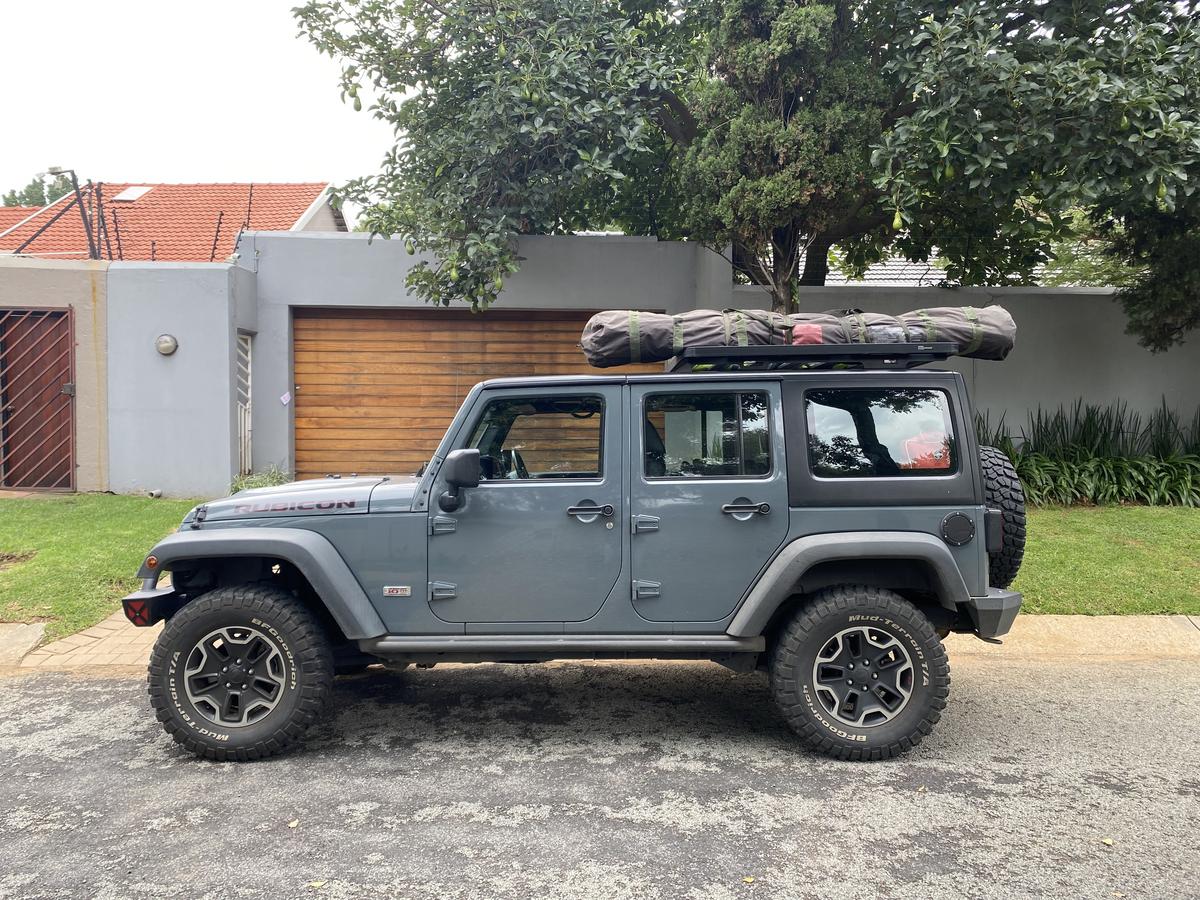

Frontrunner rack on the JK drills through the roof to mount to the Rollbar. My wife has one on her JK. It worked very well, with no leaks, until I had to remove and re-install and drill out some rusted bolts. They use like a pad of foam around each hole, glued to the roof to help seal.
It is a pain in that you can only ever run the rack with the hard top on, or hardtop off completely....no soft top. But I figure you've thought of that.
You can see the supports to the rollbar here...uses the JK Softtop mounting holes (which don't exist on the TJ so you'd need to do some drilling)
To add, it's fooking strong. When they initially designed it, Front runner had a video of them picking up a JKU by the roof rack with a crane.

As far as the Gobi's go, I helped my buddy install his on his JKU and he is very happy with it. We drilled several holes in his top. We were extremely worried because we could not get the mount to fit correctly on one side. That is when we realized the template was incorrect. We had to modify one or two holes (make them larger) so that the bolts would line up correctly. I was so worried. I just could not see how that mount on the rear driver's side would not leak. Two years and at least a dozen trips it is still dry as a bone.
