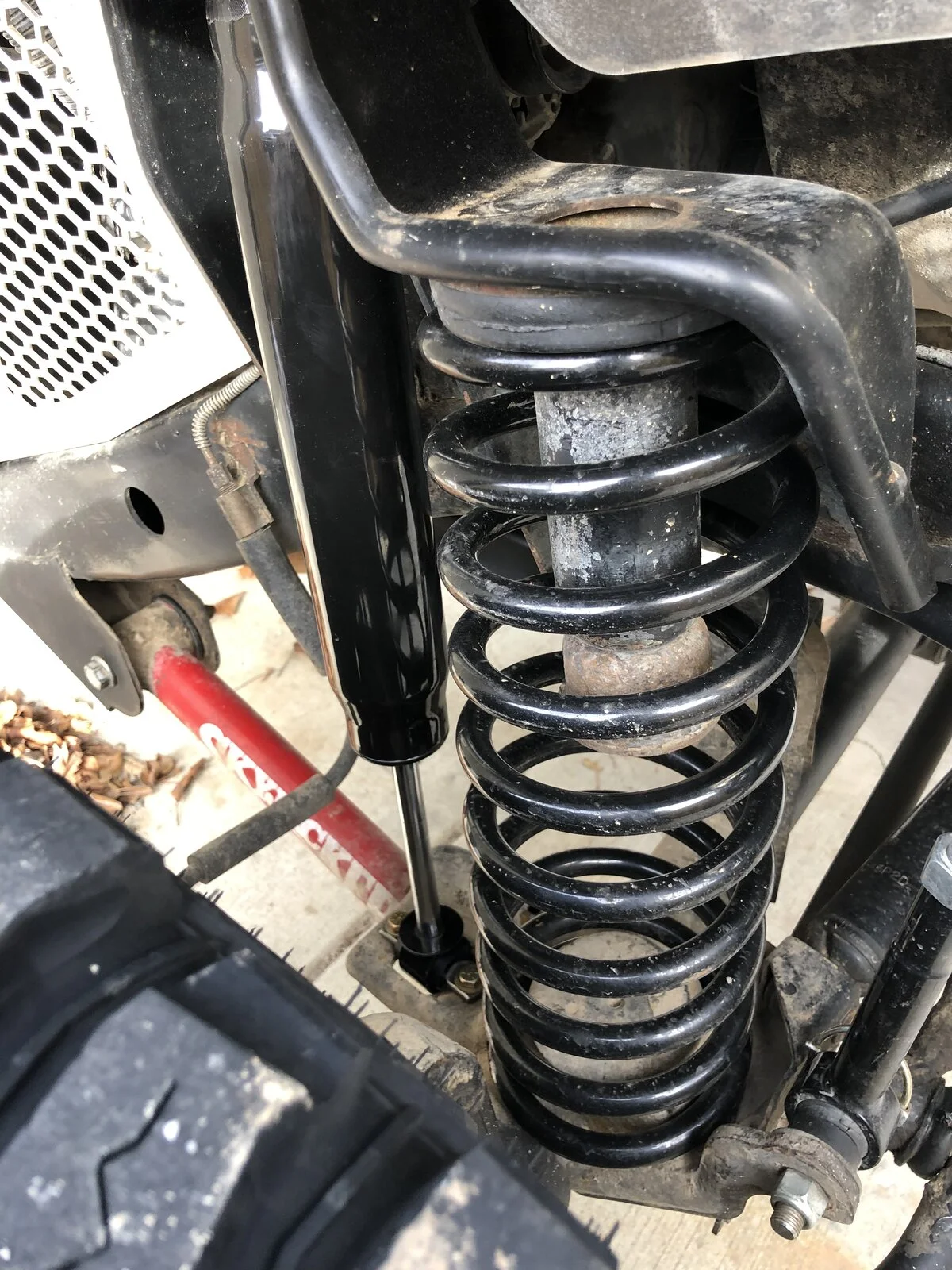

Something's not right if you're still getting that rough of a ride on 24 psi in 35" tires and you've even tried the RS5000x shocks from Rancho. Can you take a good photo of the shocks and springs with the weight of the TJ on the axles/tires on the ground? And hopefully you don't have boots on the shocks, we need to see the exposed strut length.
Again, I’m waiting on bumps to get here, commercial tire tore up the tie rod when I took it in for an alignment, another thing to note is something knocked it out it really out of alignment.
It has a dropped pitman arm that definitely doesn't belong and I have a replacement I'm just needing to find time to get a shop to do it.
Iv'e also noticed that the ride quality is much better when the swaybar is disconnected, which has made me strongly consider an antirock, but it still feels like something is off that I just haven't been able to figure out

..., I pulled my springs and cycled the suspension when I put the shocks on. They have about 6 inches of up travel front and rear, currently don't have bump stops because my local 4x4 shop didn't have any, ....
How much down travel on the shocks? What is the physical limit to travel on the up travel side?
Ill have to measure down travel, I believe around 4-5 but ill go double-check, the body is the limit in the rear, I need to move the rear flares up about an inch, and shock travel is the limit in the front.
4.5in in the front and 6 in the rear, I might get some extended mounts for the rear to balance out bias a little better but nothing that is alarming to me
If it's 4-5" of down from ride height, then you have 10-11" travel shocks. Is that accurate?

What kind of bushings are in those control arms, rubber or poly-something?
Before coming to any conclusions this will have to be fixed
It should handle better with the swaybar connected. It will not handle better with an AR.
Reading the new information you provided, it sounds like you need to get several things fixed, including alignment, before giving up on it. Try to set your caster around 6. 6-7 is better.
