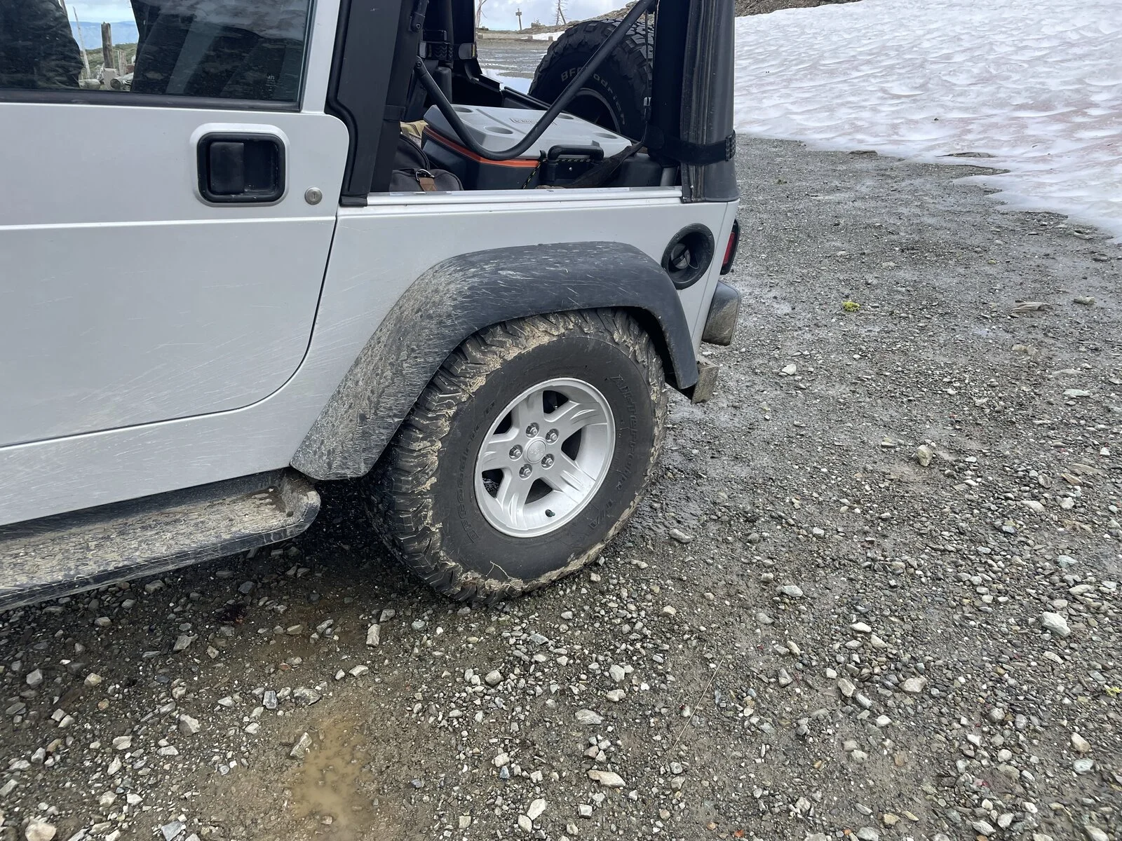

on my 2006 Rubicon I am running 2.5 Old Man Emu springs, with extended bump stops and adjusted steering stops and do jot have any rubbing with 285/75/16 BFG A/T on the stock rims.

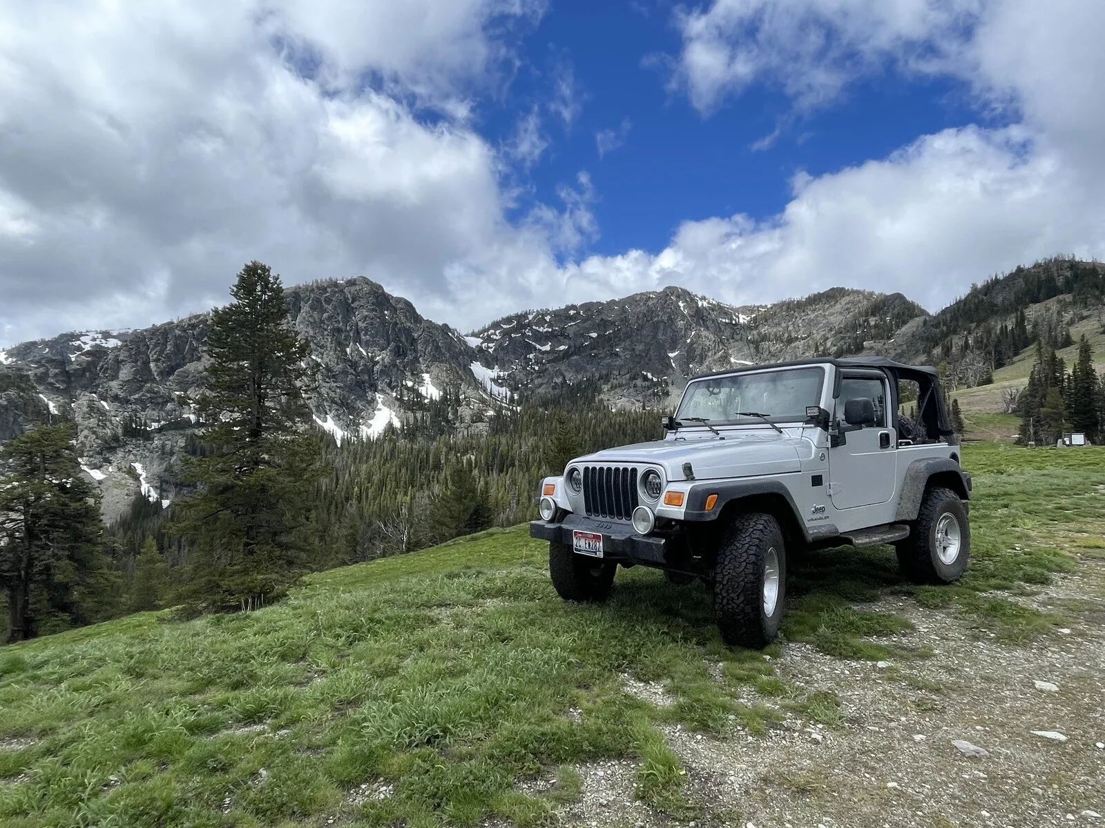

You could try to drive it with 33s and no lift. I made it home on a 2 hour drive from D.C. after buying this. I was lucky. 😬

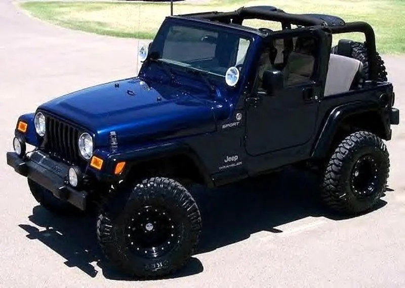

I'd go with 4" total lift for 33s though. Zone Offroad 4.25" combo lift with 33s below.
