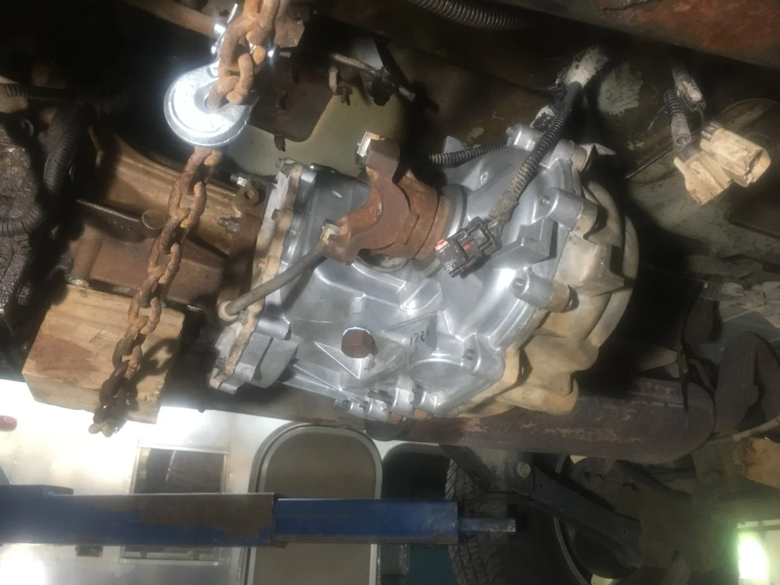

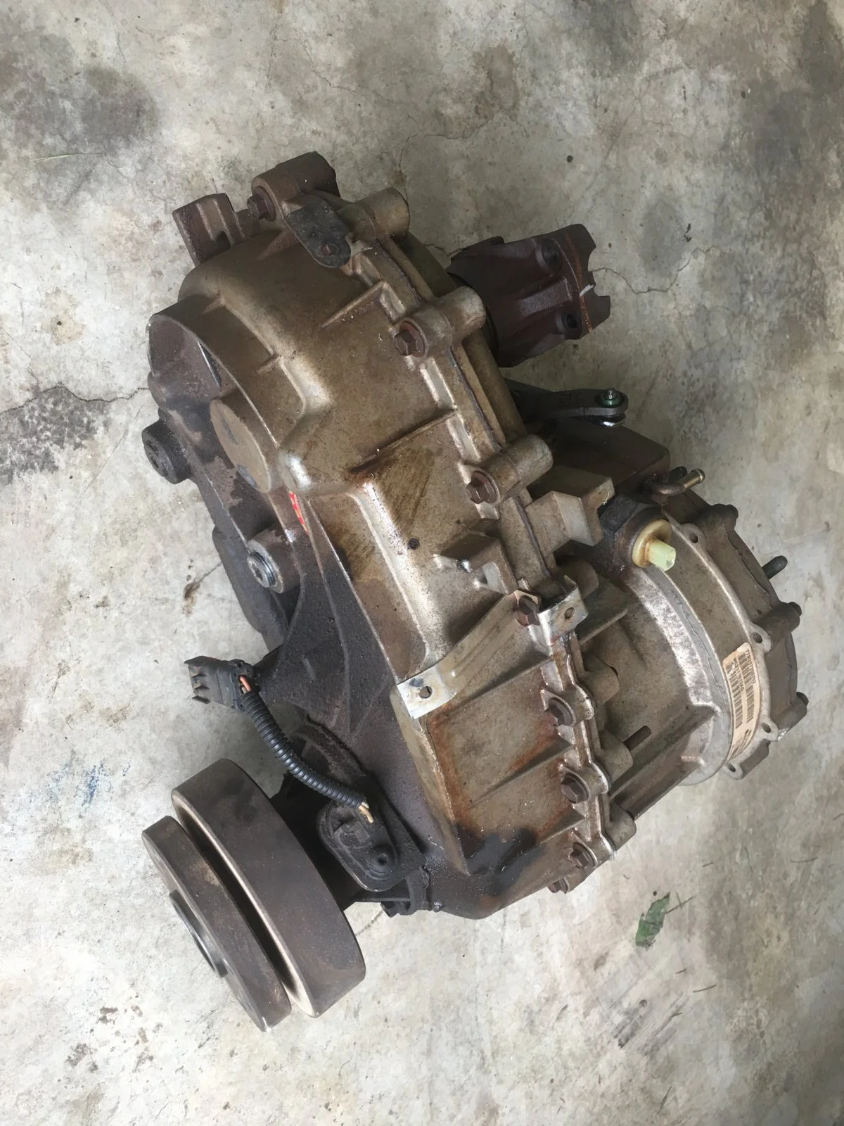

Rubicon 241 transfer case housing split / cracked
Got my T-Case out today & Jerry and MrBlaine were spot on. Both halves were cracked & front double Cardin front ujoint was toast—although not frozen.
Took it in to C&M Gear, Springfield, MO and they recognized the T-Case immediately. Found a front case in California. Shop guy said the rear case is crossover with a Dodge 241 or 243.
What other upgrades should I request with this rebuild?
Thanks again!

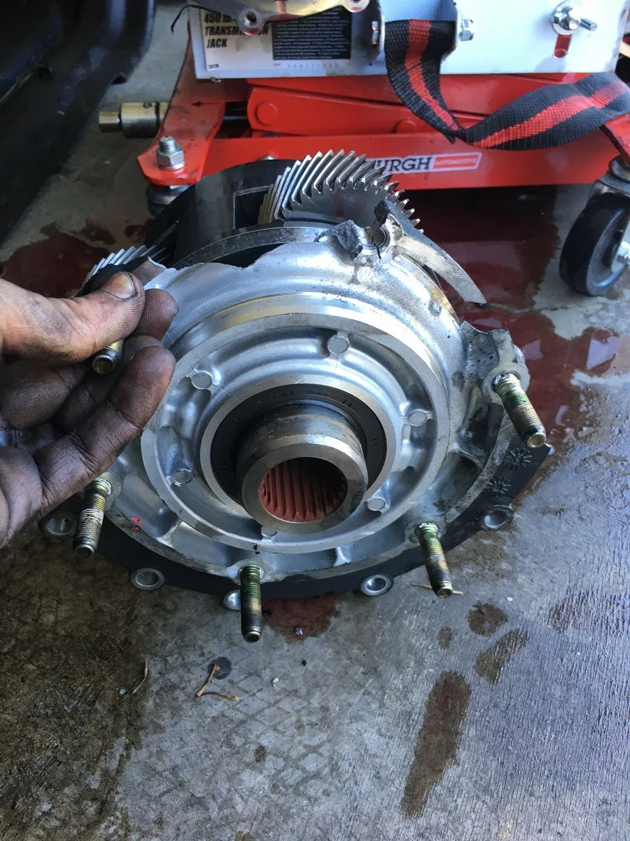

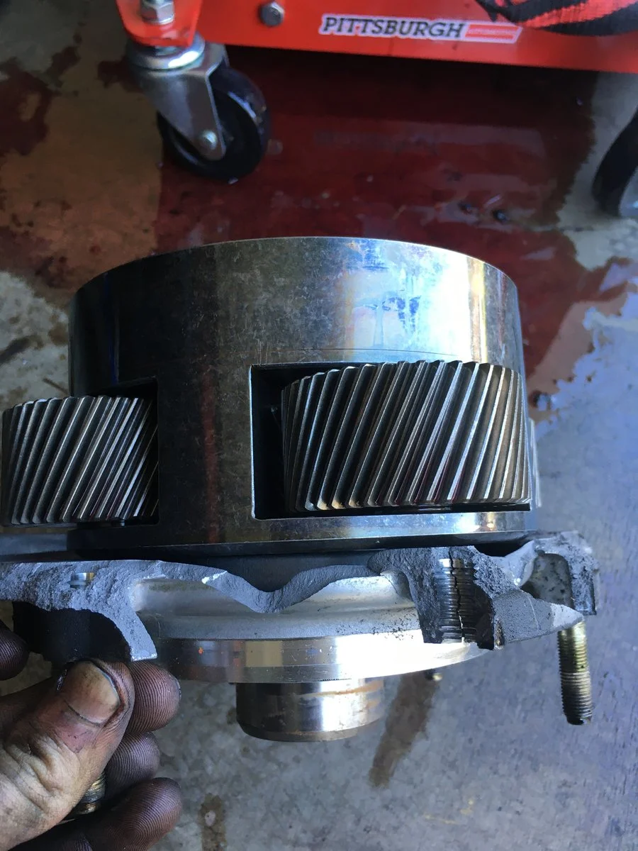

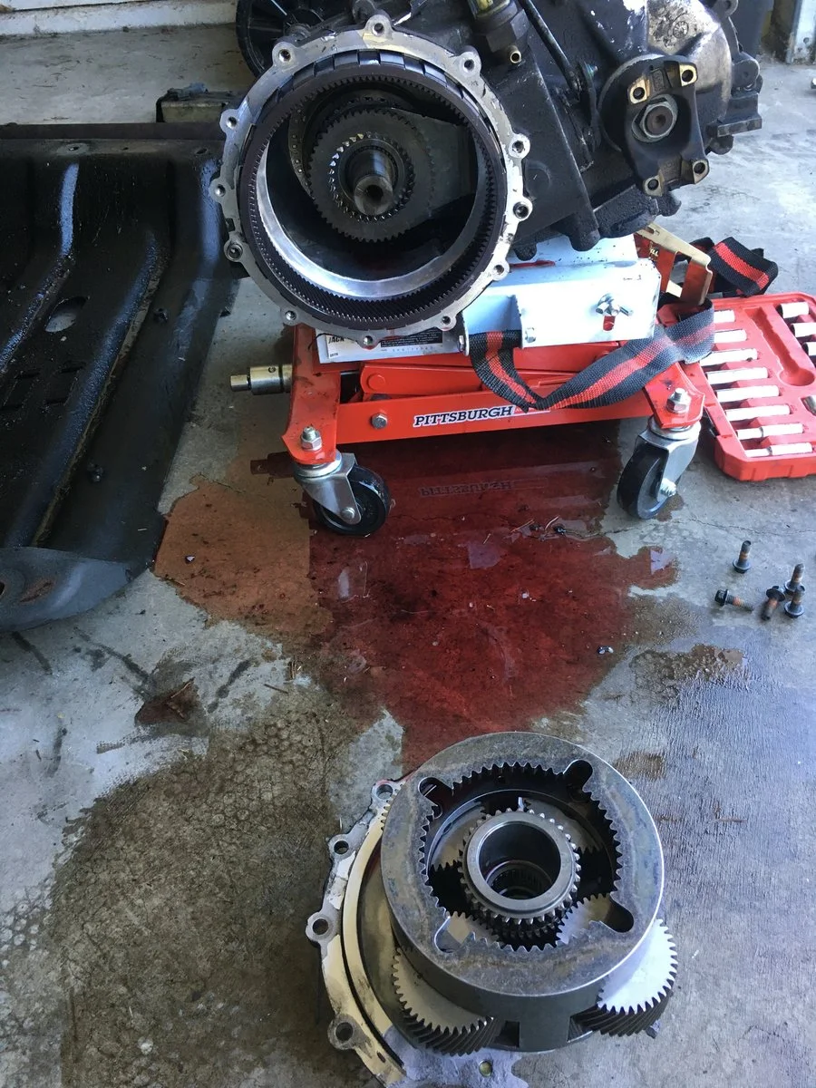

Hi guys, sorry to revive an old thread but I have the same issue (see pictures). Actually it might not be that entire front piece....? I was curious, were there gaskets on either end of that piece? Or just those seals you mentioned
I have the NP241OR mated to an NSG370 6 speed FYI
