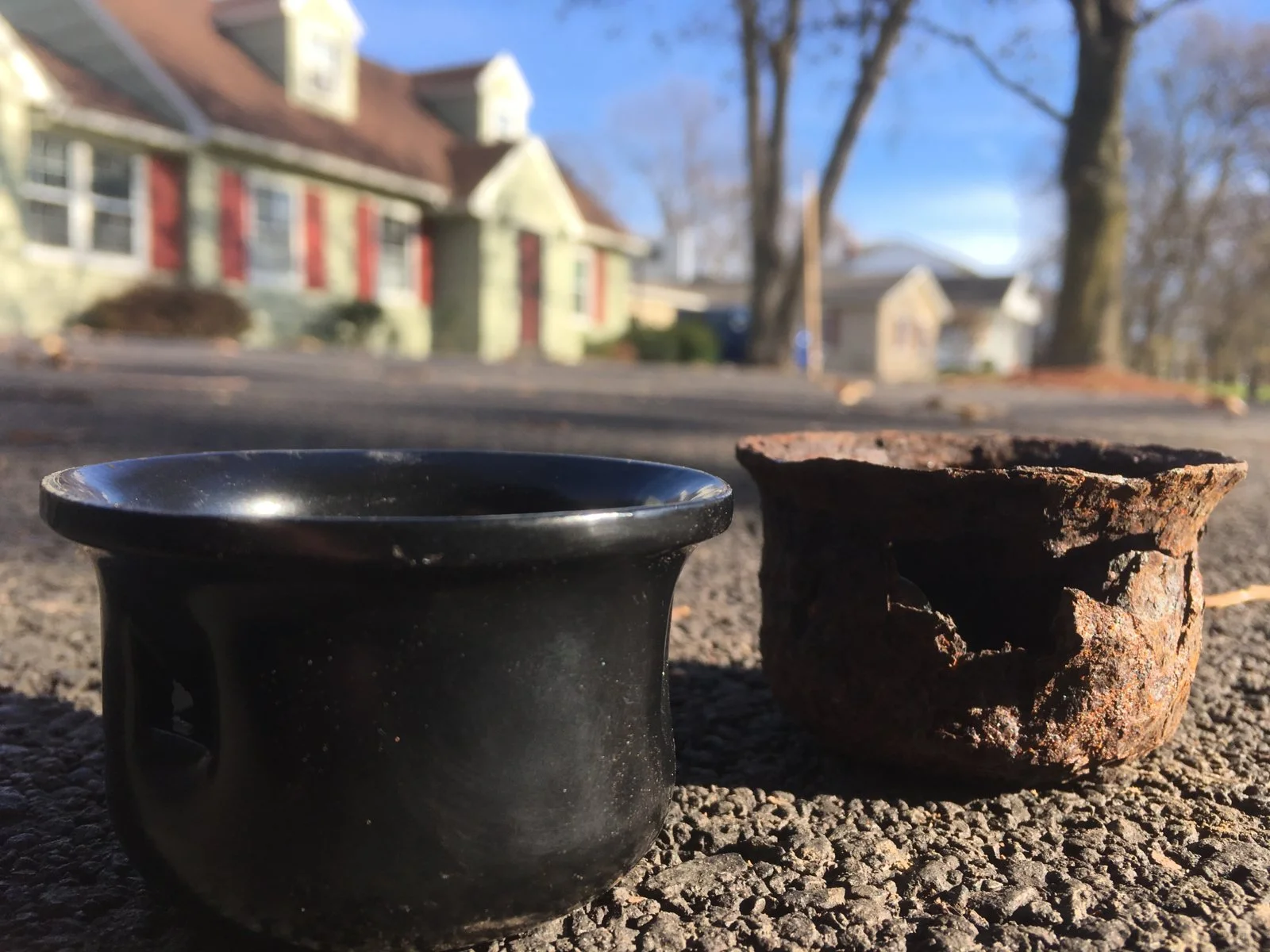

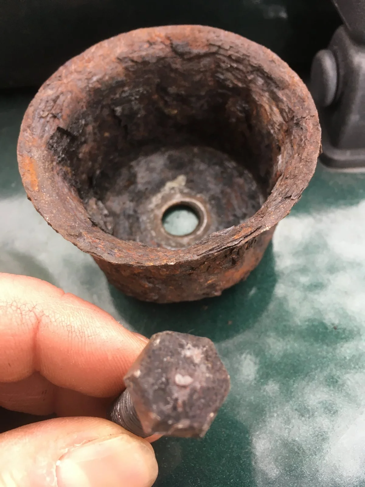

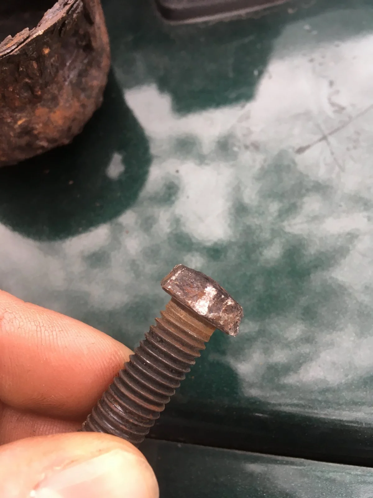

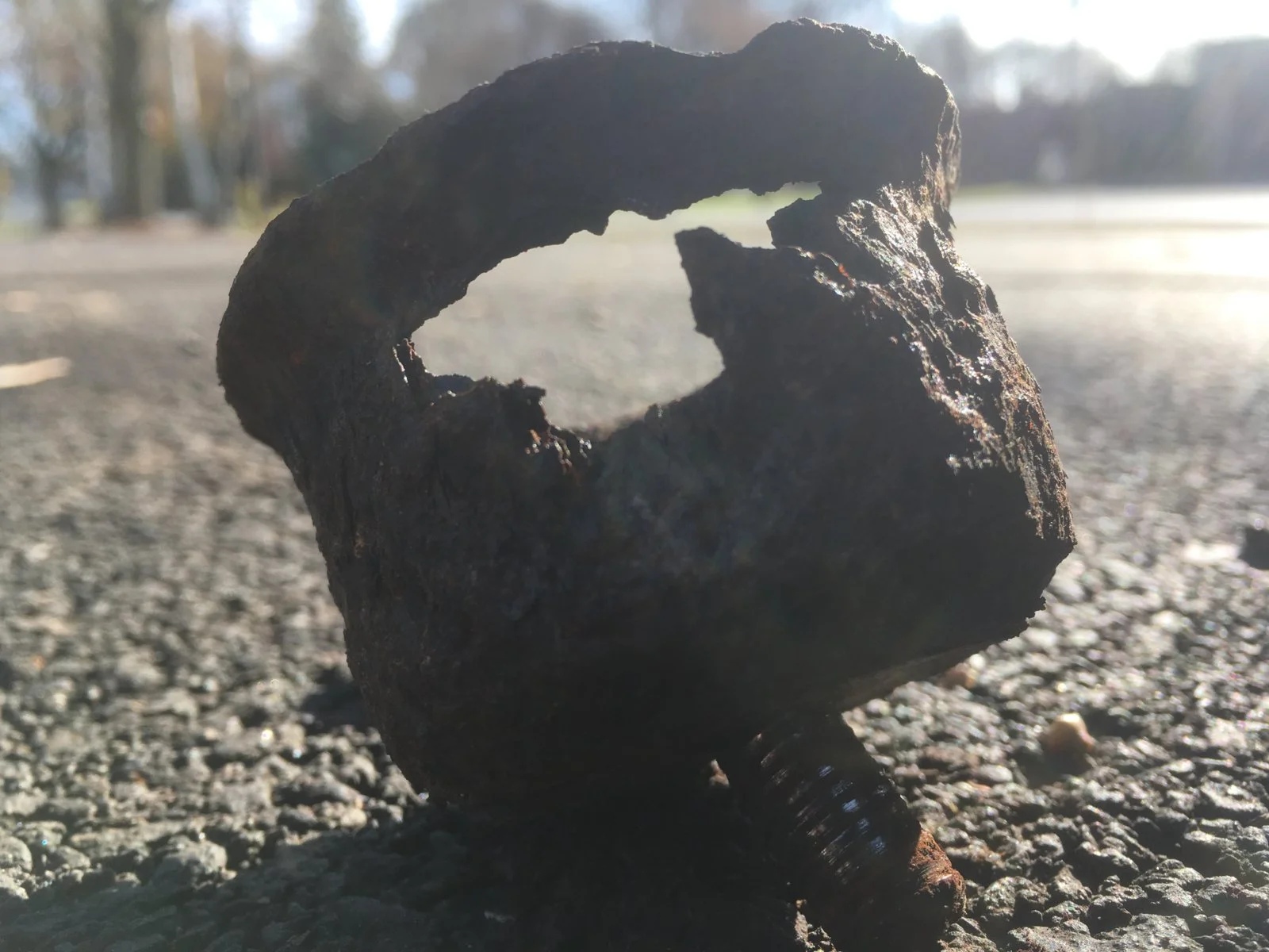

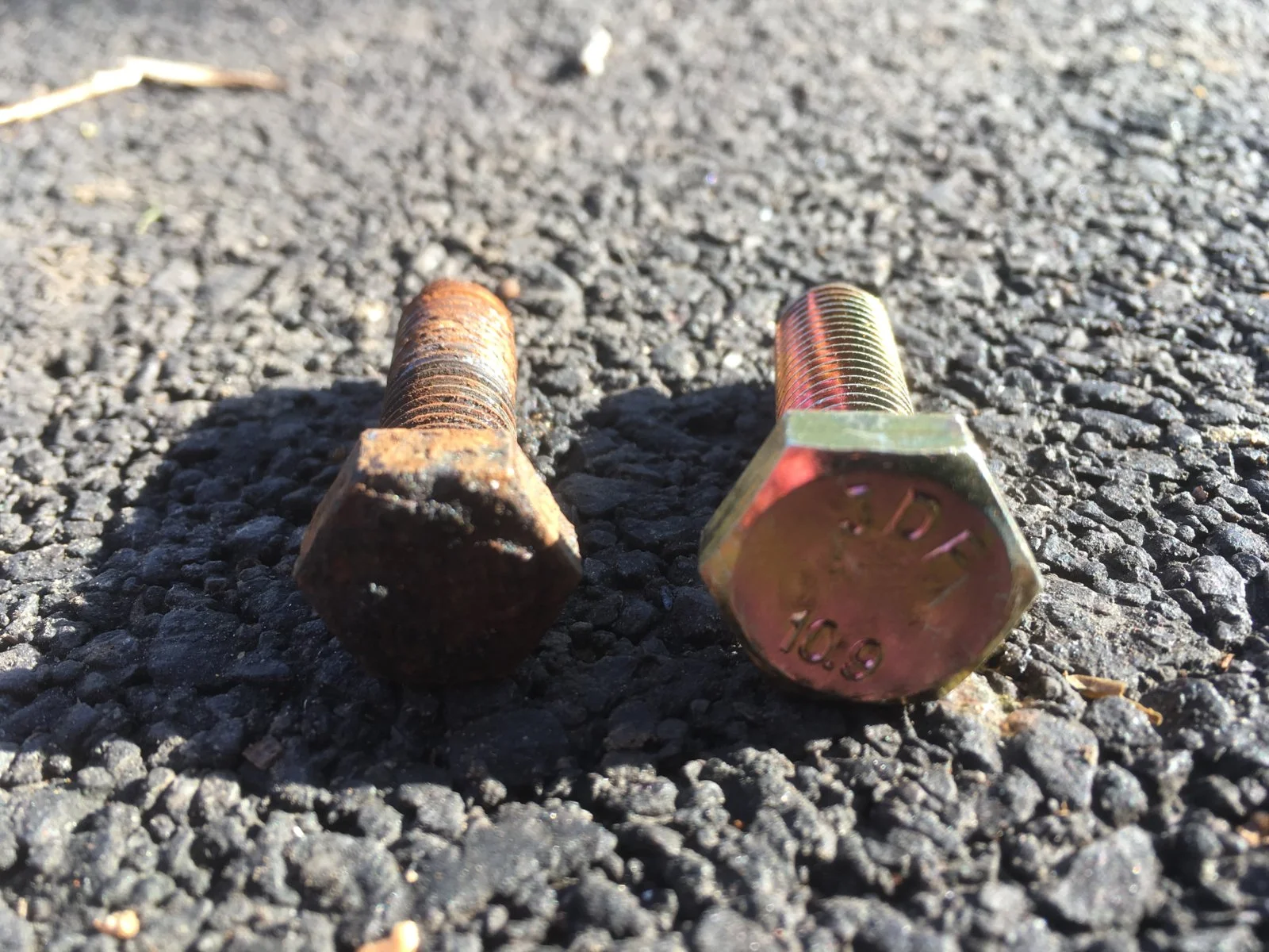

I figure I'll add to this for the sake of anyone else trying to get these things off if they look as bad as mine did.
It is a 15mm under normal circumstances but if they are severely corroded you may have better luck with a 9/16th socket. Mine were so bad in the rear they had a tapered effect (see pics), and were a total pita to get a grip on. I scraped out the inside of the jounce cup with a hook tool, torched the inside for like 30 seconds, then pounded on the 9/16 socket...all that with the added drowning of penetrating oil from the top did the trick. Piece of cake right?

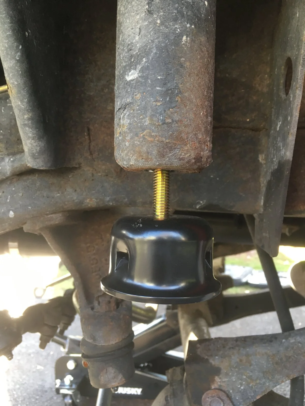

The front ones on the other hand took the 15mm and unscrewed 75% of the way out then wouldn't go any further, they just spinned endlessly. They required some downward force while unbolting due to thread corrosion as there were a few threads left at the end that needed to catch. That actually stripped out my threads on the cup mount so upon reinstall I had to add a nut onto the top side as an anchor. Worked out good in the end.

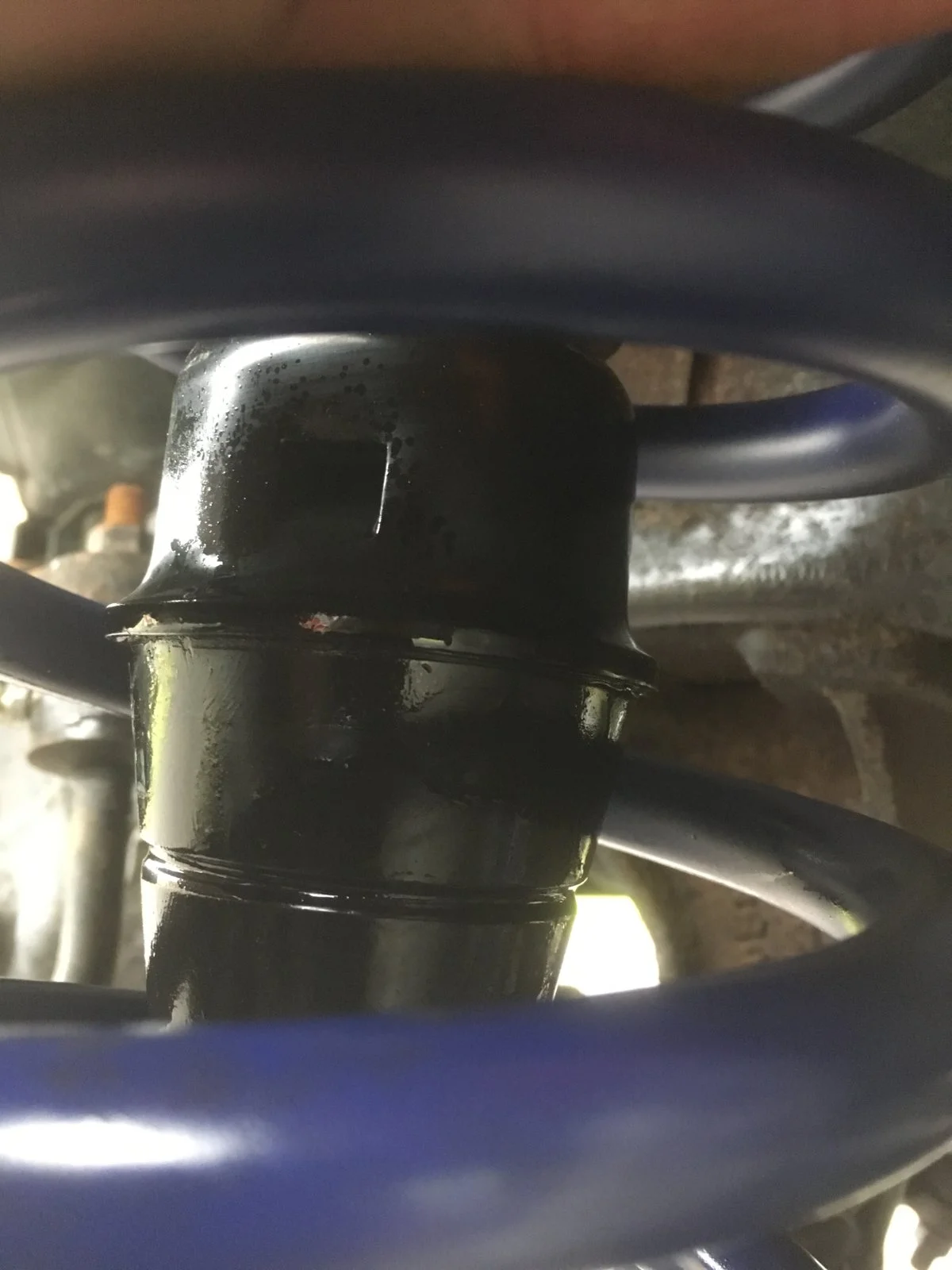

I also used the Energy Suspension bump stops and they are nice!
