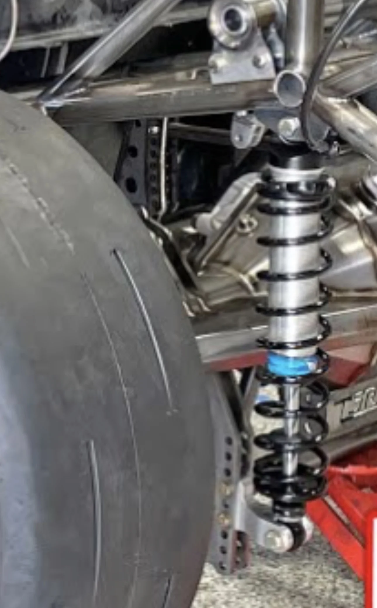

Seeing your Cleetus references means you must follow them. If you’re serious about the drag stip then wouldn’t you want positional adjustability at both ends of the control arms?
Reactions: D's Jeep Wrld
Good catch😁 And yes I've been watching Good Ole Cleet since I was a kid (21 now) Back when he was with 1320,particularly seeing him drive that 1000hp Williys jeep 😆
And no I'm not serious about drag racing this lol,But I will take it to the strip for shits&gigs.
I'm building this Jeep for it to continue to be the Daily I've always taken to work but will be used for crawling.....And built to accommodate me Ripping through backroads,drifting,doing donuts,Overall spirited driving activities 😁
I like to have fun🙂
