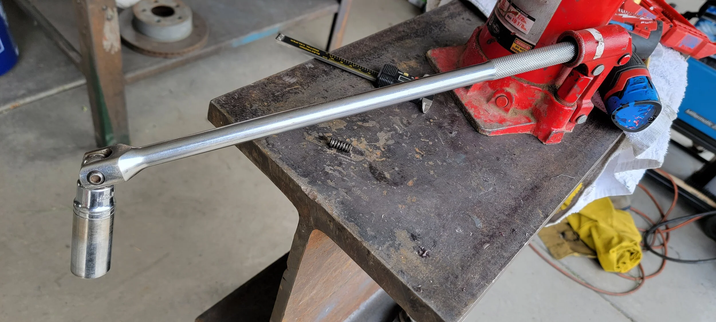

Clever! I use a 4 way for lugs. If I can get my dad converted to 19mm lug nuts, then this would work great.
The couple sockets you need and a breaker bar occupies less space than a 4 way. 😉

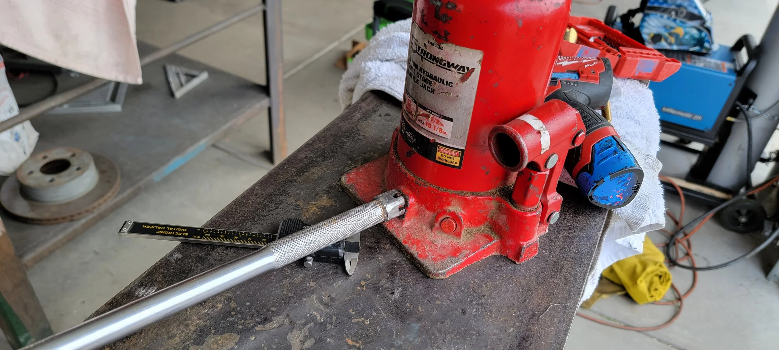

Do you guys think a 3/8 breaker bar would be strong enough?
I've snapped one before, but it was HF..

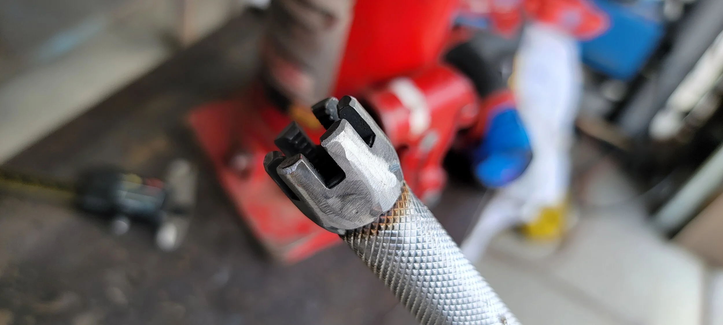

Buy a couple of these in the correct size. We've found that the jam nuts vary from standard by a small bit so we take a hard disc and very carefully open them up to fit well.
https://www.lowes.com/pd/TEKTON-1-7-16-in-Sae-Angle-Open-End-Wrench/5014302841
Cut them in half and deburr. Then make a cheater handle out of some tube. Flatten the end of the tube slightly until it slips over the wrench shank. That gives you a short handle wrench to manipulate the jam nuts until they start needing more force and you don't need to swing a long handle around. When they start getting tight, slip the handle on and get after it. Also much easier to line the wrench up on the flats and then stick the handle on.
I give mine everything I've got on a 24" breaker bar. I'm not sure a 3/8" would stand up to that, but it'll probably be ok with whatever length it comes in as long as you don't put a cheater pipe on it.
