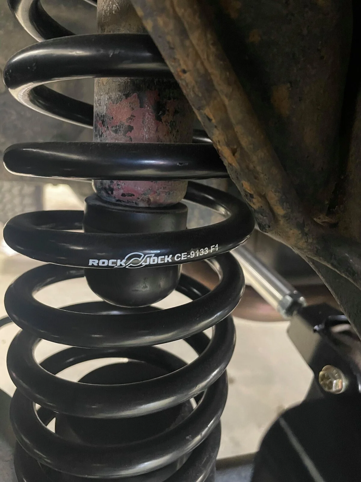

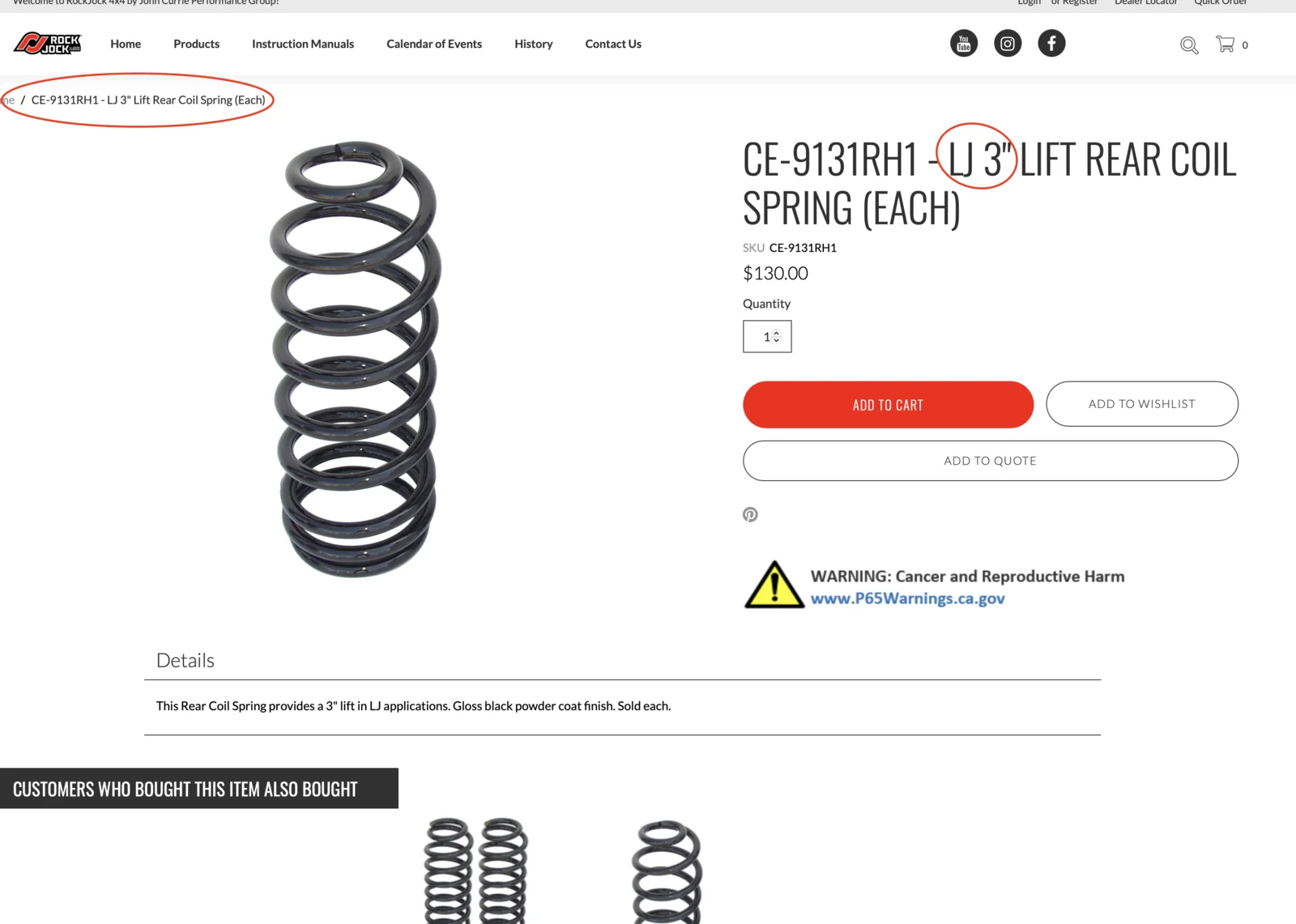

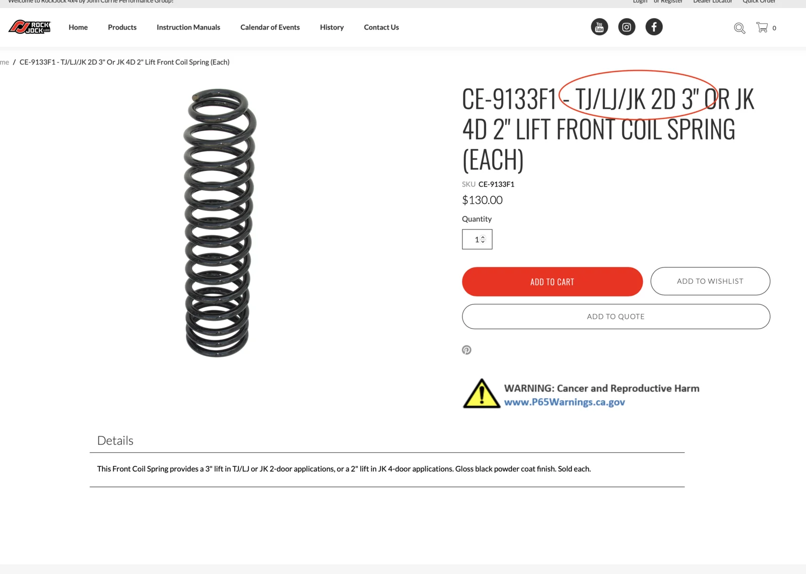

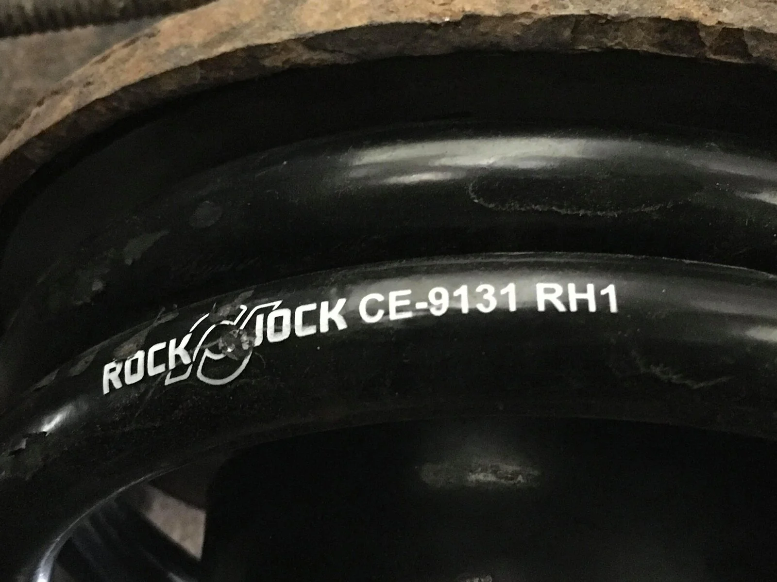

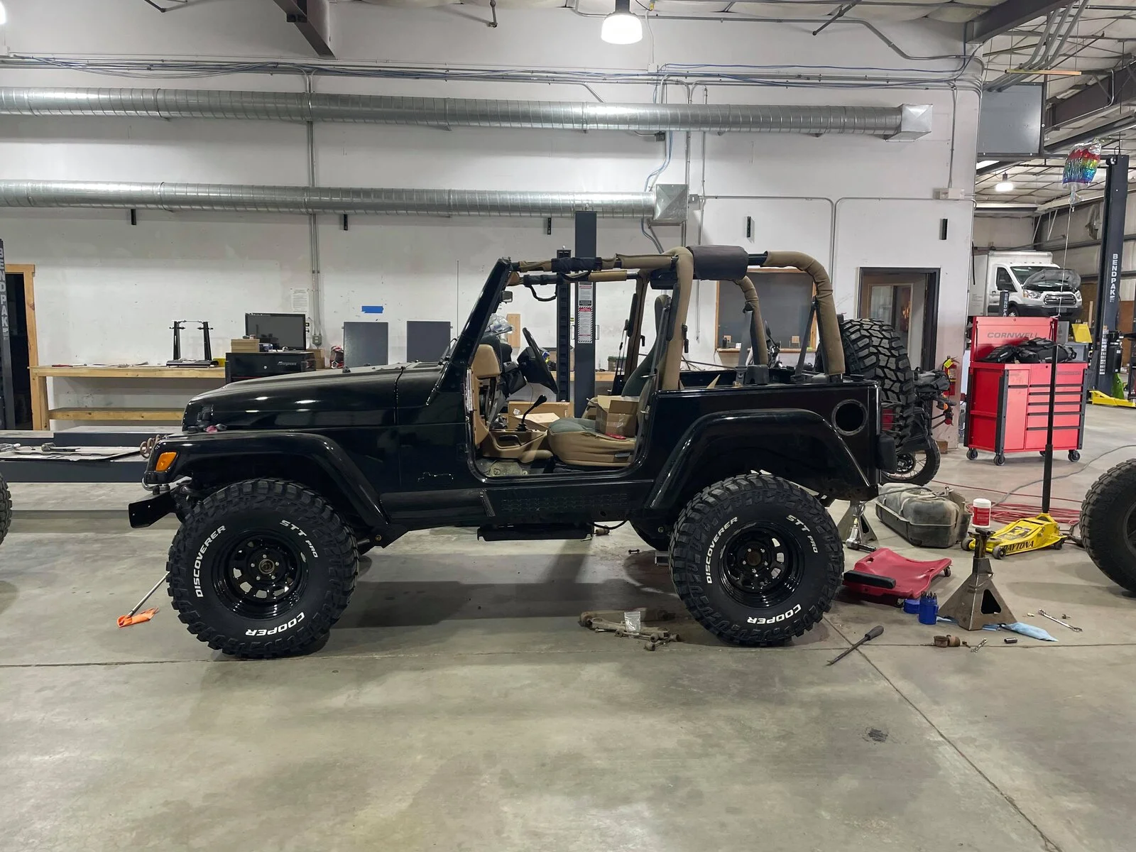

The front springs installed perfectly and look correct; however, when we installed the rear springs, the Jeep sits way too high. With that said, the fuel tank and rear seats are removed... but I weigh 260ish pounds (last time I was on a scale). With me standing in the back, it still sits too high. So we started searching part numbers to be sure we received the correct springs.
Part numbers shipped to me
Rear: CE 9131 RH1(3" LJ rear springs)
Front: CE 9133 F1 (3" TJ front springs)

They then asked if the gas tank that is sitting on the floor in the photo of the jeep was the tank for the jeep, which is when I explained to them that even with 270lbs directly over the axle, it still sits too high. This was the last communication from them, on 17 Sept. Request for updated information sent to the same message chain have been seen, but ignored, despite sending screenshots of the currie/rockjock website with part numbers.

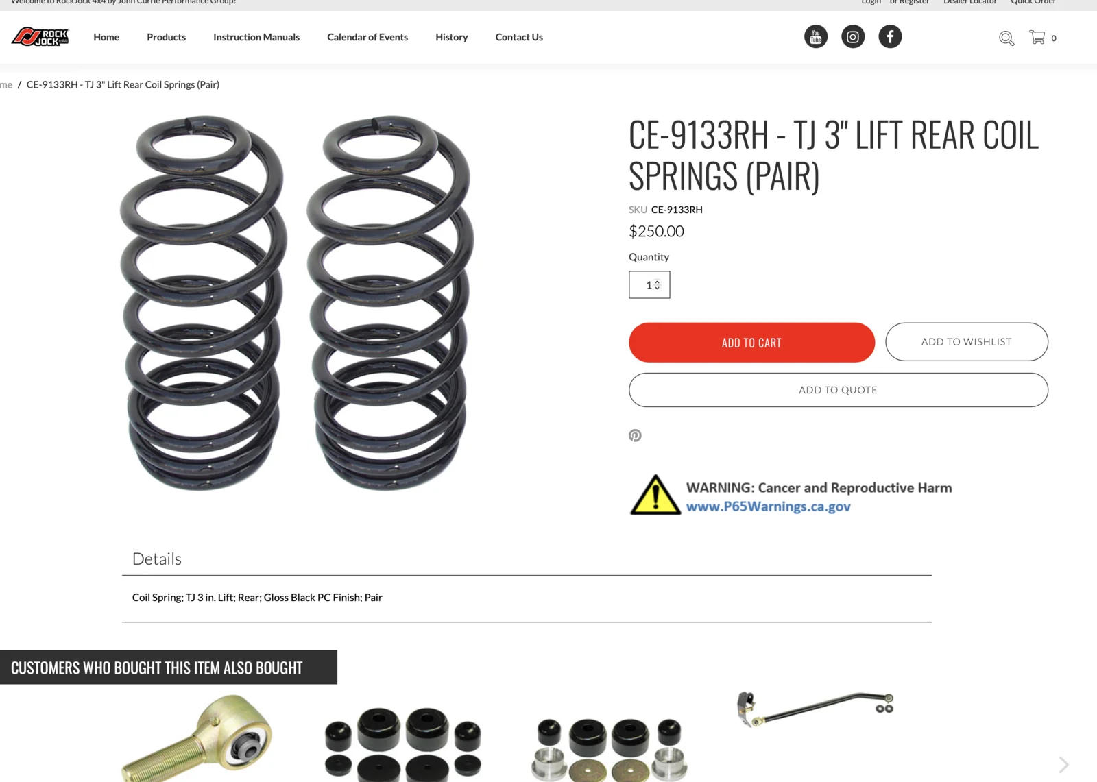

On Friday 9/24, I called currie/rockjock to make sure that I was in fact correct and that I was ordering the correct replacement parts. I then informed savvy that I would be ordering the correct part number directly from currie/rockjock and that I would COD the originals back to them in the amount of $250 (which is the amount spent on the replacement springs)+shipping for the parts I ordered and the shipment back to Savvy. Still... No response.

I've played that "stand in the back to mimic loads" bullshit too many times. Don't even bother trying to figure out where ride height is until you have it how it is going to be when you drive it.
Might be fine after the weight of fuel, tools, hard top, doors, you in the seat, maybe a passenger plus settling?

I appreciate where you're coming from, but you have failed, yet again, to actually address the issue that I was sent incorrect parts by your company. I called and verified with currie which springs are the correct ones for a TJ. Searching YOUR website for the part number I received brings up the part number I SHOULD have received, not the part I actually searched. You sent me the wrong parts, is all I see. All I want is for your company to make it right, and nobody will actually have that conversation. As I said in my Facebook messages to your company, if its right and you can show me its right, then it's right and I'll move forward and see where it settles when everything is complete. But just telling me to shut up and color isn't going to do it. I am not going to continue to spend money when everything I can find indicates that I was sent the wrong parts.
And as for another comment above, the jeep isn't getting doors, a hard top, or a rear seat.
