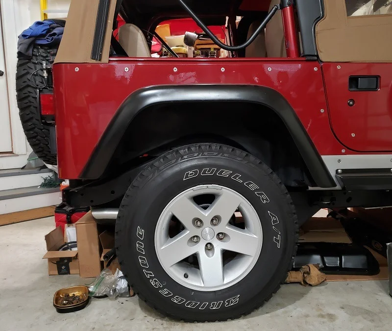

Hi all,
My shop sent me a photo today asking what I would like to do about the interference between my Savvy Rock Sliders and my stock rear fender flares. The problem I'm running into is that the Savvy Sliders don't allow the rear fenders to sit flush against the body. I'd imagine that this gap would quickly fill with mud and rocks, eventually leading to problems. Does anyone have a solution to this problem? It seems like most people running Savvy sliders tend to run without rear flares but I'm not entirely sure I want to do that.
Is there a solution to this short of cutting the flares or the sliders?
Thanks!
Corner guards set the flare back onto the same level.
Or you can trim 1/4" off behind that section of flare to account for the offset.

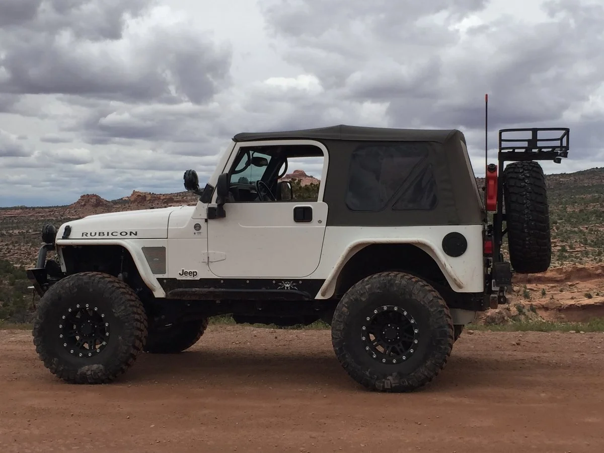

Didn't read the entire thread again (just skimmed it briefly), but I'm pretty sure that Jeep doesn't have corner armor (at least I didn't see it). I think he might have just left the gap between the flare and the body.
No corner armor. But the flare is trimmed to fit the slider. The other very nice detail is that the slider backer is matched to the body color.

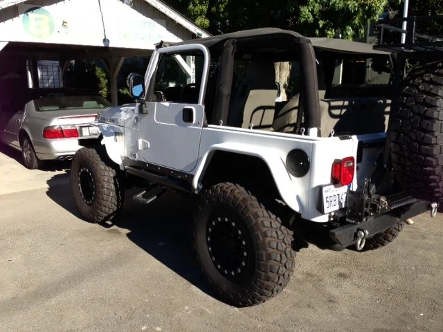

Why wouldn't painted armor look good? I went this route with Savvy armor and sliders. It looked fantastic when done and most people didn't even notice it.

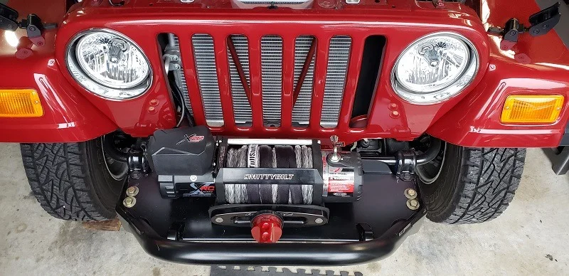

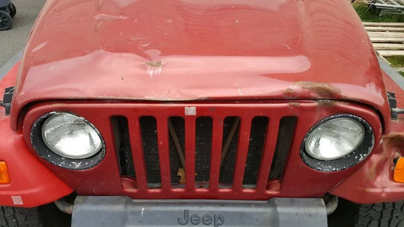

:LOL: Mine had 200+ k on it when I started and was worse. It was a forcing function to just repair/repaint everything. That said, I get what you're saying. It's not a trivial job and can be expensive. Especially, if you have to pay to have it painted. To give you a little idea of what I started with, here's a little before and after of the nose:
That is a hell of a transformation
