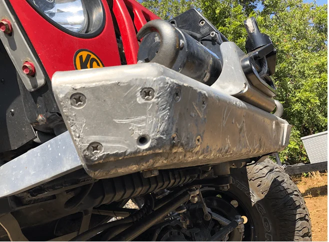

They are terribly bent and ruined. They have performed exactly as we predicted. They should not be run where it matters without a steel skin or slider of some sort.

They were fresh when you saw them. They have been over a few trails since then.
In perspective, this is the current state of his front bumper.
