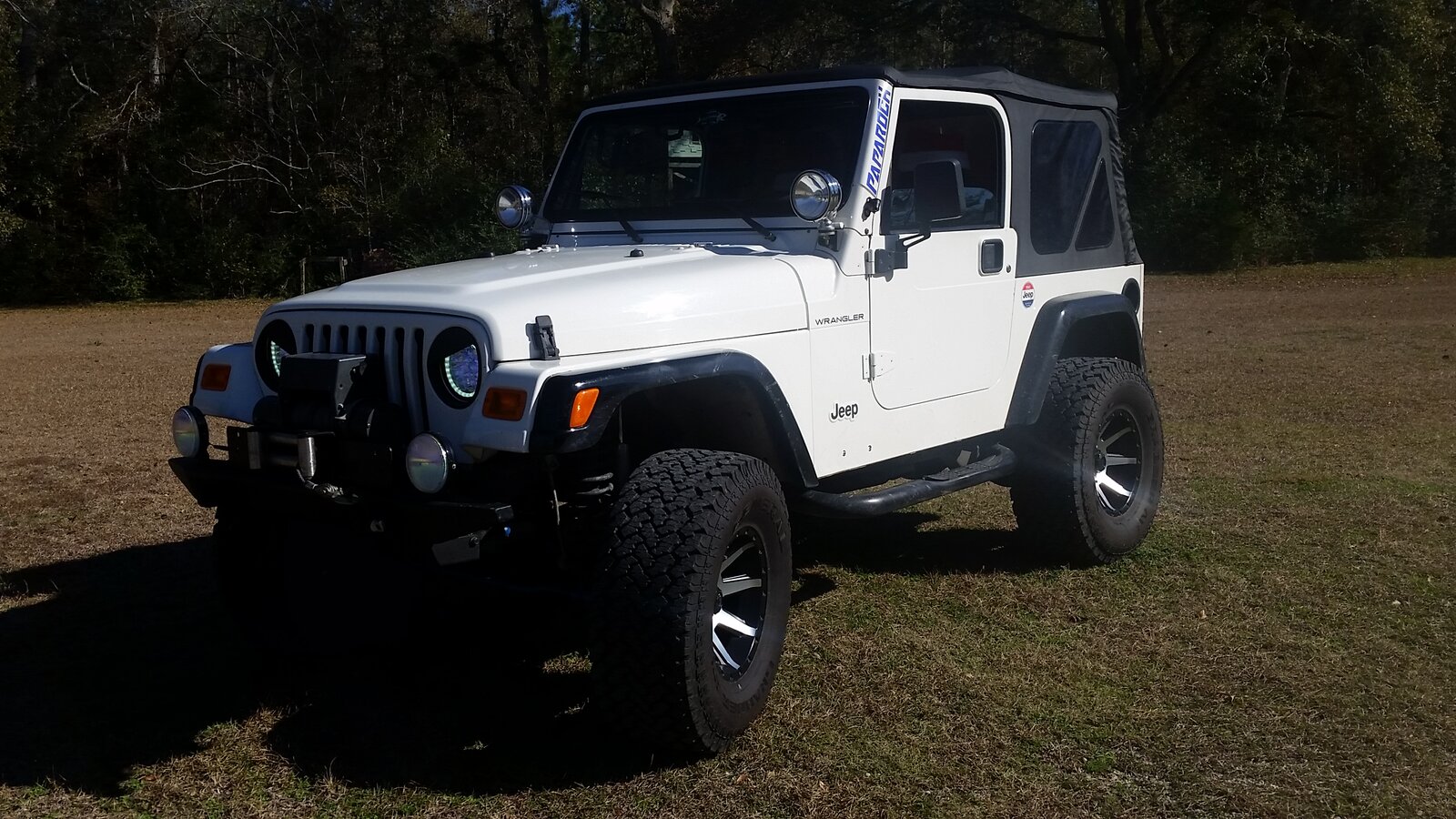

I bought Scrat 4
years ago, 2.5L, AX5. One year later AX5 was toast; without me ever taking it off road. I didnt have the funds at the time so I went with a remanufactured AX5. well 3 years later and 2nd gear snychro is toast and I have been easy on this transmission. I quick shifted it the other day 1 time while crossing a busy intersection and that was all that it took 😠!
After much research and actually searching I bought a 1998 Jeep Cherokee Limited 5.9L, 46re, 242J. 🤩

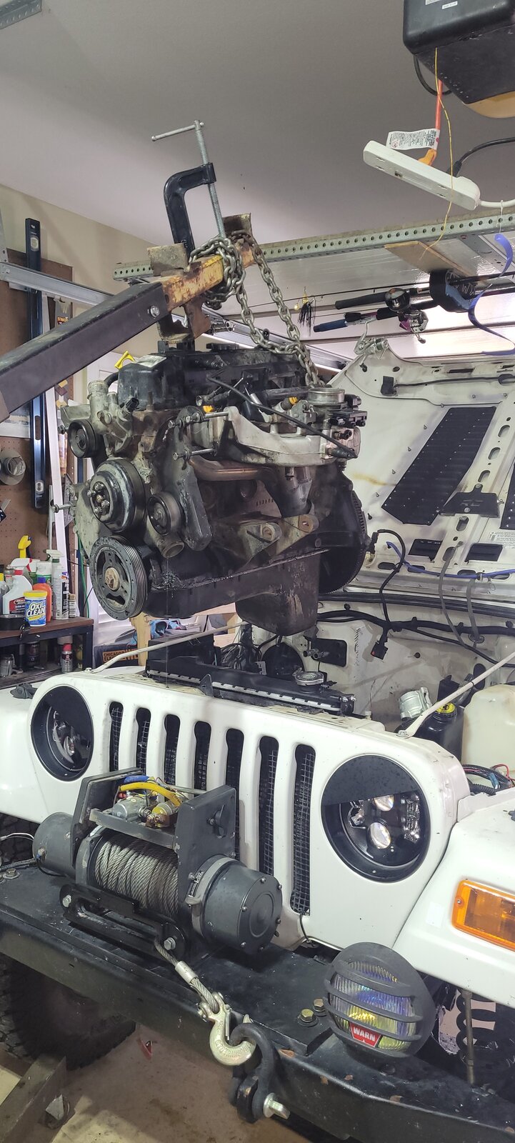

Today It has begun!!!
Let the shinanigans begin!

OK not fair... We need MORE info.

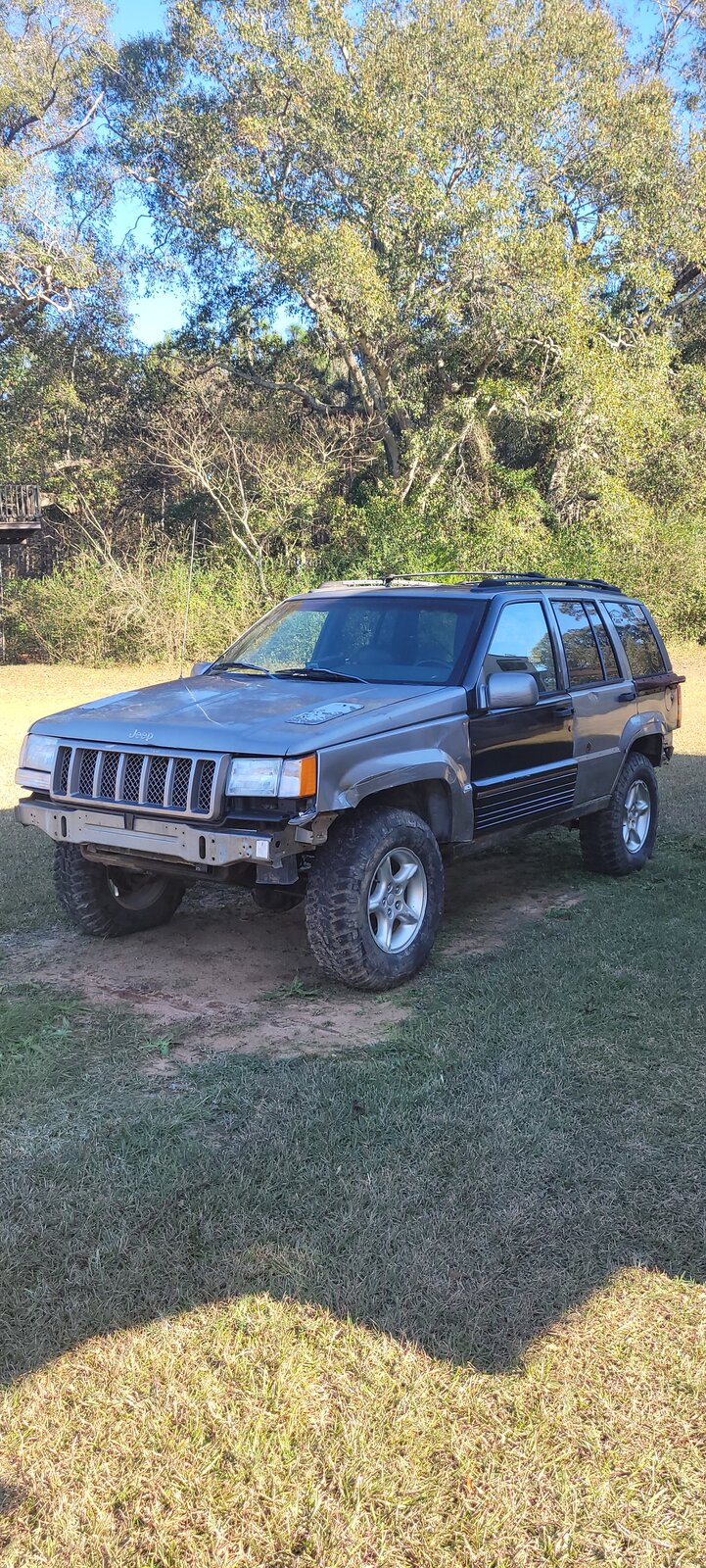

Great find and good choice for the donor engine/transmission. That Grand Cherokee looks to be in pretty rough shape. Normally I'd complain about you cutting up such a rare rig but I think that GC was on it's last leg.
Did you do anything to the engine or transmission? Or just taking it out and swapping it in? Are you going to keep the 242 or go with a 231?
Reactions: DougyintheBushies
I was in a hurry to post before I had to leave for work.
The limited was a trail truck and the guy is now getting into motorcycles so he was selling it. It runs pretty good. needs basic tuneup and I think I will do the plenum but not much else initially. It started right up for me after sitting in my yard for three weeks.
I want to use the 242 but I really havent decided yet. The 46 re that is in the jeep currently only drives in reverse and when you shift into low gear. It came with another tranmission that the guy said he pulled it out of a running Cherokee. so my first priority is ensuring a good 46re.
