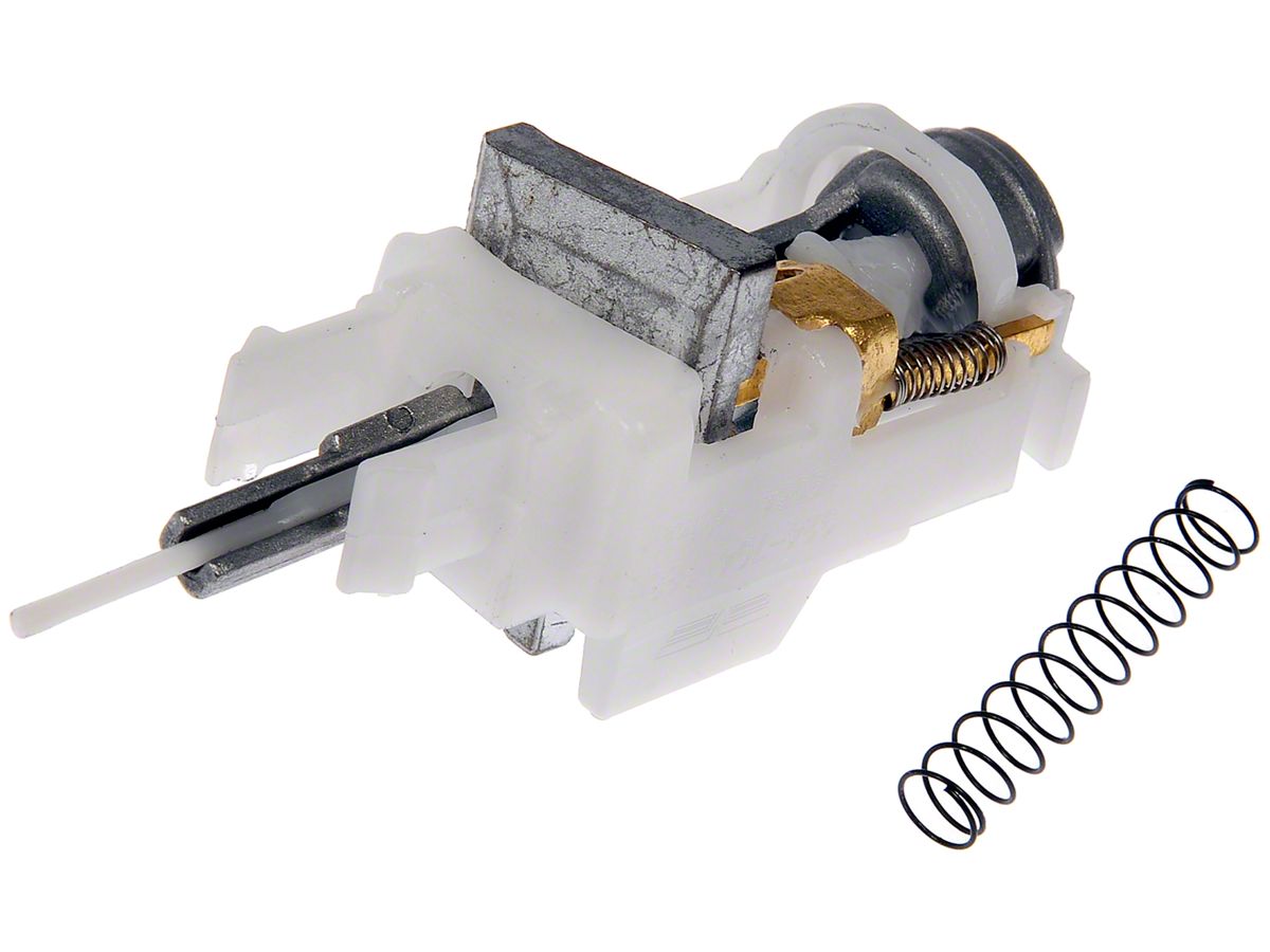

So, the seat belt warning does chime? Hmm. Mine won't chime anymore, and I don't know why. It doesn't stay on either, if I don't engage my seat belt. I replaced the seat belt switch with a new one. Tomorrow, I plan to buy a new Mopar ignition switch, because that is supposed to solve the Key-in chime not working when the door is open. I recently locked my keys in my car because of this missing function. Maybe that will fix my selt belt warning too. My mechanic said that he will take care of it. I really don't have time to diagnose all these things. Thanks for the information.

If you break the plastic dick on the ignition actuator, the key in chime will not work..
