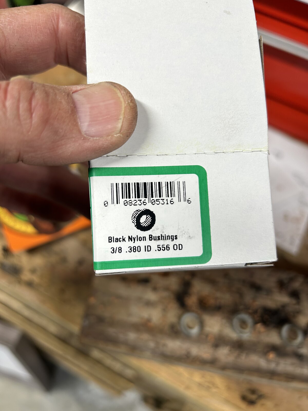

Where did you buy the black ones? Online? If so, could you provide a part number. Dont have an Ace in my town. Thanks EAlright was able to fix this today, you’ll need the shoulder washer with the specifics listed in the pic below. Was able to find them in Black so I didn’t bother shaving it down to the width of the torx bolt. The inside diameter is a bit too small so you’ll need a 27/64 drill bit to get it to the right size. It’s actually 10mm ID, but I couldn’t find a drill bit in that size. Worked great, it’s a perfect fit.
No more noise!
I found them at a local hardware store. If you can locate something with these dimensions you should be good:Where did you buy the black ones? Online? If so, could you provide a part number. Dont have an Ace in my town. Thanks E
