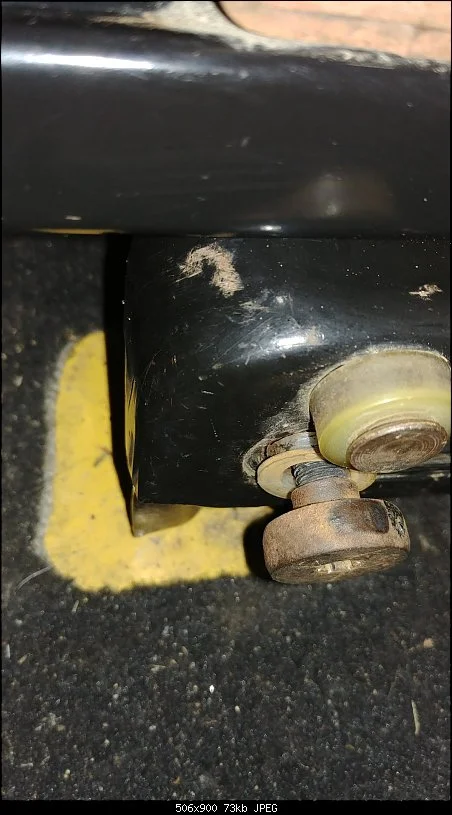

From your picture it looks like I’m missing plastic/poly bushings on both of those metal pieces. Does anyone have a picture of what these are supposed to look like and any idea where I can order them?

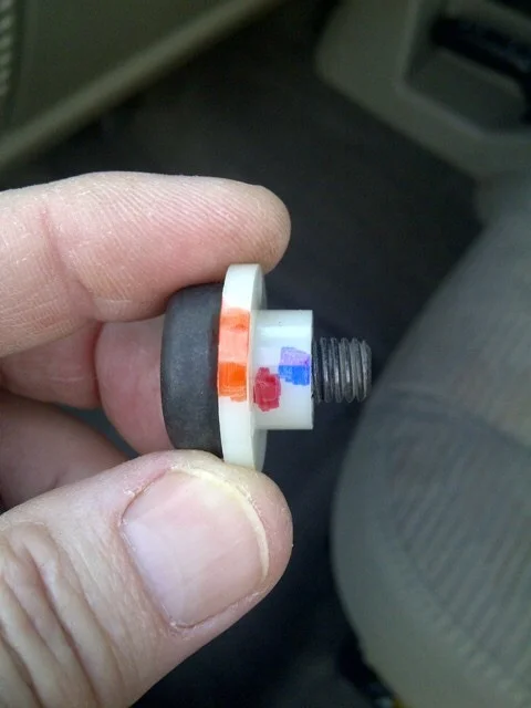

Okay, hopefully the pics will be somewhat self explanatory.

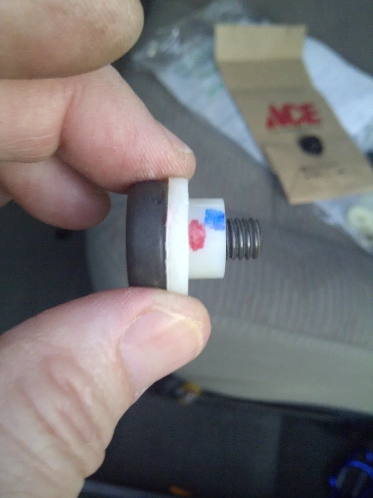

Pic 01 shows the problem nylon bushing that the fold and tumble seat rides on.

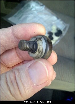

Pic 02 shows the assortment of washers and bushings I bought from Ace Hardware(where I always wind up because Fastenal and Grainger doesn't have it).
Pic 03 shows 3 things: Orange area will need to be ground off until bushing is even with bolt head. Red area shows where seat would ride "if" you grind off the blue area. Blue area is where my seat rides now(once that area gets worn, I will remove bolt and grind it down so seat rides in red area).

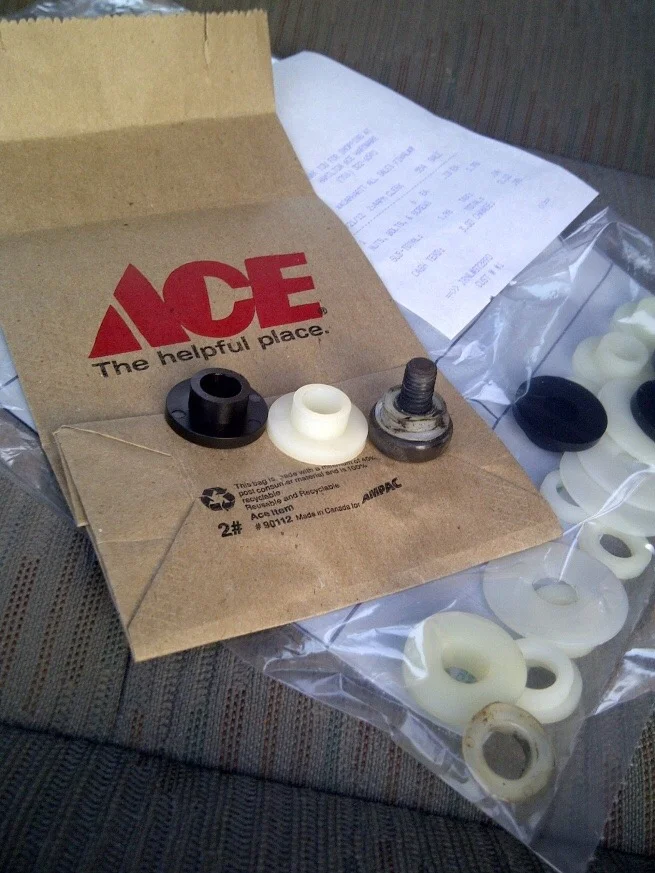

Pic 04 shows the bushing after grinding off orange area so that it is even with bolt head.

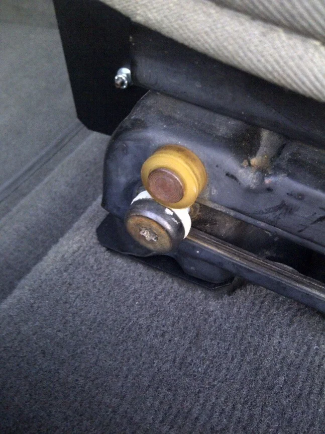

Pic 05 shows the bolt with new bushing installed on seat(tension bushing is now resting on the shoulder of my new bushing rather than bolt head).
It takes less than an hour to replace all 4 bushings, 2 on each seat.

Good question! I don’t have them in either of the two locations in the photo. They are also missing on the seat side nearest the console and same on passenger seat.
I can only assume they wore out and fell off under previous ownership.
I still haven’t figured out what the top one does. The bottom one makes sense.

Alright was able to fix this today, you’ll need the shoulder washer with the specifics listed in the pic below. Was able to find them in Black so I didn’t bother shaving it down to the width of the torx bolt. The inside diameter is a bit too small so you’ll need a 27/64 drill bit to get it to the right size. It’s actually 10mm ID, but I couldn’t find a drill bit in that size. Worked great, it’s a perfect fit.
No more noise!

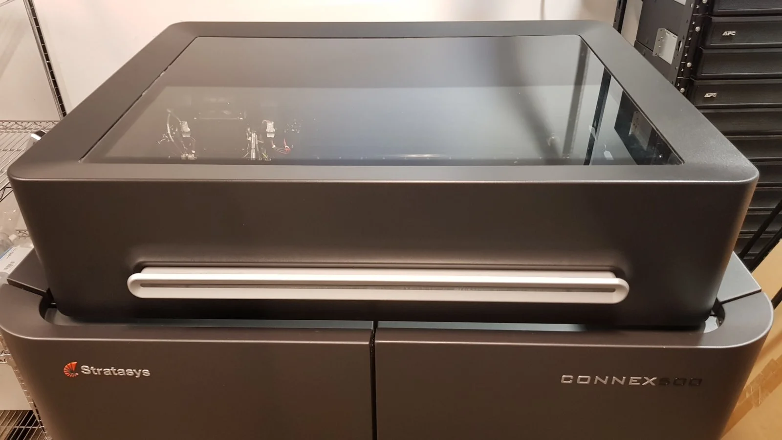

OMG, those are 3D printed parts. In the best case scenario they are printed from ABS plastic instead of the usual PLA. In the case of the ABS, they will last a bit longer not but long at all. Even the high end printers I have at work ($800K) do not print material strong enough to hold up long in places where they rub or get bumped. It looks like those were printed using the home built, garden variety printer "fused deposition, as in extruded layered plastic". That printer is not even that well adjusted. The parts manufactured that way are even weaker, break apart into layers and in case of PLA: biodegrade and deform under sunlight. Nylon is not going to do much better either, I would stay away from those.
Look at the printer I use and the quality of the print I am talking about, still no good!
