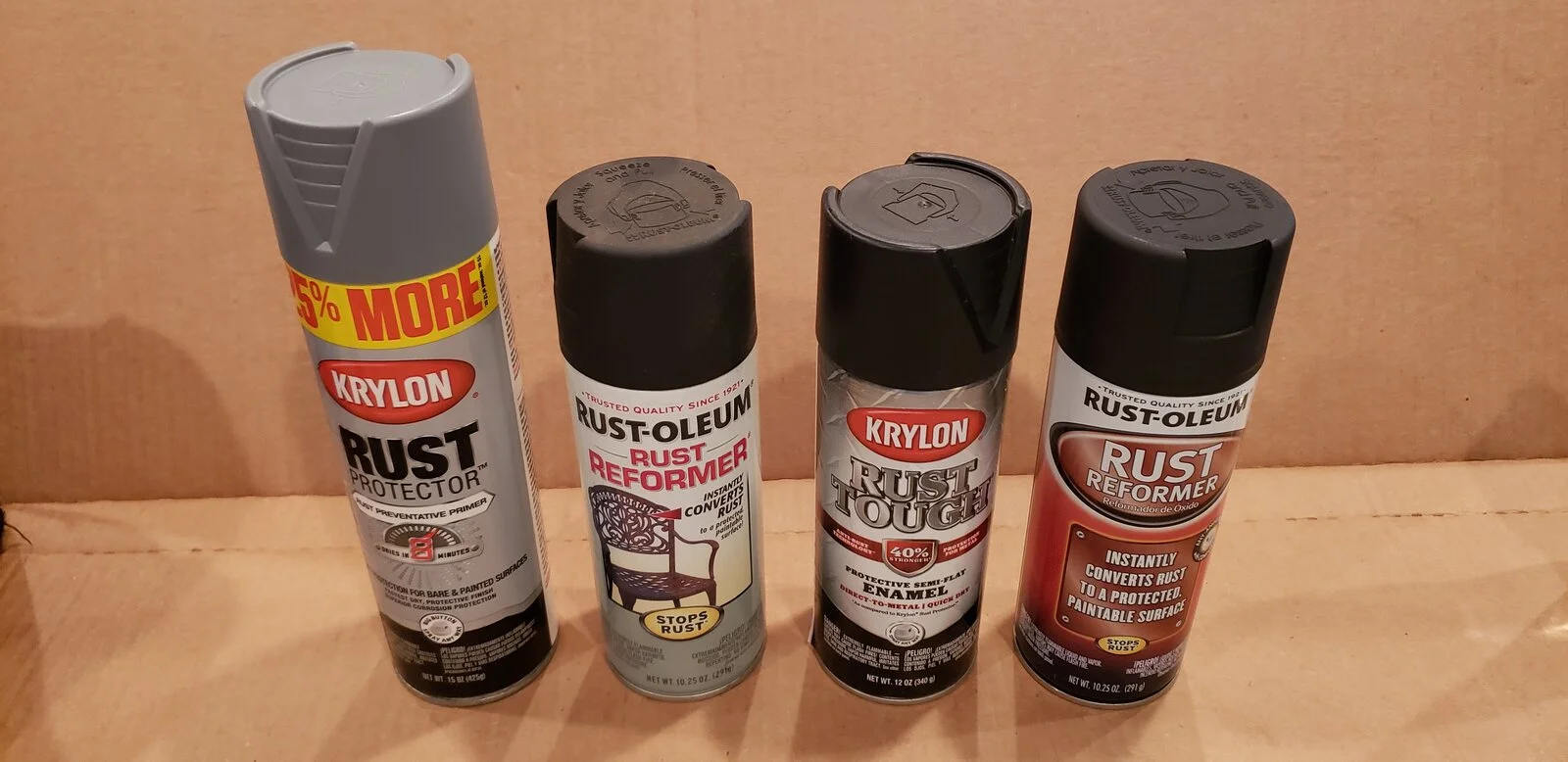

FWIW, this is an area I've acquired some expertise in over the years. Self etching primer should only be used on new or cleaned up metal. If you have rust, clean it up with a wire wheel kit and drill, or a 120 grit flap disc for heavy scale. I scuff up the frame with a 220 or higher sandpaper, clean it with lacquer thinner, spray rust reformer over any rust, then top coat it. Below are the products I use and results I get every time.
Also, as @someguysjeep said, you need to stay on top of this with an annual re-treat, and never use bedliner or other products like that. You're just asking for trouble later.
View attachment 273800View attachment 273801

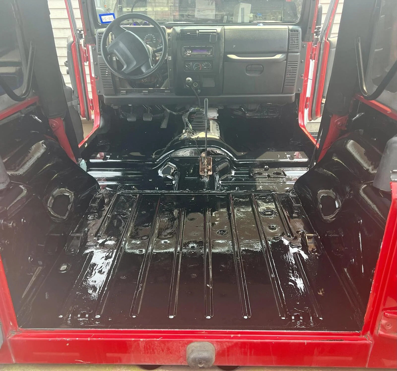

I would use Rustoleum Professional oil based paint (not spray can) afterwards to cover it all AFTER proper mitigation. Plus like someone else said Fluid Film annually
I used Rustoleum pro in a gallon to do my floorpan before sound deadener applied. Would prefer a satin finish for undercarriage

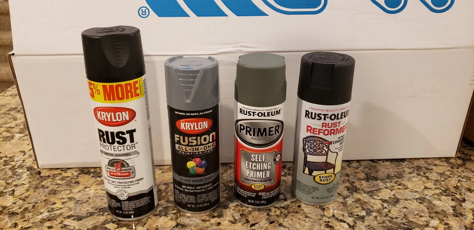

2) @Irun do you use all of those products or just by brand rustoleum/ krylon?
3) if you use an etch primer is it necessary to have a top coat two in one paint and primer like the suggested krylon brand?
These are my go-to products, minus a self-etching primer (which I seem to be out of). When you use a self-etching primer it's not necessary to use a all-in-one primer/paint. FWIW, either of the two Rust Reformers will be fine.
