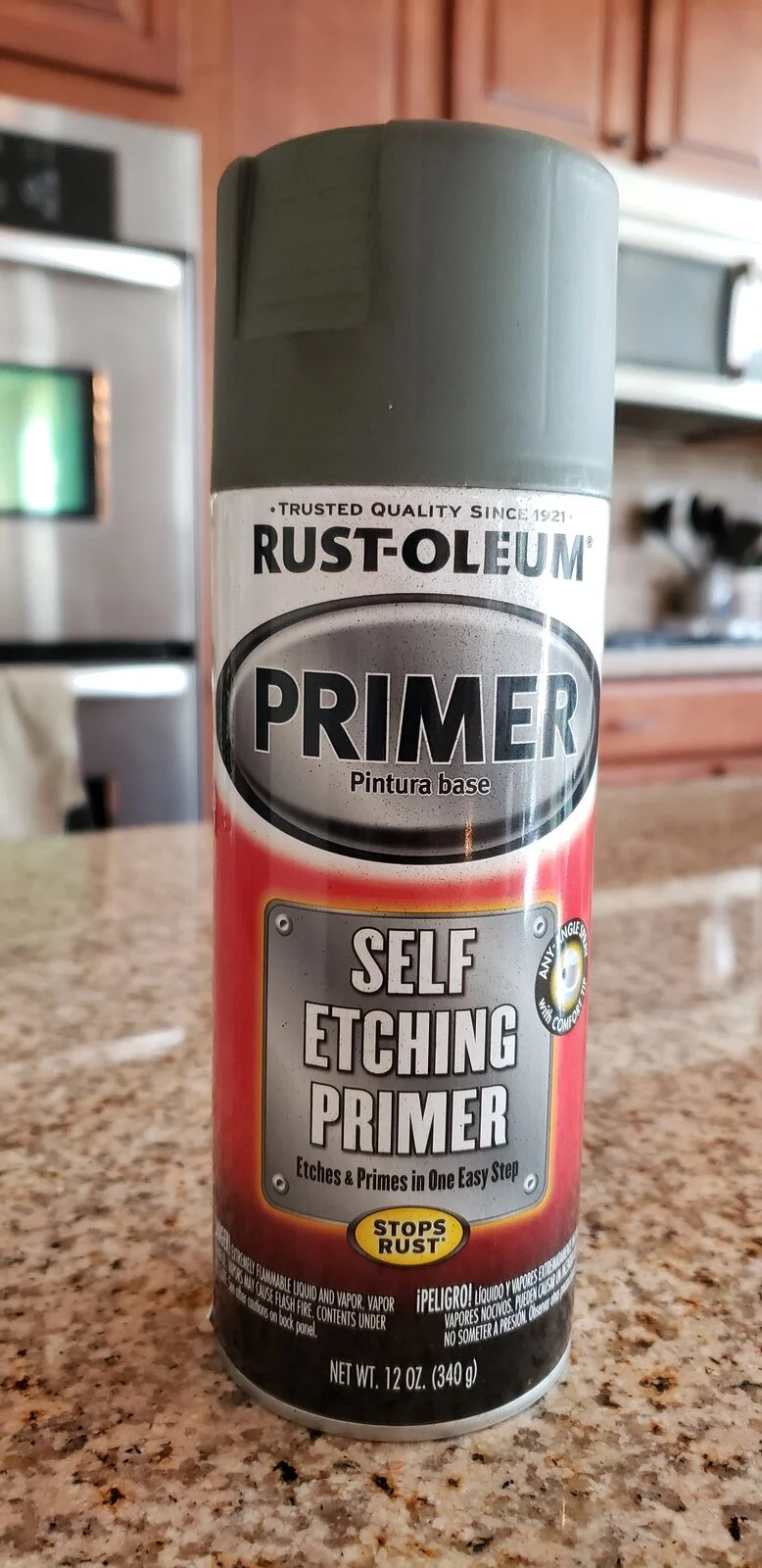

Stripped my new front bumper to bare metal. Want to use self etching primer.
Need recommendations to where i can find it at a hardware store or auto parts store?

Walmart...in the automotive section.

They sell it in CA. I don’t know if you have any SEM dealers near you but that’s always my first choice. Home Depot or Lowe’s should have self etching primer. So should autozone or o Reilly

Will do. Thanks.

Its roughed up. My friend completely stripped all the paint with a wire brush and abrasive cut off wheel. Just because there was some surface rust on the bottom around the holes.
Im gonna hit it with the self etching primer and SEM trim black. Tonight when it cools off.
