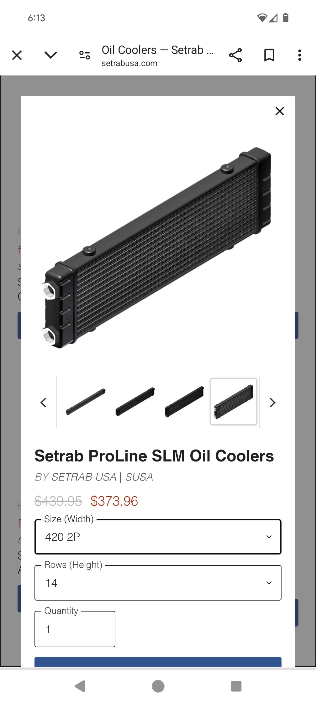

Now, let’s go back to the Setrab dual pass oil cooler.

Not a fan. I'm doing one. I don't like the routing issues I'm having to solve. I won't be doing another one. And before you disagree, just be aware we have dramatically different standards. Your install will suit your sensibilities just fine.

I just finished installing the Dual Pass Setrab oil cooler.
Thanks to @mrblaine for the steel fitting!!
I decided to keep the Derale oil cooler on the back as well (just the cooler, without the failed fan).
My routing is: TRANSMISSION → OEM COOLER → DERALE COOLER (rear) → SETRAB DUAL PASS COOLER → TRANSMISSION.
My ARB bumper and Warn PowerPlant winch don’t help much with airflow to the grille.
I haven’t tested it extensively yet, but temperatures have dropped by about 20–30°F.
