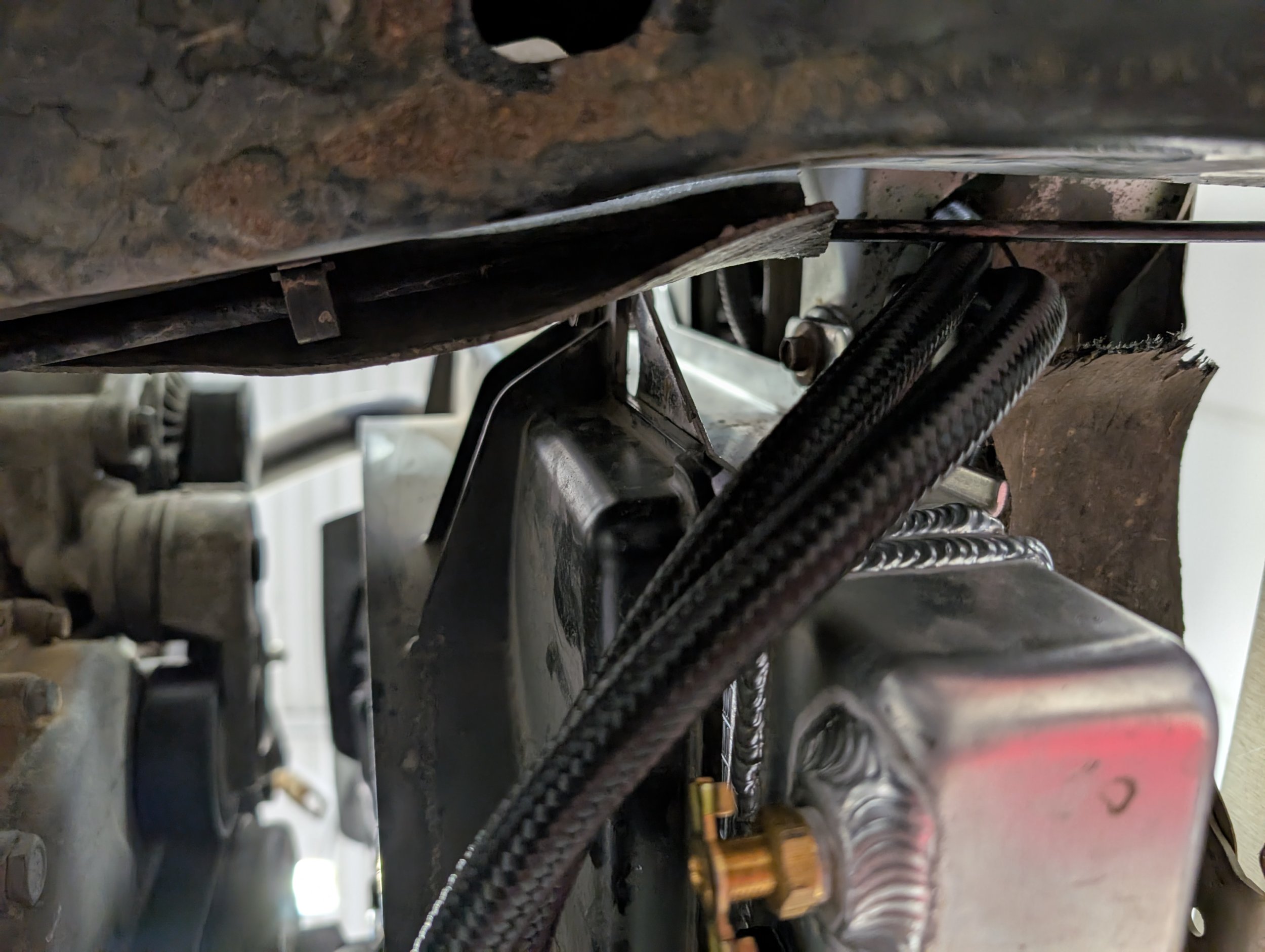

I finally installed the Setrab dual pass trans cooler. I installed it so both ports were on the right side. This worked out very well and made routing and connecting hoses quite simple.

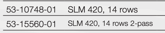

The one with both ports on the same side and the on with ports on opposing sides have the same BTU rating per Setrab. I did it this way because I thought it was easier to route hoses with both ports on the same side.
Wish I would have seen this before I bought the other version. Sort of a pain to route around the steering box
Left side for us is always the higher port. It routes out through a hole cut in the air dam and goes nowhere near the steering gear.
Well maybe I'm not remembering correctly. The highside on mine is on the driver's side, but hose goes down near the steering shaft. Not done with it, so I'm probably just screwing it up.

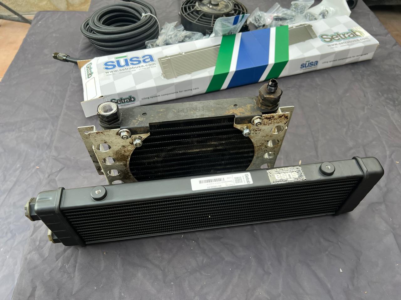

Hello All, thanks for the suggestions.
I have finally ordered the strap dual pass version and 6AN hose and fittings kit from amazon. I will install it this weekend. and test the difference with the old failed Derale kit.
What failed on the Derale unit? The cooler itself, or a fan perhaps?
