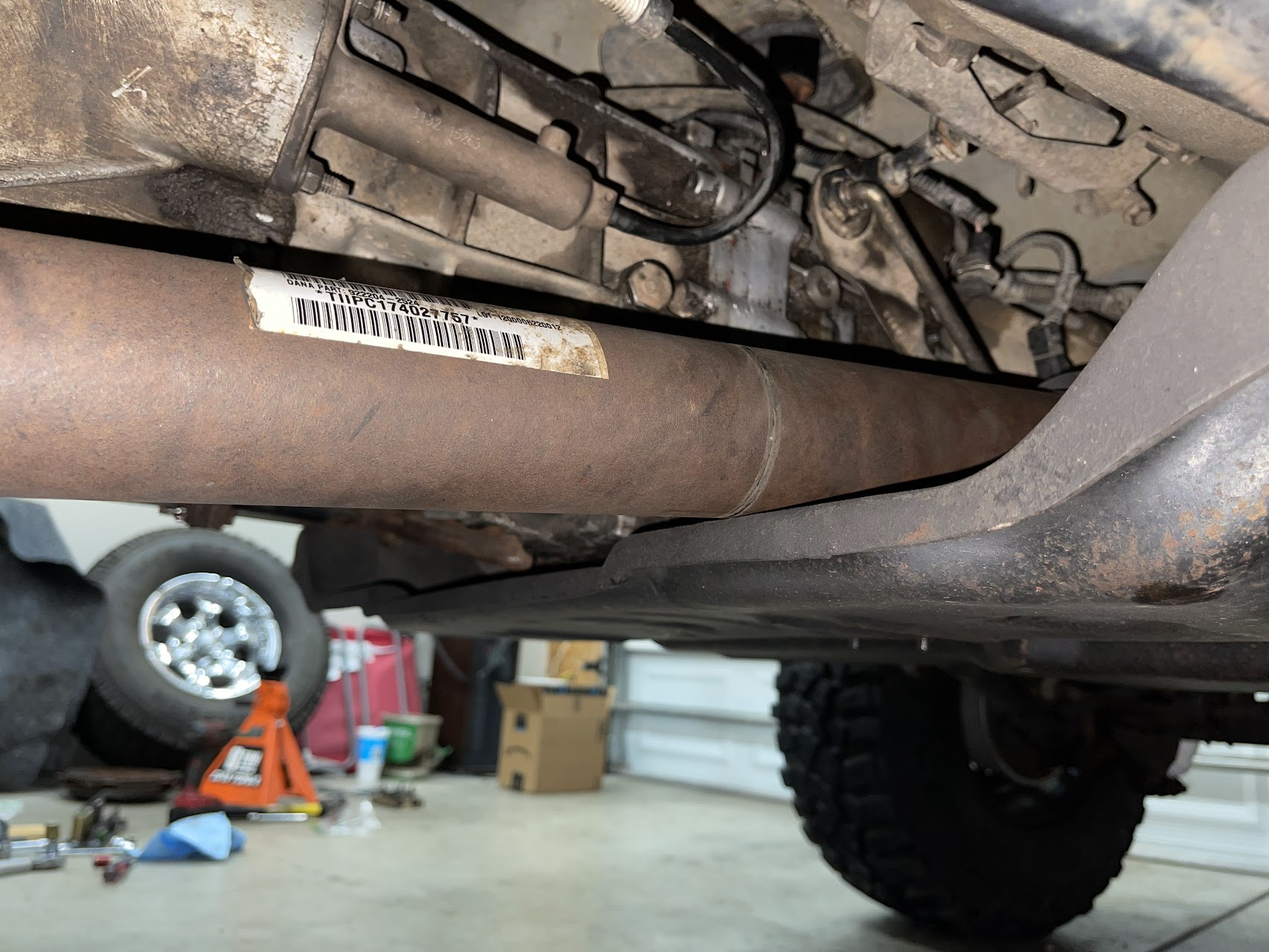

Pictures! Front end especially showing the steering... driveshafts...all would be helpful.

Going off on a tangent.
Check your Transfer case and your driveshafts WELL.
Make sure you don't have interference anywhere.
I had a similar issue, that ended up being caused by improper Transfer Case clocking.
Driveshaft was slightly warped, and contacting the skid plate, causing the vibrations & that "scrape - scrape - scrape" you mentioned.
Also, I would check the driveshaft joints, and make sure they're proper.
You could remove a shaft, to see if you can eliminate the issue.
At which point you can narrow down your possibilities and fix the troubled shaft.

Well the back shaft is for sure good, and the U joints have been checked both by me, and a mechanic. It drives great in 4WH so not the front shaft, and the fact that the problem disappears in 4W means it's not an issue with a shaft, as both are running.
I know it's been a while but I wanted to give a final update for this. Ended up being the front U-joint of the rear drive shaft and the yoke. The u-joint was definitely bad and the yoke was cracked. It was very hard to tell with the Jeep on the ground that there was play in that u-joint. Once it was up on a proper lift it was obvious. Funny thing is that the first "mechanic" that I took it to, I provided him with both u-joints for the rear drive shaft, and instructions to replace them both, since the symptoms seemed to point to that. I didn't ask him to assess, just replace them. Well he looked at them first and told me they were both fine, and didn't do what I asked, which is what originally drove me here looking for answers. I trusted he knew more than me.
I ended up bringing it to a really good mechanic that specializes in off-road, and he got it fixed up right away.
Moral is trust yourself.
