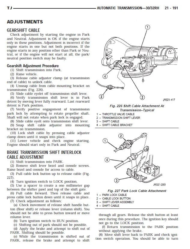

For the shifter it could be nothing more than the shift cable has stretched or the bracket on the driver's side of the transmission is broken or loose and not holding the cable well enough for the transmission to be shifted reliably. Being out of adjustment or its mounting bracket adjacent to the transmission not holding the cable securely would be enough for the transmission to not be shifted into P or N for its neutral safety switch (mounted on the transmission) to prevent it from starting.

This should be of some help. No guarantees the shifting problem is caused by the shifter cable but it would be high on my list of likely suspects.
