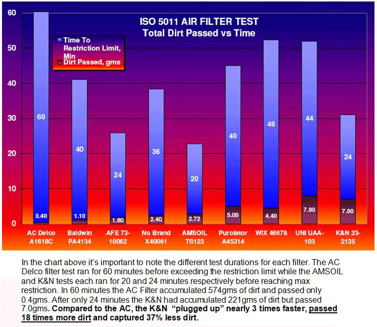

If you want better performance, just put the K&N sticker on your window instead.
