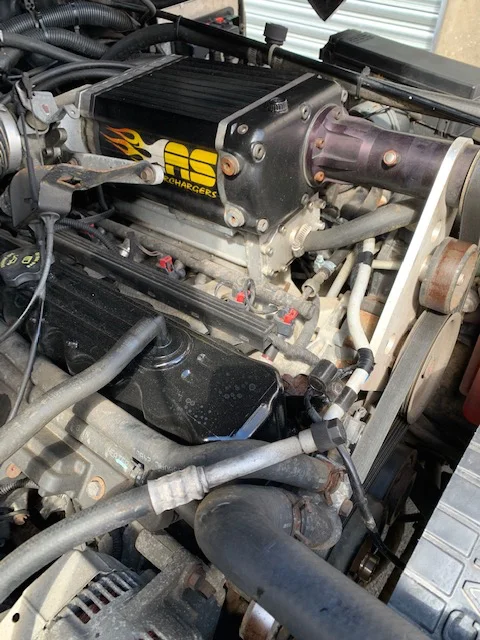

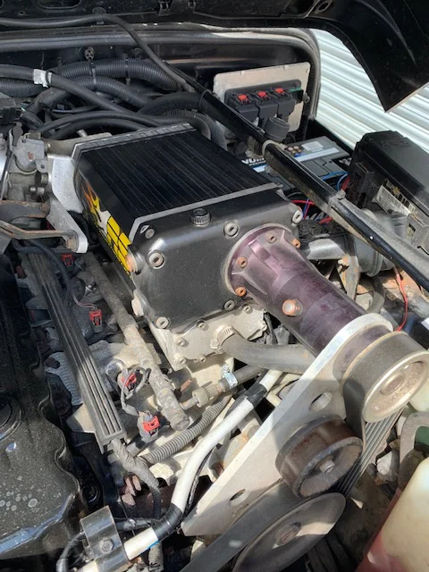

Should I remove the supercharger or keep it?
The intercooler really seems to be messing with the routing by placing the nose up so high.
If it still fits under the hood it can't be much taller than the BT setup... mine just clears. Unless the Avengers setup just won't work with a motor mount lift.

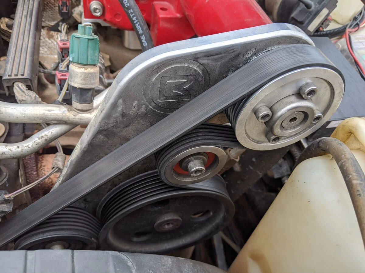

But I mentioned before I was planning to go intercooled. I'd need a new nose cone support but I figured adding another pulley here would solve the routing issue.
I can't tell if there's enough meat on his existing support bracket to add another pulley
