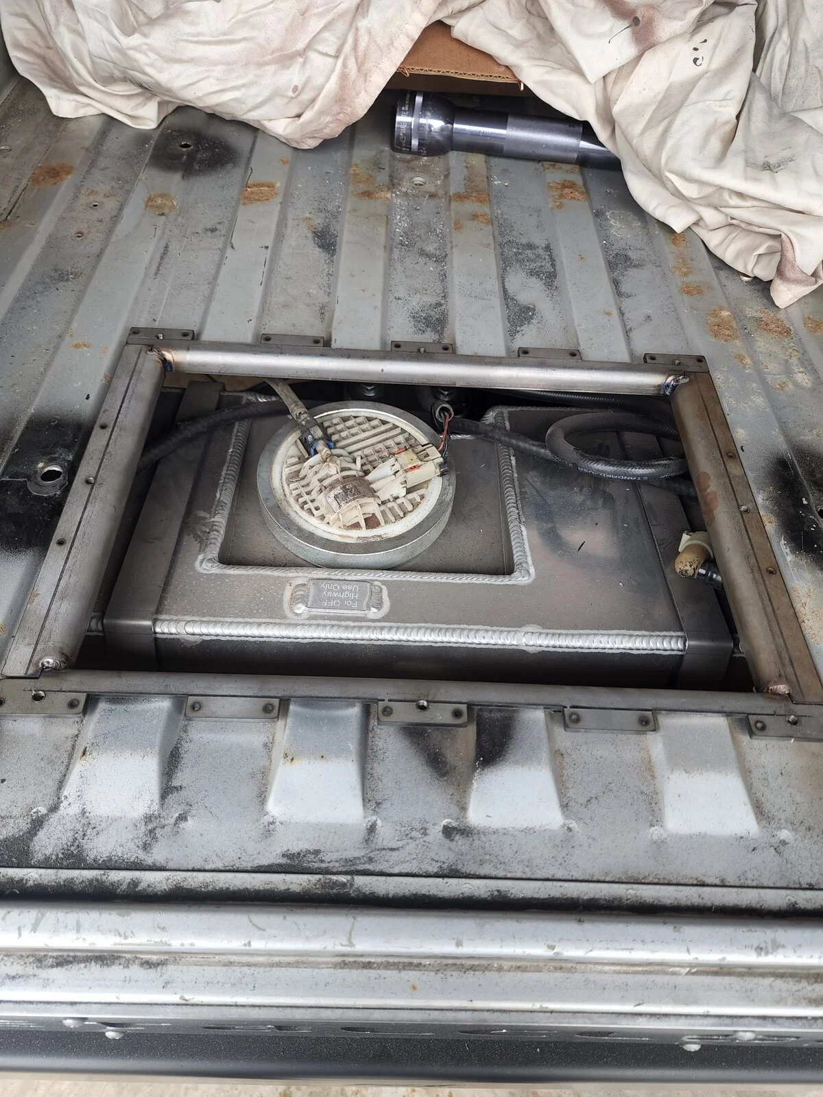

I've though about making one of those, I didn't know you could buy them. Can you cut the opening with the tank and lines still in place?
I did, and like was said, do it carefully.
