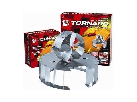

Does anybody have any actual proof/data for these claims or is this like using a butt dyno with your new CAI for HP increase readings? 🤔 :rolleyes:
p.s. Don't get me started on the gas savings and HP increase with my Tornado.
