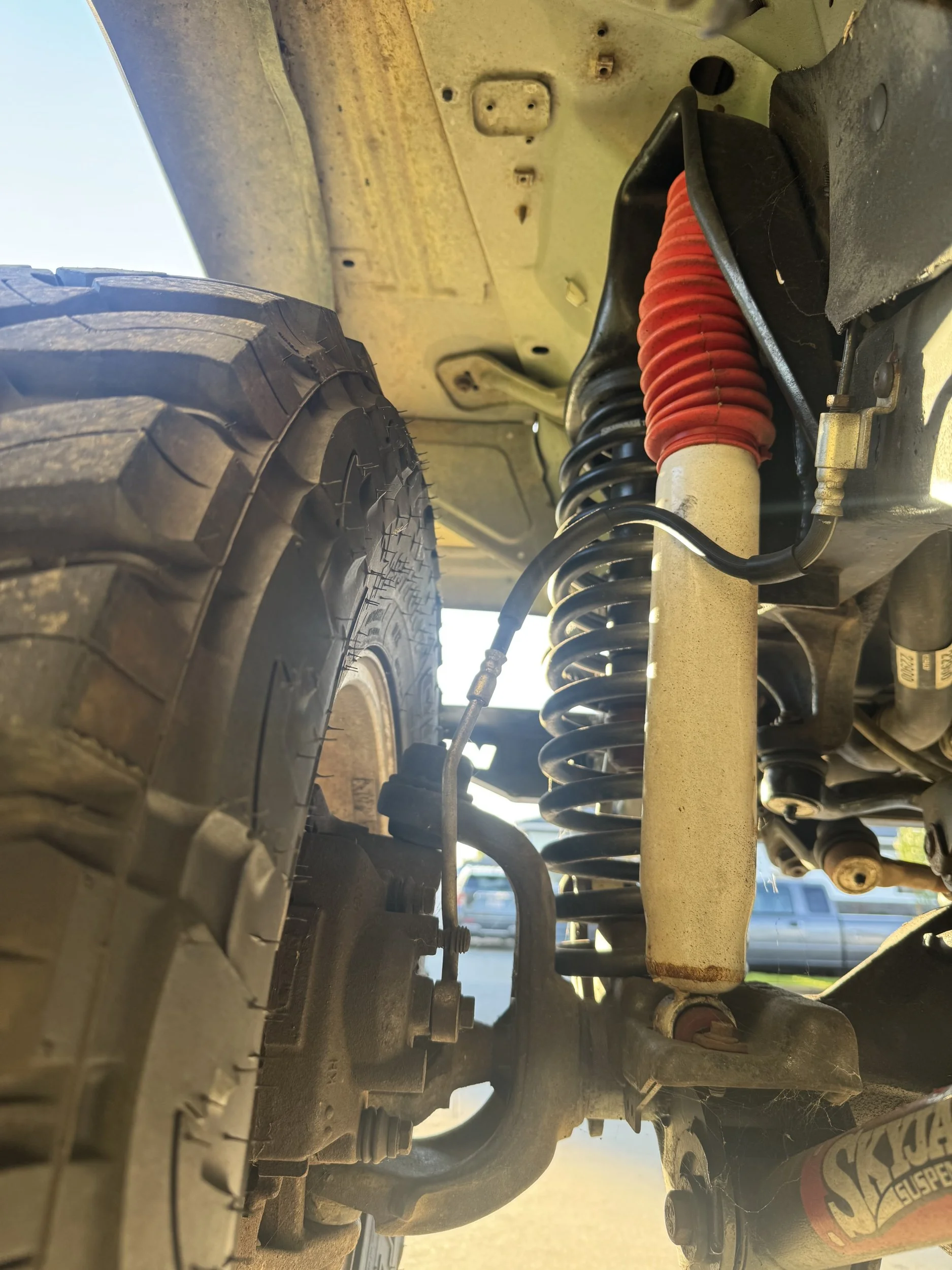

Just purchased my first jeep this week. It’s a 2003 TJ with a 4” skyjacker lift. It looks great but it rides terrible. I’m wondering if I can just replace the coils and shocks with something better, or if I need to scrap the entire lift and start all over? Any off-roading done in this jeep will be dirt roads any easy trails. I don’t need anything high performance.
Well, if you don’t need high performance, you certainly have that covered with the skyjacker.
If you’ll be diligent and pay attention to what these guys tell you, you’ll get the jeep where it won’t beat you to death….
I’m not saying it’s going to ride like a Cadillac because it’s not a Cadillac, but it can be pretty tolerable.
Load range E is for a three-quarter ton or 1 ton truck and essentially is a commercial tire and it will likely be contributing a lot to your trouble.
