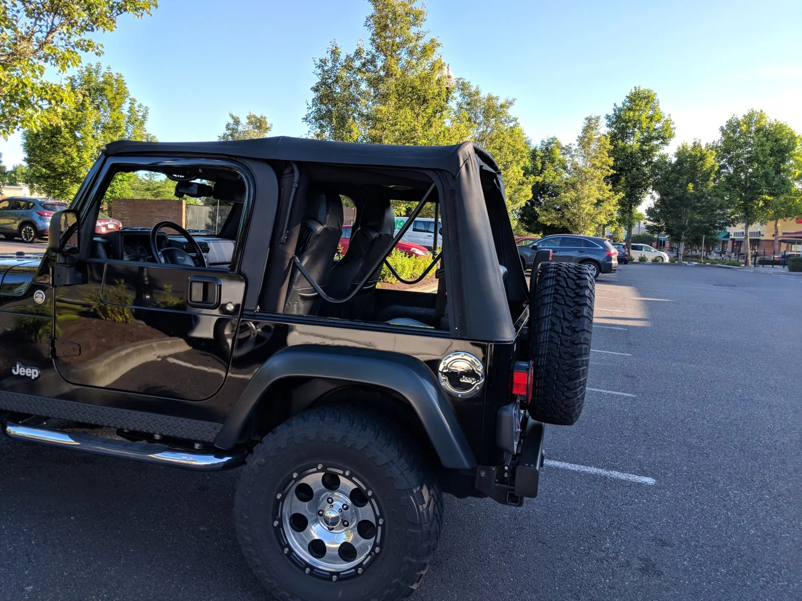

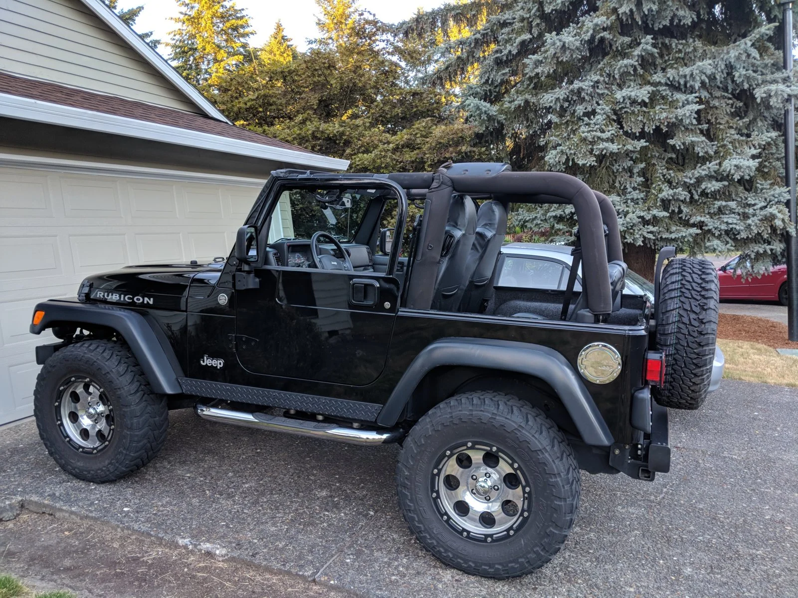

OK, the weather was too good this weekend and I decided to put the soft top on. I removed the hardtop yesterday (got the PO's storage cart with the Jeep) , and holy crap, that was too much fun. I've never thought driving could actually be this much fun.

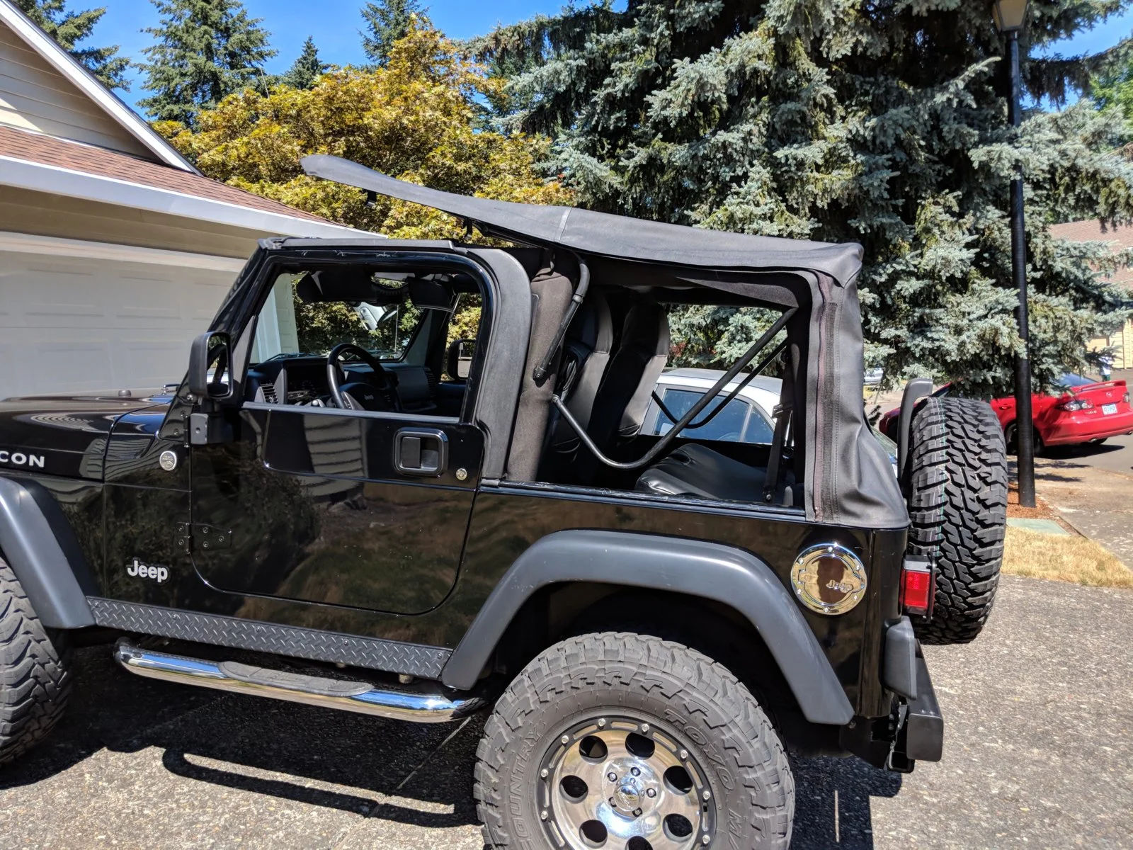

However, I need to put the soft top back on atleast until I clear out l space in my garage next weekend. I'm having a WHALE of a time with this thing. It feels like it's too short to fit. I'm sure I'm doing something wrong but can't figure out what. I did let it sit in the warm sun for hours and that did not help.
If I attach the bottom back side then the top doesn't reach the windshield. And vice versa if I attach the windshield side, there is no way I can stretch that thing to attach to the bottom lip. I watched enough videos, tried every which way and cannot figure it out. In the photos below none of the plastic/ rubber bits are tucked underneath anywhere.

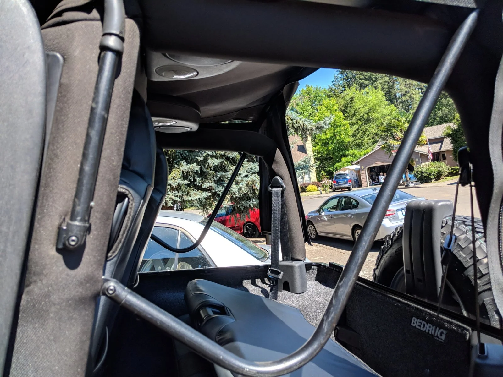

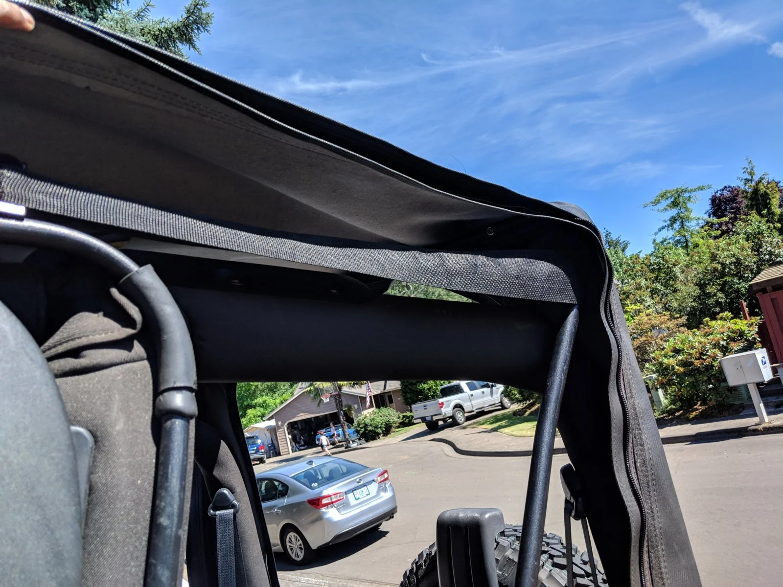

I've attached some close up shots of the back area. There is a black webbing strap attaching the back horizontal frame to thet middle one and I cannot figure what it's for. Didn't seem removable so I did not try.
Can someone please tell me what I'm doing wrong? Have I attached the frame to thet center rollcage bar wrongly? The YouTube videos made it seem very easy and yet I'm really struggling with this. Would really appreciate some help!

Attach but don’t clamp the front down. It will be tough but if it is the correct top you will be able to put your hand on the carriage and push down until you get the plastic under the lip on the tub.
It is going to be tight. I assume tj top tj tub not tj top on lj tub?

The PO barely used the soft top. I tried putting my weight, it comes down a bit then I need two hands to hook it in the lip. Going to call a friend to help.
Eventually, you will be able to latch the two windshield clips all the way, then just pull down on the rear bow with one hand, and tuck the corners with the other. Once the top loosens up.
By the way, those nylon straps attaching the two bows keep tension on the bows, and help support the rear corner of the top.
Reactions: psrivats
Thanks, I see what the nylong straps do now.

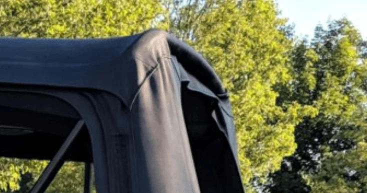

I spent an hour installing the side windows. The back window got the better of me. The upper part of the back window just had too much of a gap against the rear portion of the soft top that has the teeth. There is no way that zipper is closing on without some sort of magic. I even had two other friends try and give up.
So dear wizards of the forum, I need your help once again. Should I have done the back window before the sides? I really don't want to touch the side windows if I can. I think the main problem is that the soft top still is not stretched out to it's proper length. Other than parking the vehicle in the sun for a week, is there anything else can I do to help it stretch faster?

Do not attempt to stretch it faster. It will compromise the stitches. Do not force zip the windows either.
Better off, when sunny and hot outside, leave the windows out on the sun, then assemble them in the afternoon.
Get a candle and wax all the zipper before you install them. It will help ease of installing them.

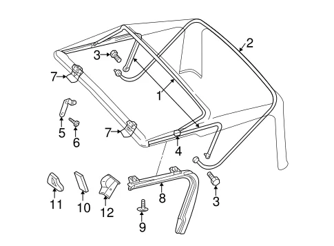

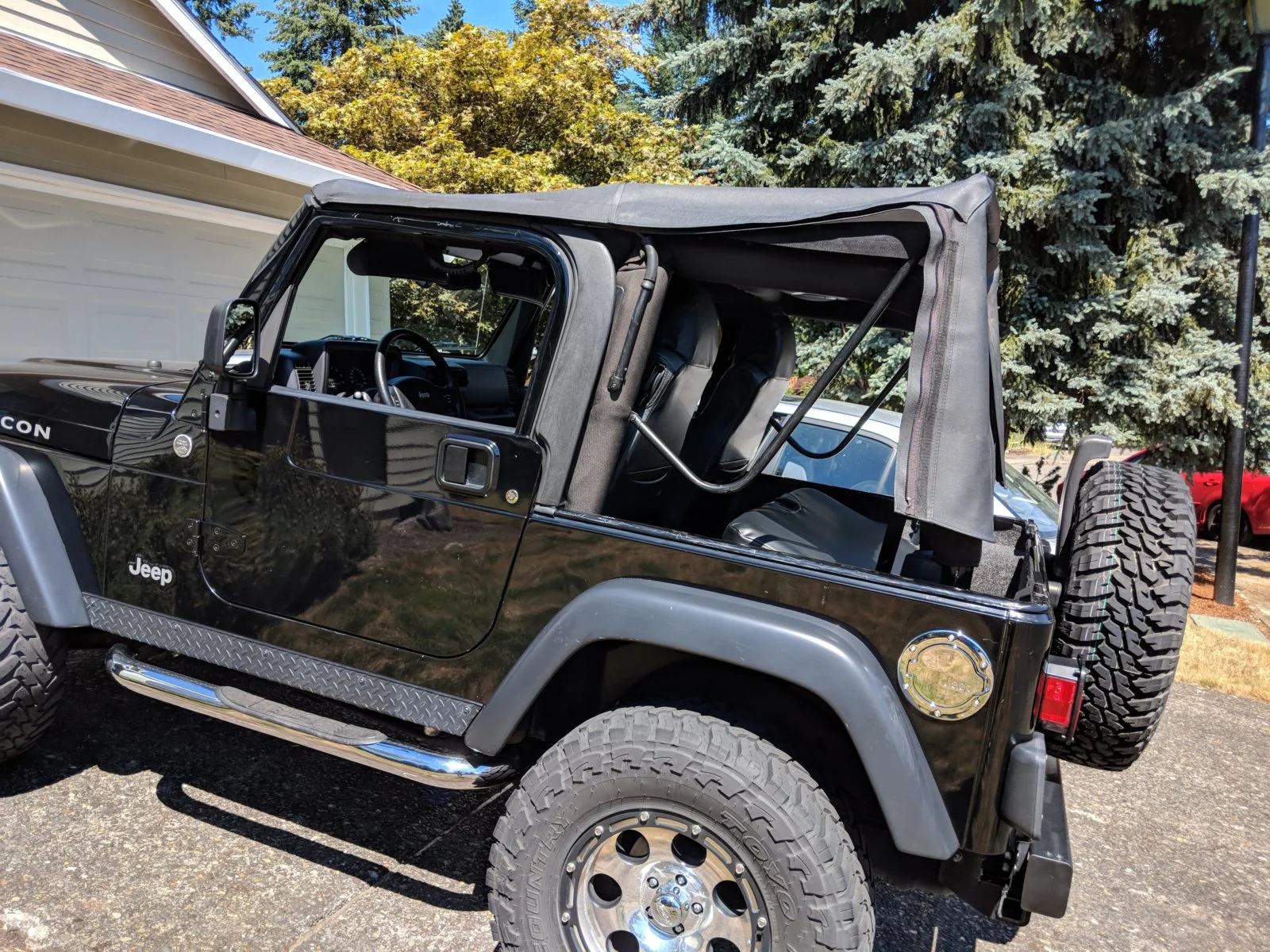

I was looking back at how tight your back frame rib is (where #2 is pointing). This is not going to acomodate your back window. I suggest you remove everything and modify your J-frame. Bend it "inward" a little at the "J" area. I used an electrical conduit bender. The concept is that the top edge @ #2 rim will go down 1/2" inward. I tried this to one for my TJ sport and my son can install his easier thereafter.

The rear window won't go in without the side zippers. I tried that yesterday and then went to install the side windows. I have not tried undoing the top (without the side windows) from the bottom lip in the rear with the front still attached and then attaching the rear window. That may work but I am guessing that is going to take a LOT of effort to get the rear bottom of the top tucked in. I can try that later when I can get my friend to help me.
On the youtube videos I have seen, what really stands out is how much closer the rear bottom flaps are when the top is just loosely sitting on top of the vehicle. You can see my photos above how much farther they are. I really thought I messed up as to how I attached the frame, but after seeing several videos, I don't think I did anything wrong.
