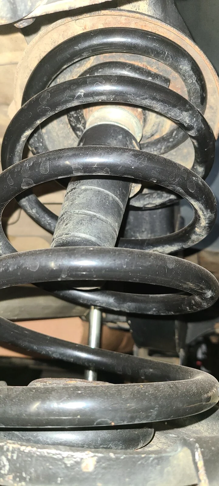

I'd like to hear your thoughts on these options, and if there are others that I'm missing (except shock outboarding).
I'm leaning towards clearancing the spring perch - easy and cheap, without adding leverage against the factory shock mounts. What do y'all think?
If your only in need of minor clearance then trimming the spring perch is going to be your best option. How much interference are you dealing with?

I'm not sure yet. I'm about to tackle a tummy tuck, but I want to have my ducks in a row so that I'm not waiting on a part order to finish the project. I'm at 3" of suspension lift and am doing a Savvy tuck, so I expect to have enough pinion angle to cause shock contact. They are already close as it sits. Thanks for the input.

Mine needed perches clearanced as well as shocks cans up and are still pretty close to contact. 4" lj springs rear though.
the "pro" is to do it, the "con" is to not place it right.
do the shocks fit proper now? are they mid travel? is that the travel zone you intend to maintain?
the rotation of the pinion upward will twist the shock mount downward and open it's resting /ride height length (could be a 1/4" could be an 1") and put it into a potential contact area below the tube.
most of this equation has no answer until you see where you end up. how much rotation is forced and how much that changes the shock window at rest. then you can make a choice for trimming , bracket relocation or possibly a different shock length.

The lower shock mounts are close to vertical when the axle is rotated for a DC driveshaft. It is not only hanging down lower, it is at an angle that doesn't allow the shock mounts to ramp over an obstacle.

I ran 3" SL and full Savvy TT, and had clearance issues with the shock body contact and rubbing the perch. I used shock extension brackets initially, and later I removed them and trimmed the perches.

The shock mount extension brackets are a pro if when you rotate your pinion your shocks are now too short. For me my pinion was so rotated that I had a good bit more uptravel than down travel. The relocation brackets decreased uptravel and increased downtravel by 3/4” respectively pushing me closer to a 50/50 travel bias.
They are a con if you lose uptravel to the point where you no longer have at least 50% of your travel as uptravel.
They are also a con because they put more leverage on the shock mount increasing chances of bending or shearing it off. I just checked mine and my mounts are now bent as hell. I will probably end up just getting a set of shock mounts and welding them on where my travel is 50/50 which to me is the optimal fix for this problem.
