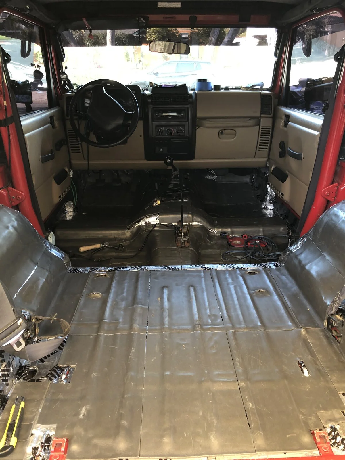

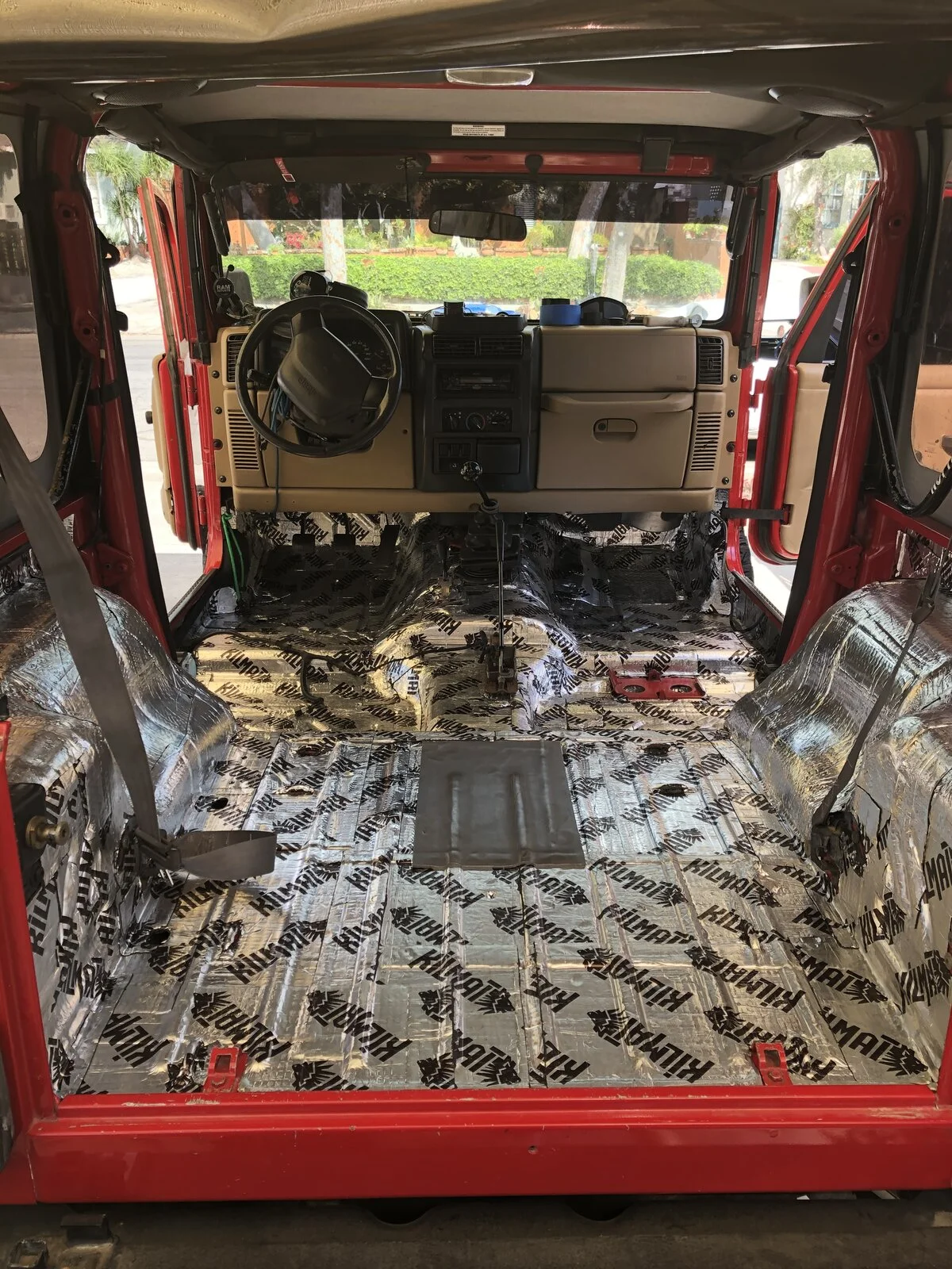

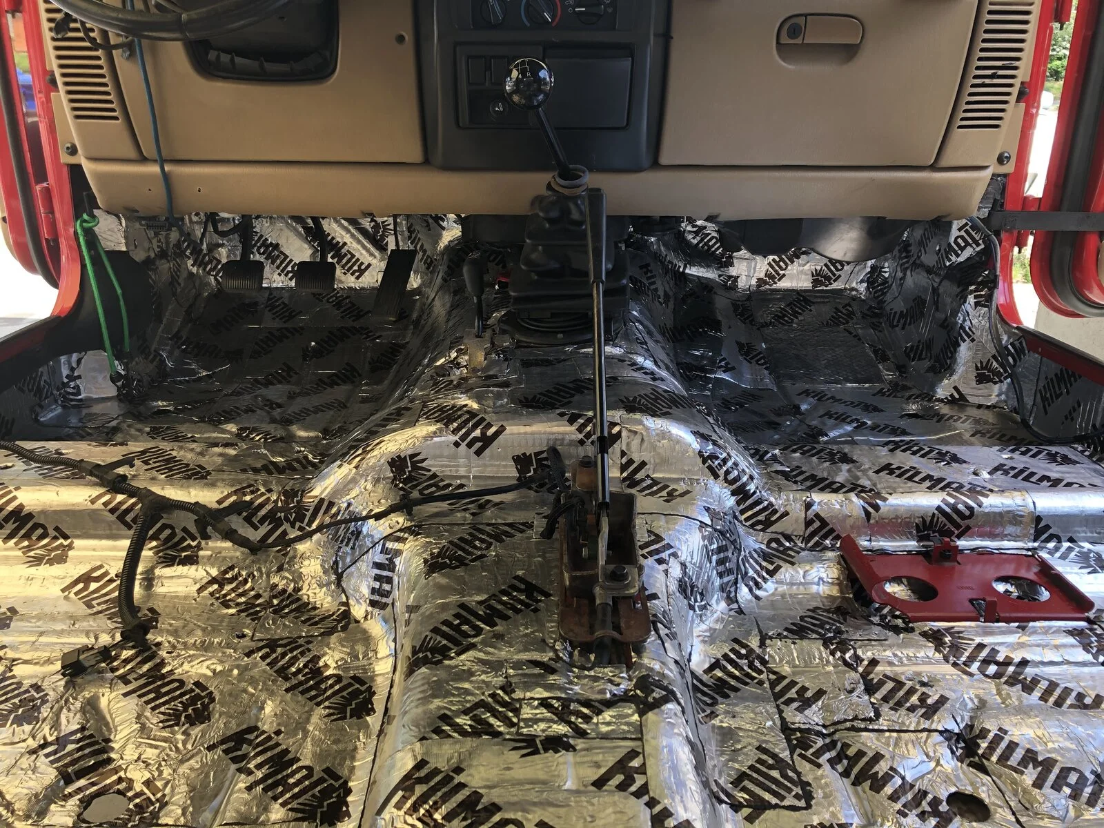

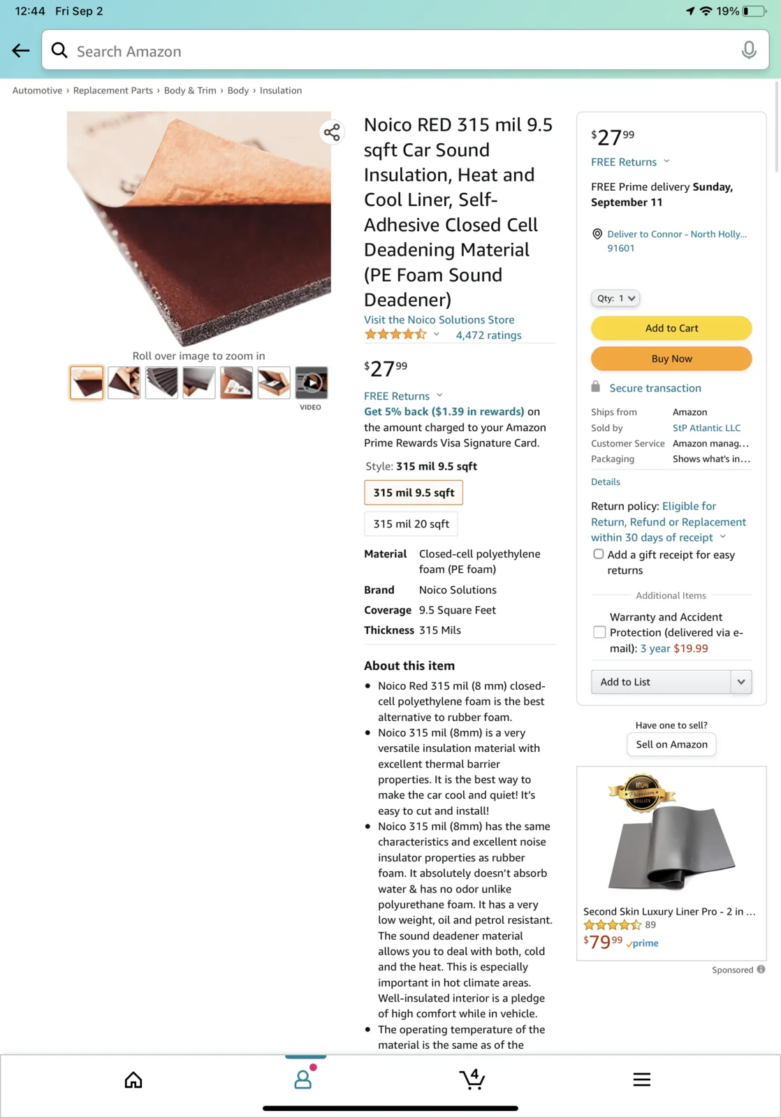

I did the kilmat 80 mil plus the 150ml noico red foam on top it helped with noise and heat for certain . Summer time my feet could barely be on the floor with bed rug carpeting . After no issues in summer with heat and about 5-7db quieter on highway . It was a PITA job…Would I do it again , yes .
