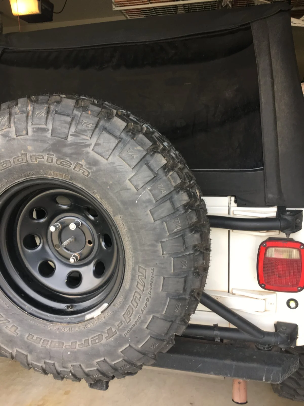

Has anyone with a bestop highrock spare tire carrier added a license plate mount to the carrier? I’m trying to figure out if the JKS spare tire license plate mount will work or if there is a better one out there with a license plate light included?

I was just looking at that one myself. It was just the bracket for the lp and nothing to mount it all to the tire carrier. That’s where I’m stuck. What did you do to attach it to the carrier?
Get a 1/2" coupling nut. First put a 1/2NF regular nut on the long stud in the pic, that's your jam nut. Mount the lite plate to the coupling nut with a short 1/2NF bolt, screw it on to the stud, hold it in place with your jam nut. Easy peasy...
