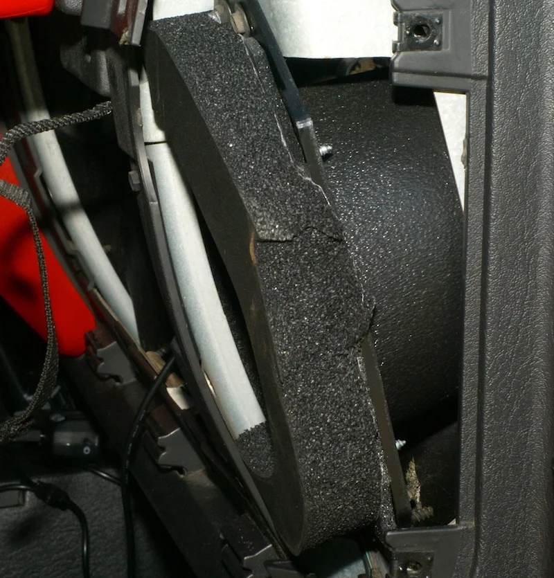

I'm running these foam "pods." Do they work as well as the plastic version?

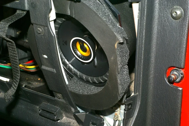

I used the foam pods in the front as well - plus cut a 1/2" port in the back (wires go through it.) I also put foam "speaker rings" on the frontside to direct the sound through the grille and not into the inside of the dash. I can't tell you the A/B difference between the foam pods and none as I put them in at the time of speaker install - BUT - I can tell you the rings did make a difference. So much so, that I actually biased the fader control to the rear by another notch.

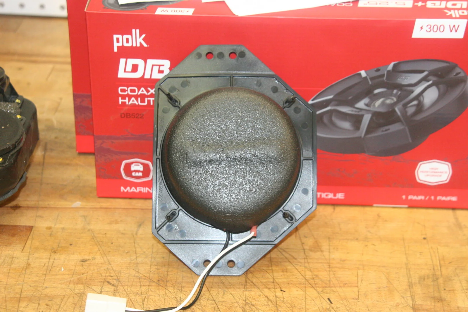

Pods are interesting, but not required. A pod will certainly improve the sound of the 5.25 as it will turn the speaker from a free air to a sealed box, which will make the speaker more accurate and less muddy. Foam pods will have some of the same effect, but not all as the "sealed box" is now flexible.

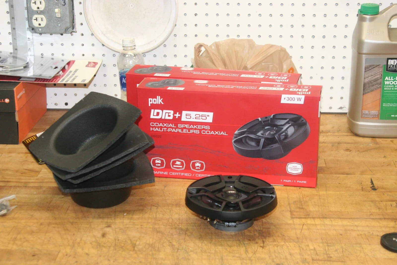

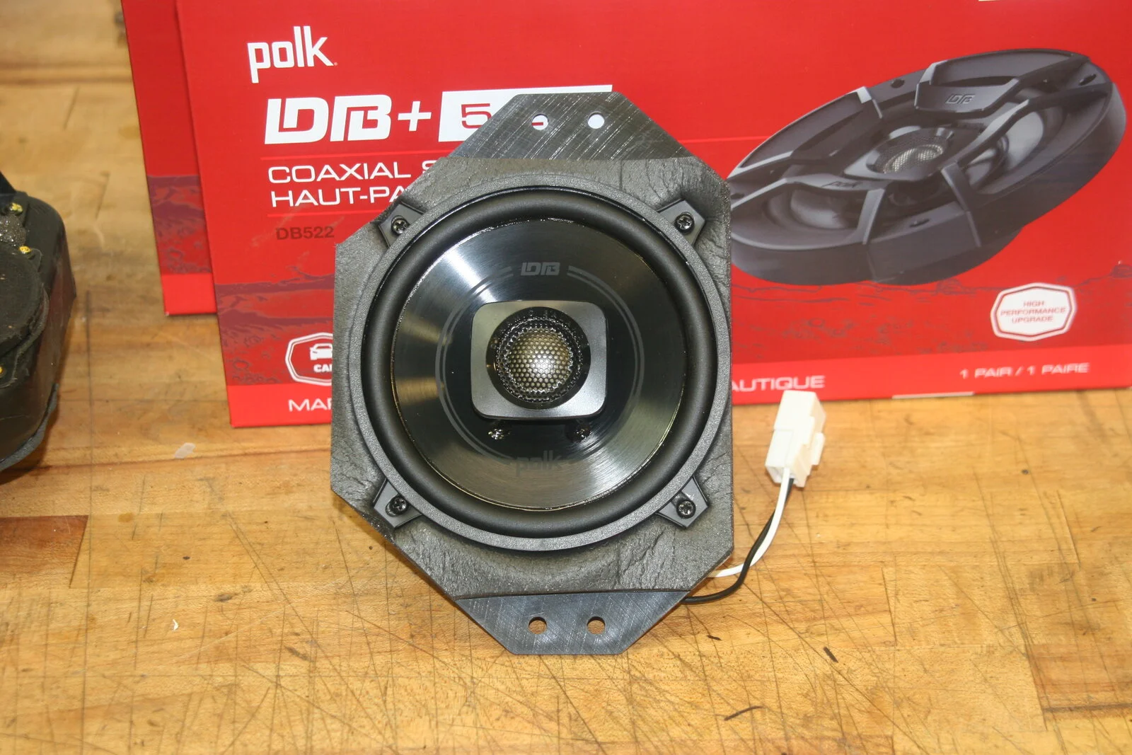

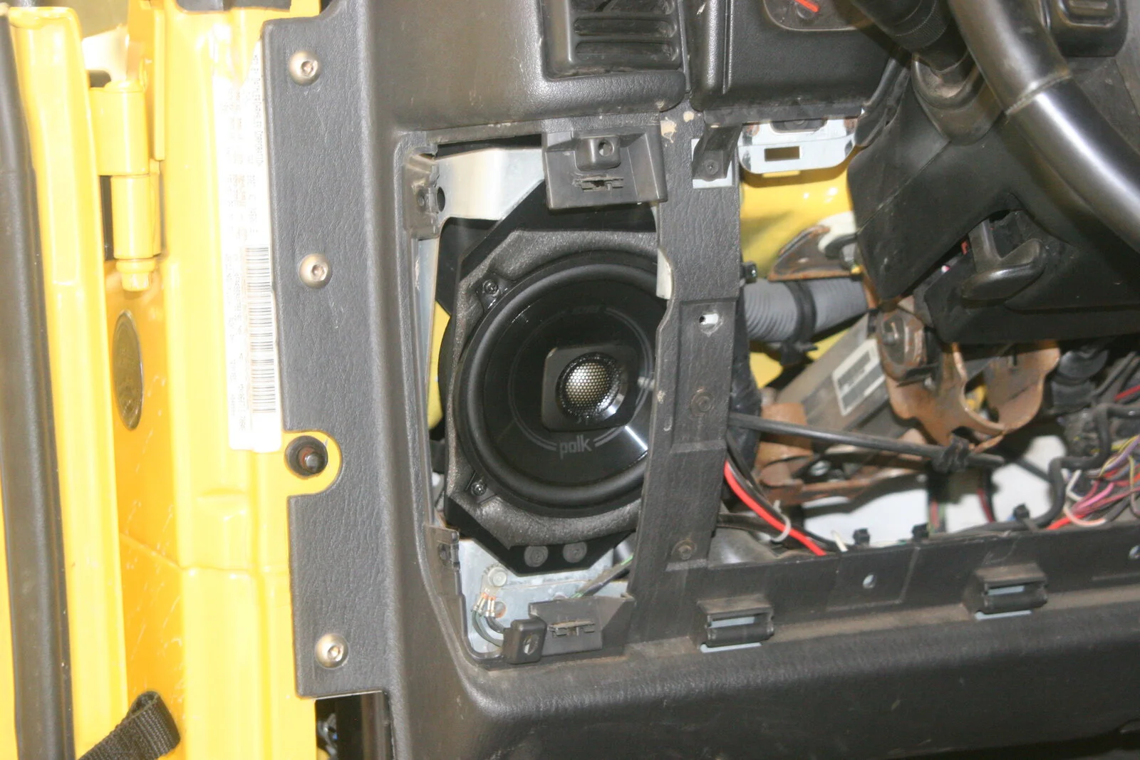

If you have access to a 3D printer you can print the front speaker pods yourself. The .stl files are on Thingiverse. I was thinking about DB652s in the rear but realized that I'm using a system crossover frequency that would not take advantage of the lower response of the 652s. The frequency response of the 522s is already below my crossover frequency. So if you are using the active crossover function of your head unit it may not make any difference whether you install 522s or 652s.
I personally installed Polk DB522s in 3D printed pods up front, 522s in the rear with polyfill, a Kicker 6.75 in the console with a Kicker 200 watt amp, and 1" tweeters mounted on the overhead rail up front that my radios mount to. I did have to pad the tweeters with10 ohm series resistors to balance the high end to my liking. I used the active crossover settings in my head unit to get the system response I prefer.

I used a dremel to cut out the recessed portion of the pod, which then left me a flat panel into which I could mount my speakers. Since a screw into thin plastic doesn't get it done, I then used small spring nuts behind each hole to make sure I had a solid connection. I also used polyfill to cut down on some of the boominess (cut open an old foam pillow if you need to).
The front I used the mounting plates that have been linked above, but I do think they'd benefit from some sort (foam or otherwise) enclosure.

It is definitely a more out of the box/plug-and-play concept. The plastic box serves to both act as a wave barrier and also as a sealed box. The foam barrier only blocks the wave, but is not rigid enough to be a sealed box.
I'll probably go with the sound deadening since it is cheaper and more useful around other parts of the vehicle as well. Good sound isn't a matter of the speakers so much as the environment in which it is operating.
