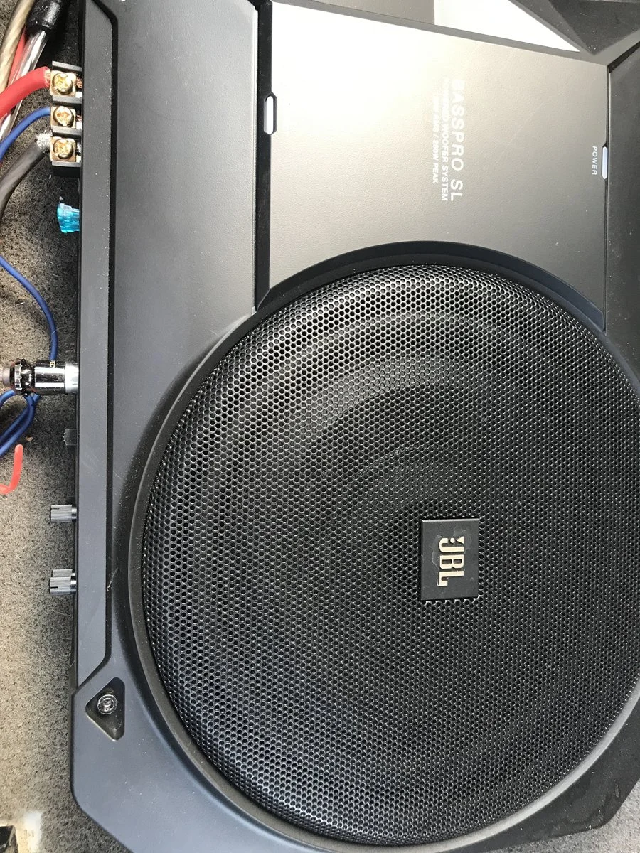

Definitely recommend the sound bar upgrade the I went with a reasonable set of speakers all the way around, didn’t go crazy. But the sub under the back seat was a game changer. B568EB24-99FB-4779-A58F-2C85168F0118.jpeg
Reactions: Ottisww
