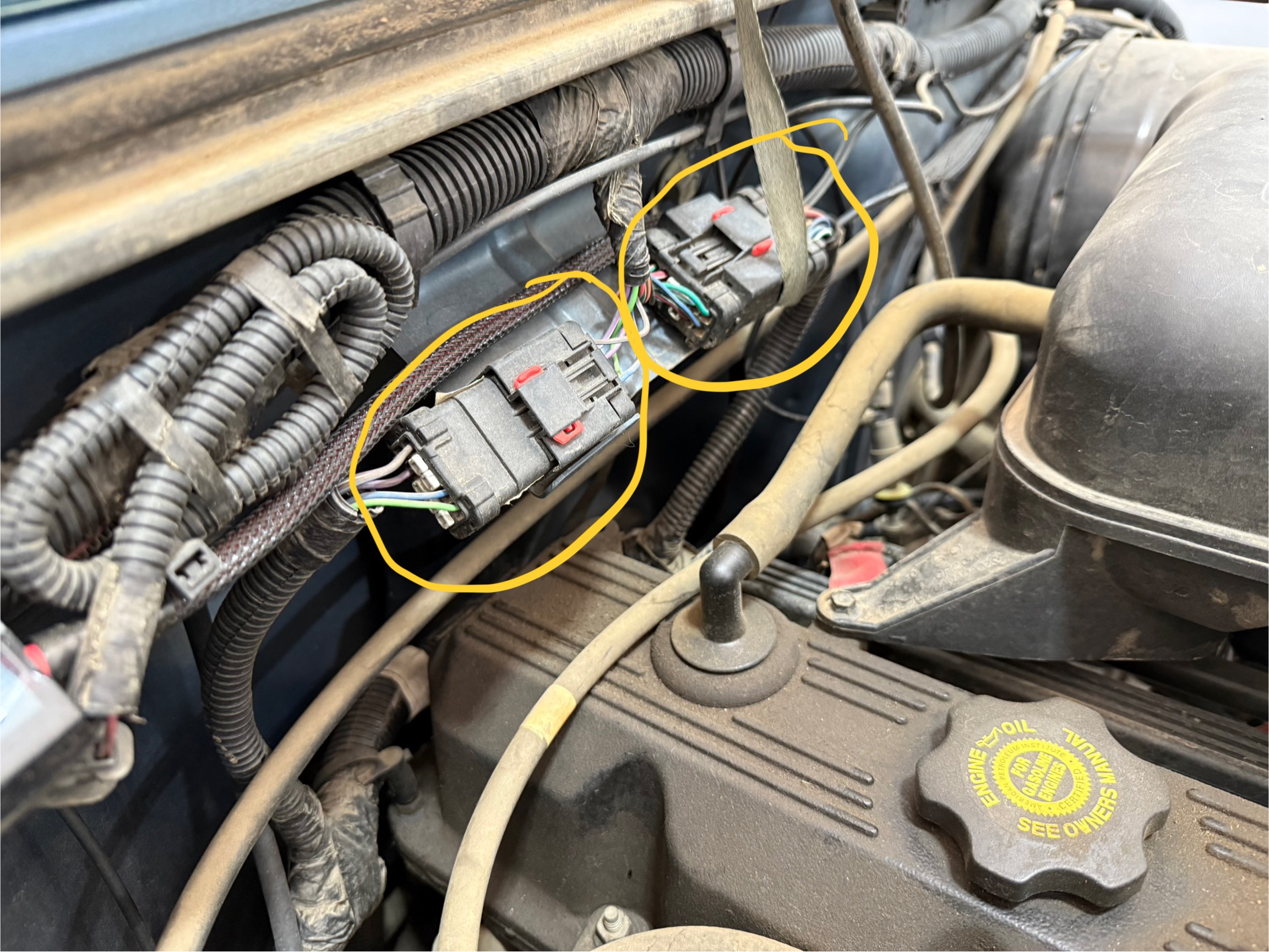

A not-so-wild guess is to make sure the big wiring harness connection above the engine at the firewall is fully seated. I had a similar issue on mine years ago and that was the problem.
These bad boys? Thanks, I’ll give that a try.
Reactions: jjvw
Give them a good wiggle and squeeze. In my case, I had disconnected the connectors sometime before the dash cluster started cutting out and I learned I didn't do a good job of connecting them back together.
Tried that. Didn’t seem to help. Going to blast them with some contact cleaner.

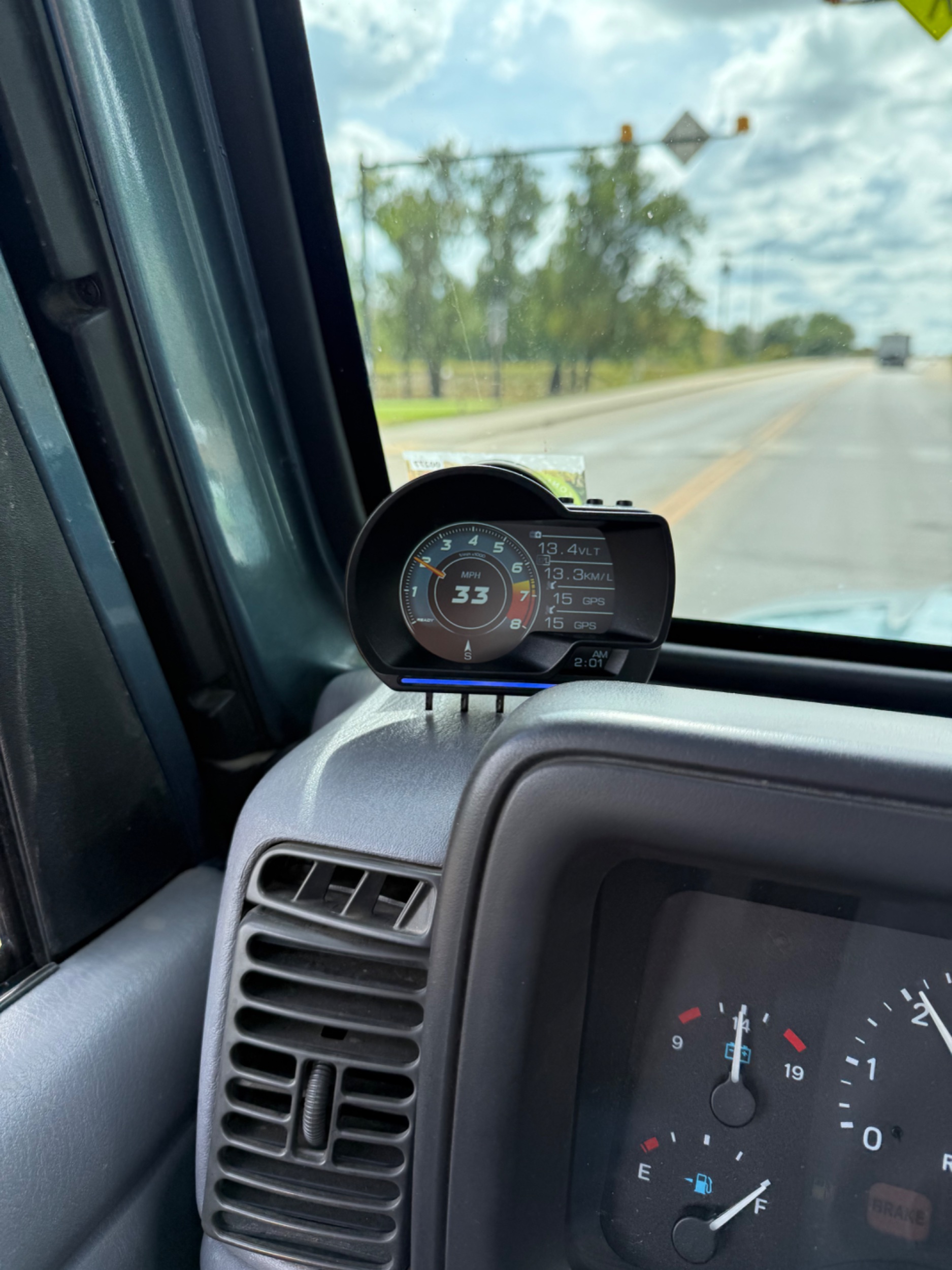

You’re saying you flipped on the right blinker and the gauges came back? I’m really thinking there may be a fault somewhere in the multifunction switch that is causing the issue. Worth $45 and 30 minutes to try. Will report back. For now, going to use Waze on CarPlay to get GPS speed info.
Picked up one of these for $30 on Amazon. May be what I have to live with for now. Plugs into the OBDII port and still functions when the gauges drop off. So I'm guessing is a gauge cluster or connection issue, not at the BUSS.
It's a really good thing you didn't post a link to what you bought so people could check it out.
Like seriously, what a relief.

Im interested to know how laggy that aftermarket gauge is. Can you video it while you're driving, where we can see the jeep tach & the new gauge at the same time?
