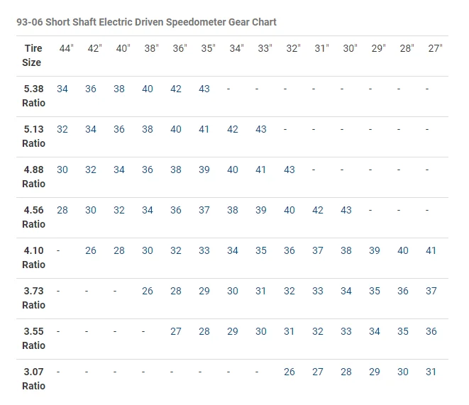

Trendsetter75 Member Original poster Joined Jun 14, 2018 Messages 39 Location Long Island, NY Jun 14, 2018 #1 I wanted to know what speedometer gear would I need for 33s on 5spd manual with 3.73 gears? If anyone can link me a chart that would be great.
Luke02 Member Joined May 17, 2018 Messages 37 Location Tampa Jun 14, 2018 #2 31 tooth gear. I just did mine a few days ago. Sent from my iPhone using Tapatalk Reactions: Trendsetter75
Alex01 Ready to hit the Rocks Supporting Member Ride of the Month Winner Joined Mar 23, 2018 Messages 8,336 Location Truckee, CA Jun 14, 2018 #3
