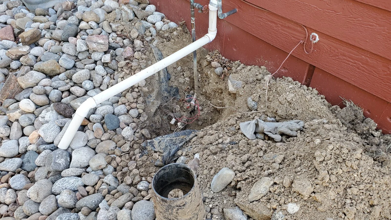

Replaced the interior valve which feeds the vacuum breaker. That revealed a failing PRV valve to the house. Replaced that, and then my vacuum breaker bonnet fell apart. Replaced that only to find a crack at the top of the VB body. Ended up replacing the entire vacuum breaker🙄 Finally turned the system on again to find out what exactly goes where and the general horrible state of things. Absolutely no water to anything. The backyard manifold has a 1" line going to it, and a 3/4" line that daylights nearby which I thought fed the front yard manifold. Began digging to see what is happening and where the "T" is at. Ended up finding an inline valve about 6" below the ground surface and covered with 4-6" landscaping rock. Turned that on, and I now have water to the front yard manifold. The valve leaks of course and the 3/4" line is still empty, so need to address that.

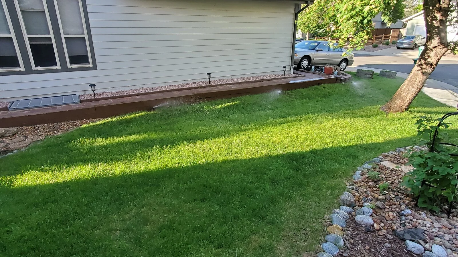

Started turning on the front yard valves (they leak), and would hear/see bubbling in the yard and started digging. Repeated that process and ended up finding 5 sprinkler heads well below the ground surface and found 4 where the 90° fitting had broken away. The manifold leaks horribly as well and my box was pretty much filled with water once I got done adjusting and tuning the new sprinkler heads. However, everything is sorta kinda working. I was admiring my work and watching the lawn being watered when all the sudden I lost all pressure again. Water began daylighting near the sidewalk. So...another break I need to repair (or maybe head?). Its progress though!

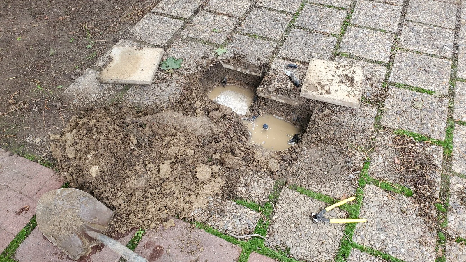

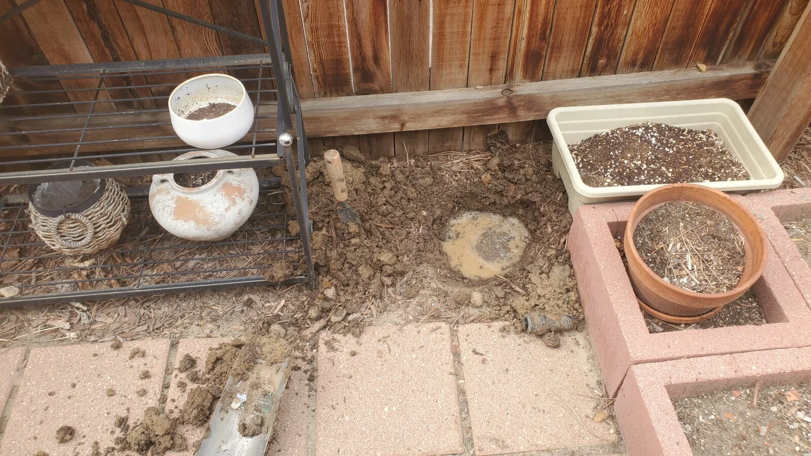

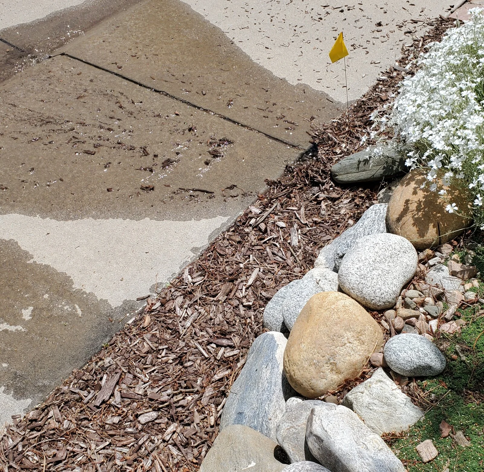

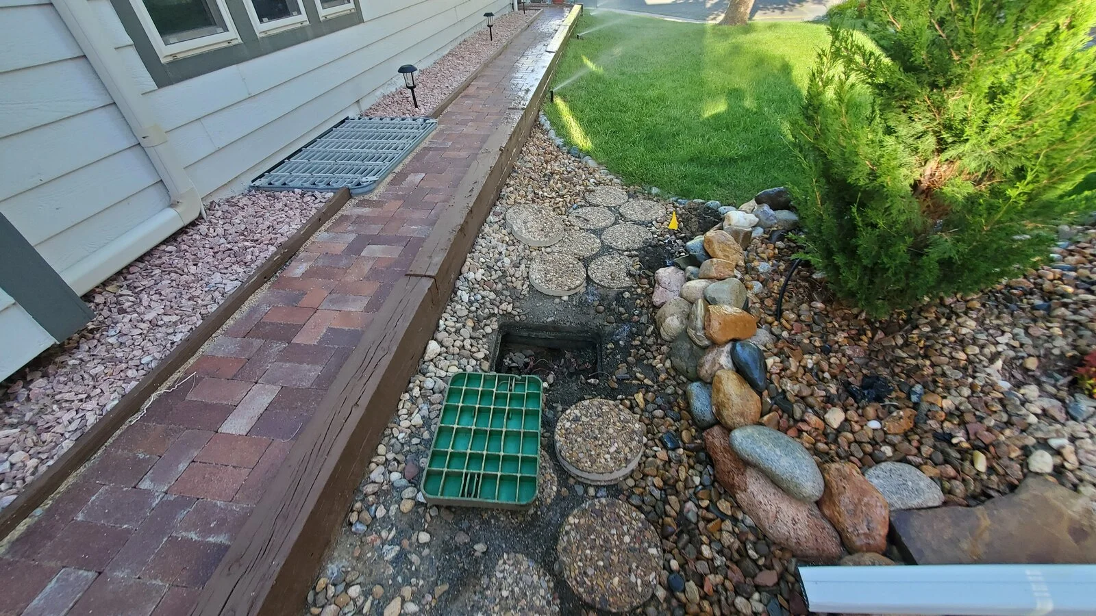

Well, repaired the sidewalk leak. Another 90° fitting that was broke, I think it was just packed with 20 years of clay and didn't leak at first.

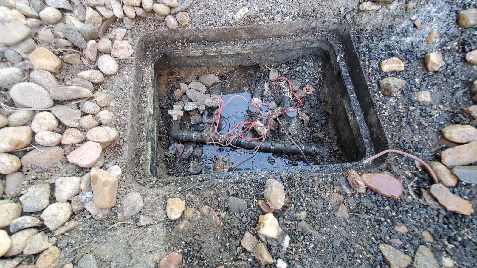

Here's the inline valve I found and dug up this last week.
Here's the front manifold box that was also covered with 6" of dirt and stone pavers placed over the top. I only by chance found this last year when I saw the smallest wire coming out of the ground

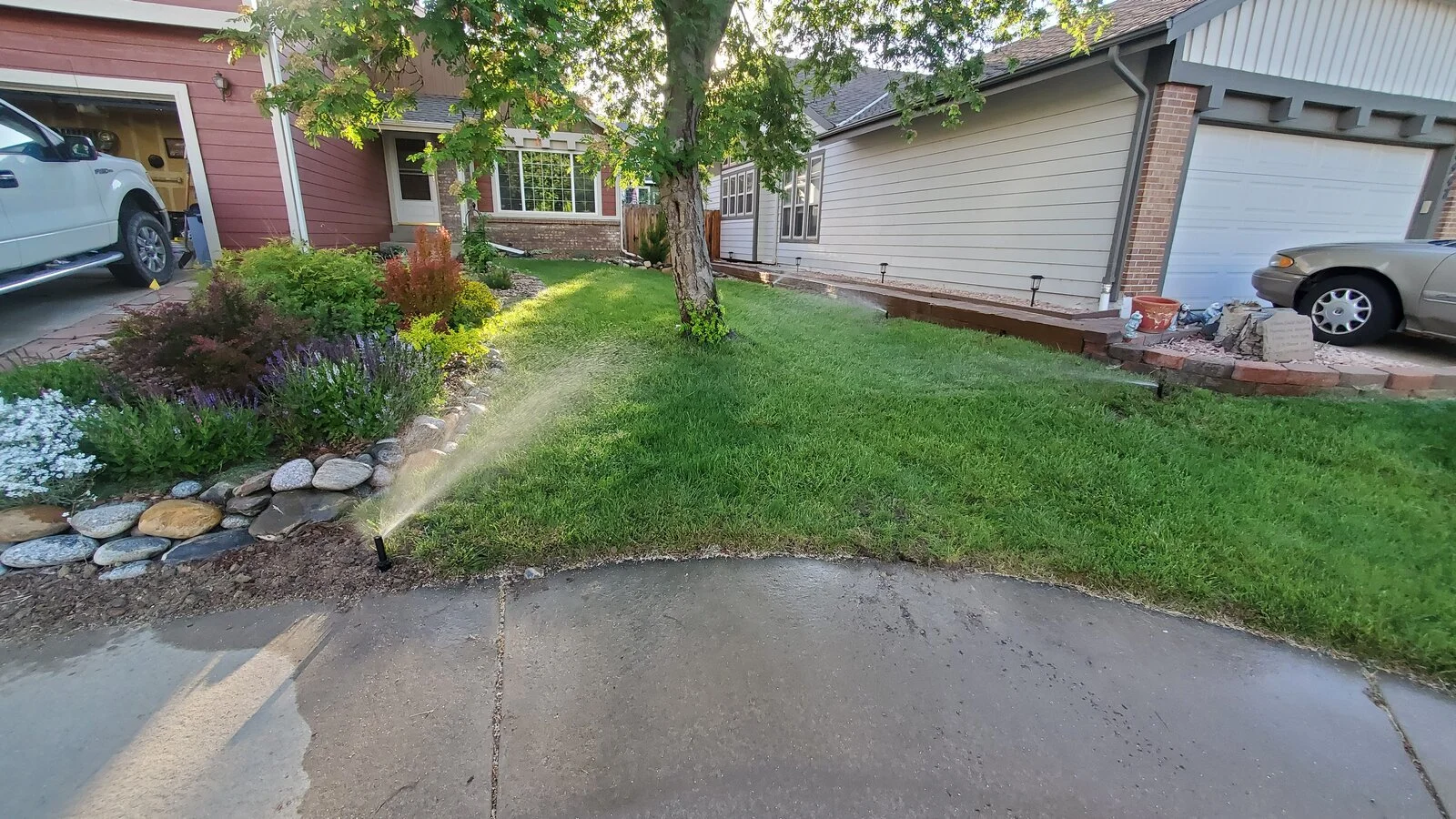

But even with the valve and manifold leaks, I can at least water my lawn easier until I get the controller and valves replaced

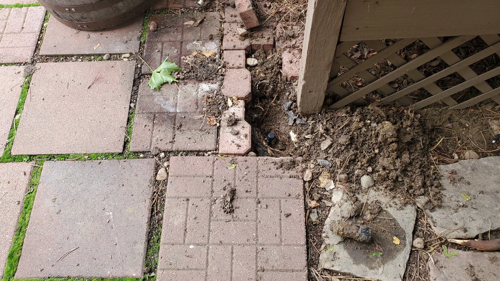

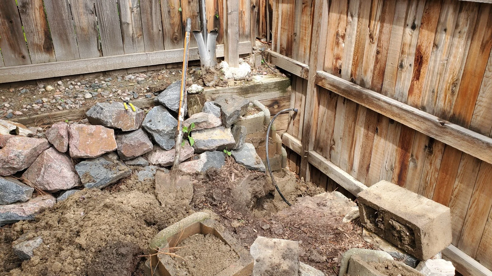

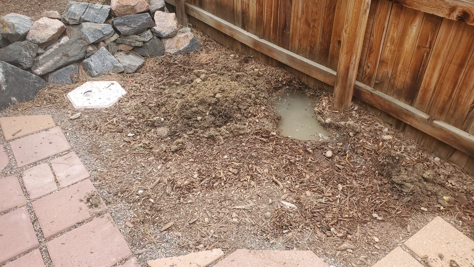

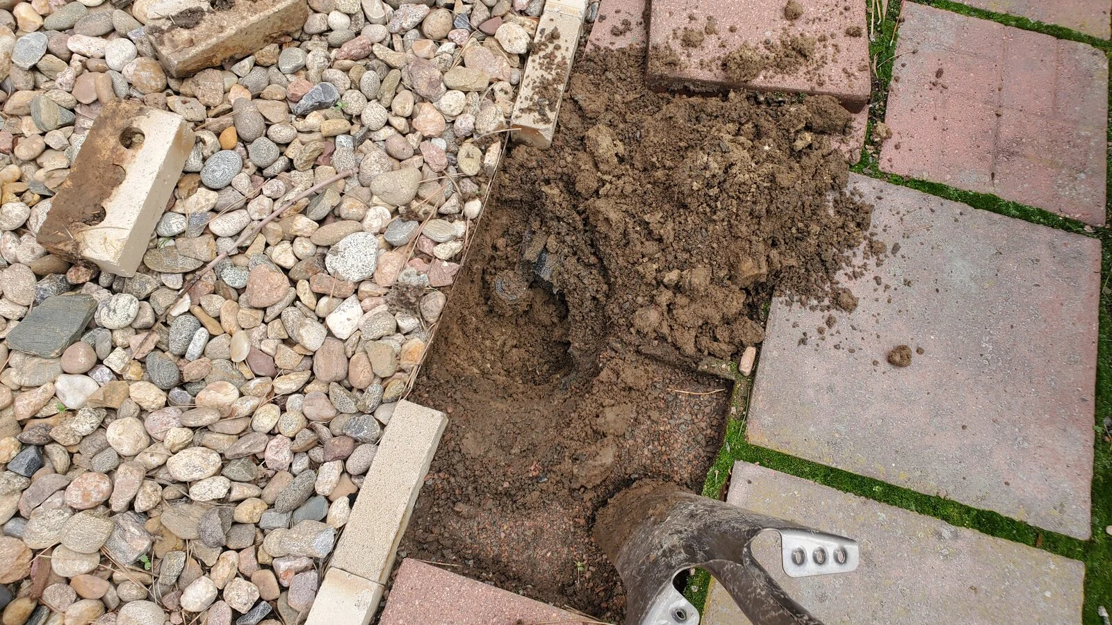

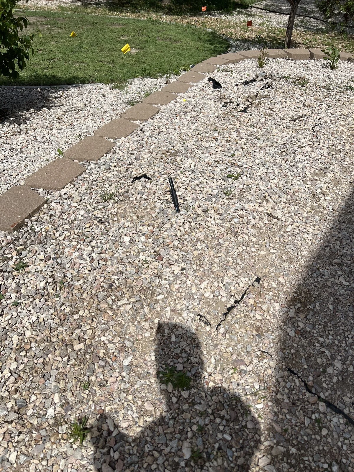

Updates. This morning I found one more line break. This one in the flower bed you can see in the previous photo. I was noticing that the sprinklers were having a hard time popping up and when they did, the pressure wasn't great unless I manually opened up the inline valve a little more. So, I'll try and get that one fixed tonight. I could put another sprinkler head there or a manifold and use it to water the flower bed with shrub setup.
The backyard has been a nightmare. Of the 12 sprinkler heads:
3 actually work.
1 is located directly underneath the deck, so that does no good.
3 have had stone pavers placed over the top.
1 was a main line break (1") from a tree root.
2 are broke at the swing.
1 has had a raised flower bed built over the top and was also broke at the swing.
1 was buried under about 6" of soil (surprisingly still worked)
Getting tired of digging these damn things up.
Several of these have been moved. Several have been replaced with 1/4" manifolds to water landscaping that I hope to do this next month. Yesterday I tilled up my dirt patch, threw down compost/manure, peat moss, and mycorrhizae to add nutrients and break up the heavy clays. I also thew down some tall fescue which hopefully I am not too late in the year. A bag of fescue to cover 2500 square feet was only $30, compared to $450 for sod. My yard is only about 450 square feet. Hopefully I start to see the grass germinate in the next week or so.
