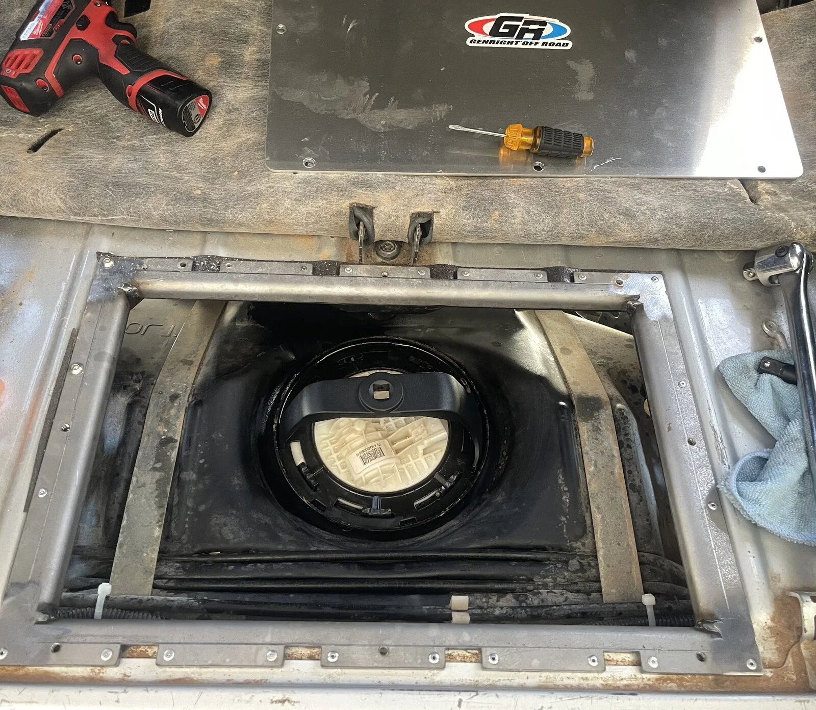

Aaaaand my now 3rd replacement pump is dead and I’m waiting for aaa …again. This time it’s not even sputtering it’s just dead. I was driving and it just cut out. Of course I had filled it up last night so now I’ll have to removed the tank full weight 😩

That was a Napa branded one. Napa would not give me a 4th pump so they refunded me full and I bought a “precision” one from o’rielys
The Napa one had a wire break off at the solder point within the assembly. I forgot to snap a pic
I ended up cutting a hole in the rear floor pan (and a lil of the fuel tank: don’t use a jigsaw) for an easy access hatch
I thought the pump shorted because of wiring, even though I analyzed every inch of wiring before I switched pump 2 out. So I was gonna wore a direct switch to the battery. But I think I’ll save that for if n when this pump dies.. for now I gotta build a hatch door
But hey I’m getting super quick at fuel pumps, this one only took a lil over an hour lol granted I had to cut a hole. But my next one should switch out in minutes 🙃

Could it be contamination inside the tank ?
i did a total tank clean out when i put in pump 3. I was thinking bad gas or maybe more ethenol that advertised maybe eating away at the solder contacts or something? but i dunno, got my hatch now so i can change it out in minutes now 🙃
