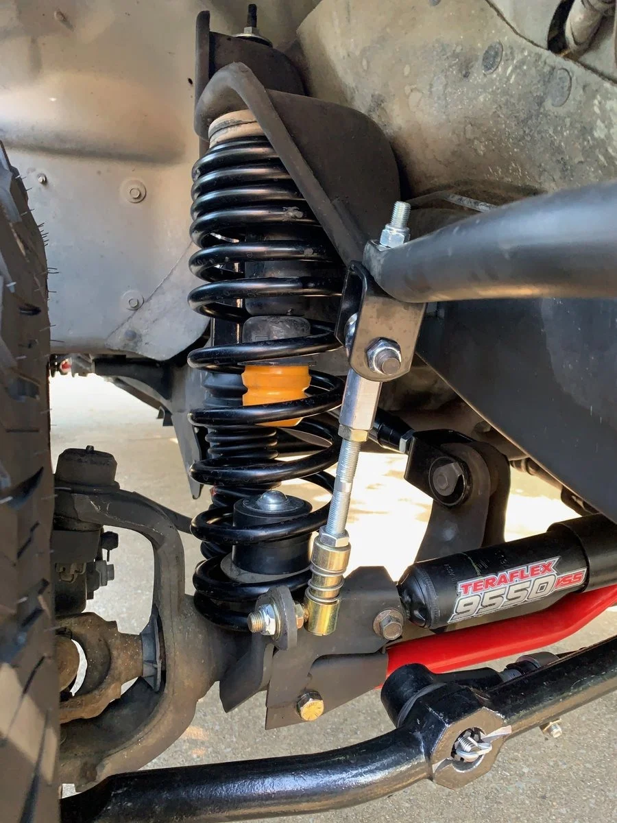

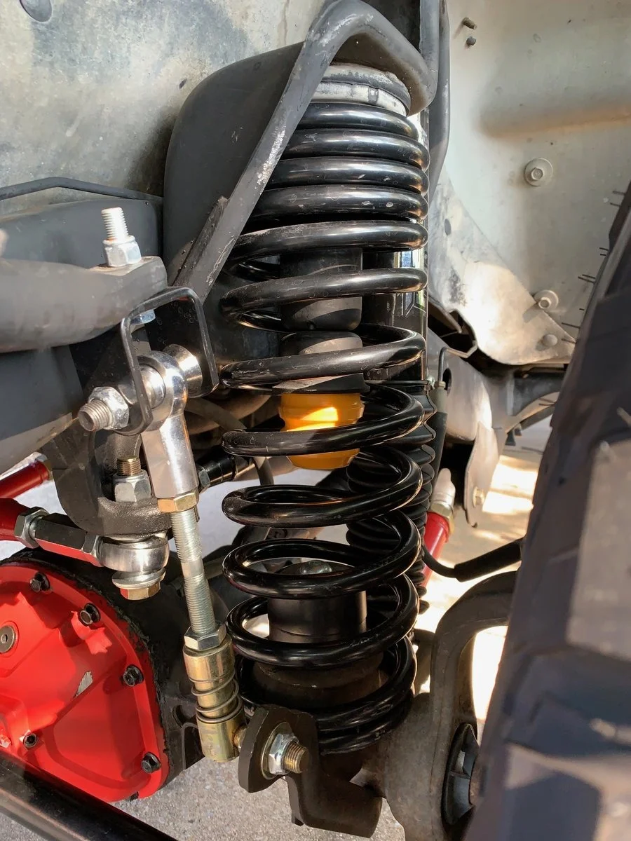

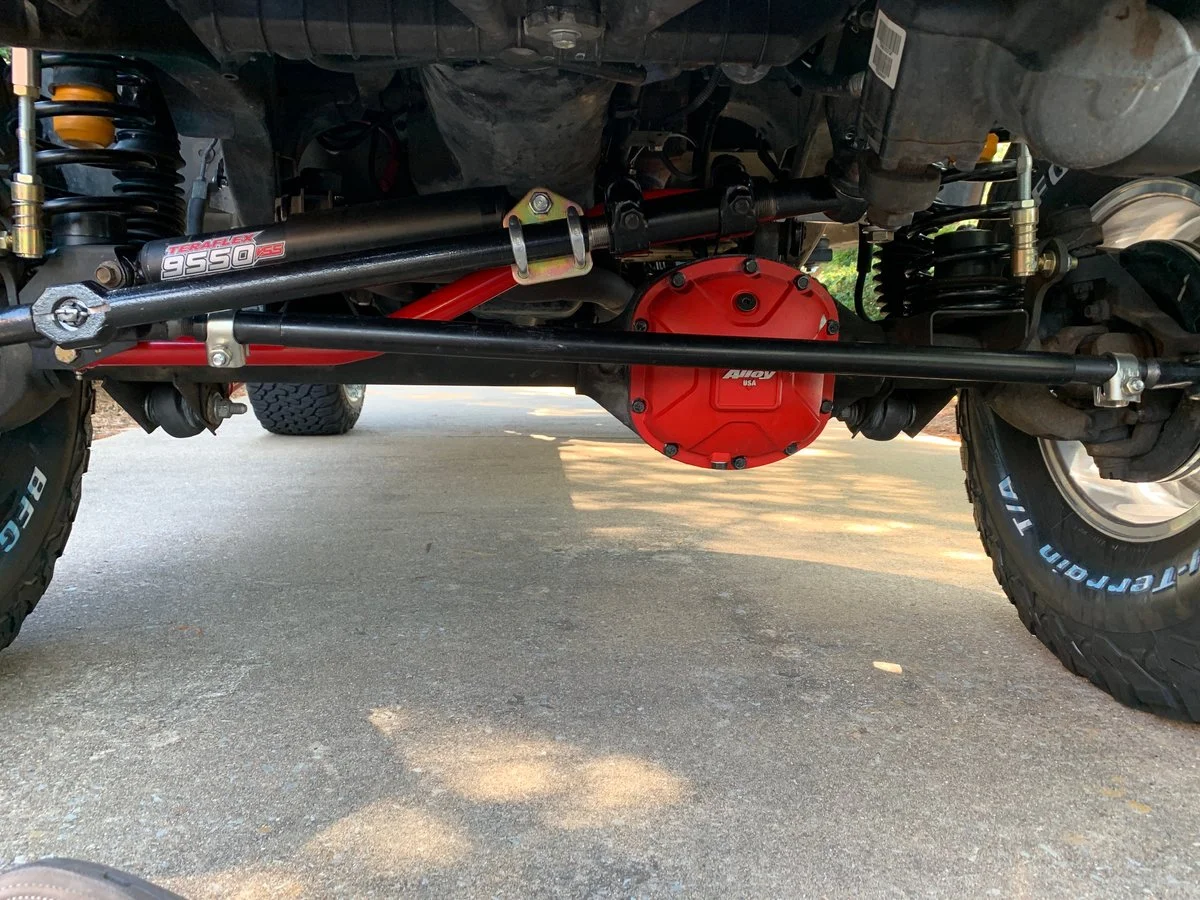

Thanks, good advice to include pics. Here is the updated suspension lift, it includes Rock Krawler coils and shocks (2" lift), Currectlync steering system, Teraflex steering stablizer, Steinjager sway bar end links and adjustable control arms. In hindsight, the only component that didn't get replaced was the spring isolators.
Let me know if there are any other questions or pics that would help.
Bob
Sitting in the driveway, the compressed springs measure 14 1/4 inch on the passenger side and almost 15 inches on the drivers.
Should I consider replacing the spring isolators?
If you look at the springs D side has top 4 wraps in contact and 4-5 space is small. On P side top 4 in contact, 4-5 has a much larger spread. That appears to be the issue. Are they both rotated in the upper bucket so the very end of the coil is sitting in the bucket properly? That could cause the spring to look off in the pictures. Some have a slightly longer spring on the D side so when a person is sitting in the Jeep it will level out when driving. [I read this in a forum. Not from any official install document so it may be total B.S.] but it sounds good. How many miles have you put on it since the lift? Everything looks correct so maybe a few hundred miles may help it settle. If everything is correct and it still bugs you put a coil spacer in the low side to level it out.

Looks like your track bar is contacting your diff at some point in its travel. Meaning your control arms need adjusted or you need a thinner profile diff cover.
Reactions: BobK
Also, turn your currie clamps upwards to avoid contacting the rocks.
He'll need smaller diameter bolts in order to rotate the clamps. I forget the size, but it's the next size smaller metric in a fine thread.
Reactions: tworley

4) The mark on the diff cover is from before the lift, the stock track bar did indeed make some contact with the diff. The new track bar appears to clear the diff when I cycled the suspension.
5) I would have to change the bolt size on the clamps and when I tried to rotate the Currie clamps there was no ability to rotate.
