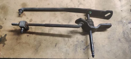

@dockdoc - I don't have all 4 rubber bushings, but I do have two of them and the parts pictured below (and the rest of the linkage if required). My experience with the rubber bushings was hit or miss. Half of mine (2 out of 4) came out undamaged - but I wasn't trying to save them either. Maybe if you had someone under to hold it while you loosen the bolt from the top?

Hey thanks appreciate it. Unfortunately I’ve already shredded all 4 bushings to get the thing out. They don’t seem replaceable. The parts you have pictured I’m actually set on.
