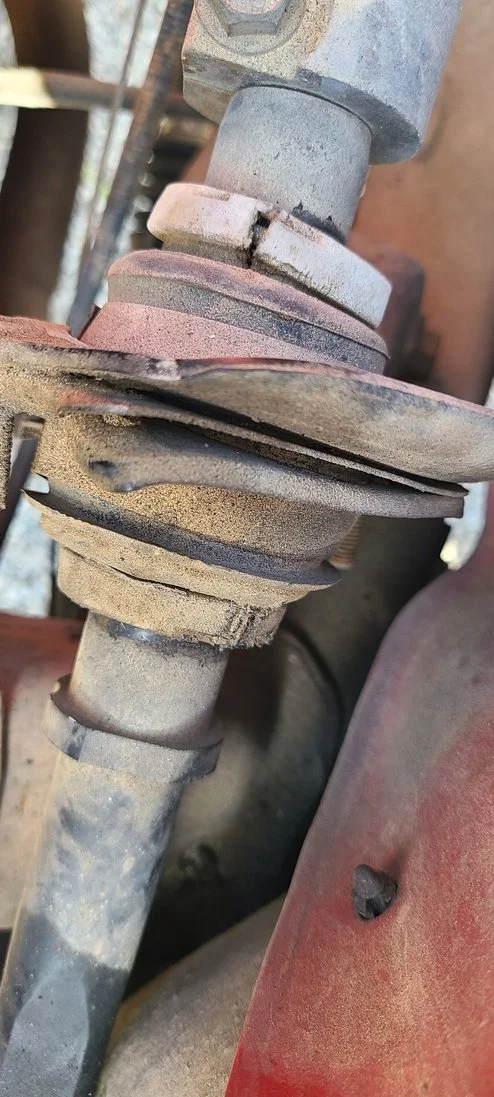

So back in July I installed a rebuilt ( Rock Auto ) gear box. Last week it started making a LOUD clunk when I turn the wheel to the left, and sometime when I turn the wheel the the right, It doesn't do it all the time. It took me a week to figure out where the loud clunk was coming from.
Anyone have this kind of issue.
Also this is the steering column, I think that white piece is not in the right place?

Sounds like the issue depends on resistance. Is the rebuilt gearbox OEM? Hopefully someone else will chime in.
If the clunk is happening everytime you turn left, then have someone turn the steering side to side with the engine running while you reach in and feel every connection steering and suspension related, including the track bar. You are listening and feeling for the clunk.

I'll give that a shot and let you know what I find. Thanx for the advice
