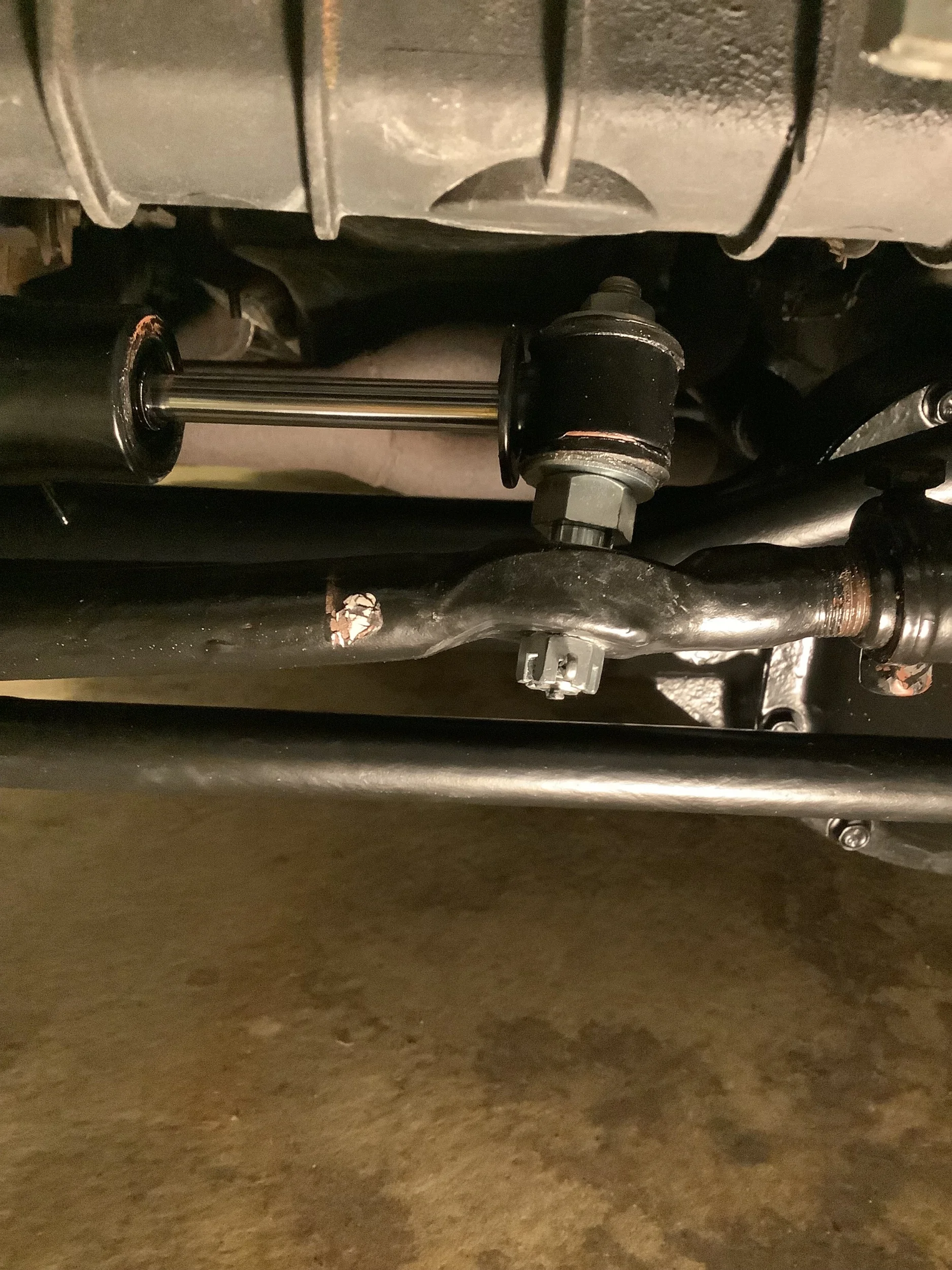

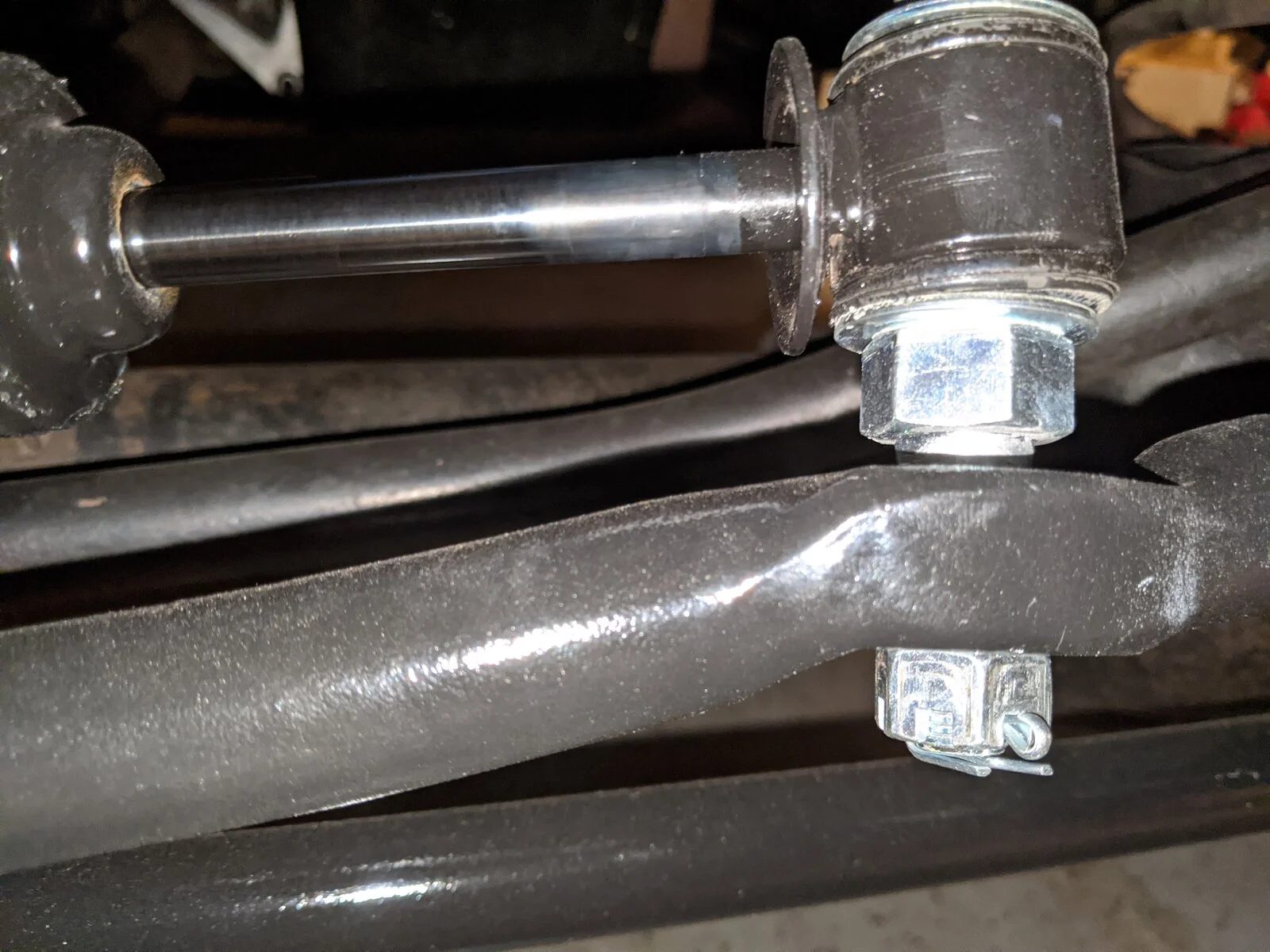

Here is what mine looks like. I expected the tapered shaft to fully seat in the drag link but there is a little bit of a gap. The cotter pin went in fine and it is tightened to spec. However, as you can probably tell from the pic, the steering stabilizer is a little bit out of perpendicular with the bolt.
I just did mine with a Moog TJ draglink and Monroe steering stabilizer. Same issue as you. The taper sticking up doesn't bother me but I don't like how the bolt is cockeyed in the bushing. Also I had to drill out the cotter pin hole a little bit, it wasn't right from the factory.
