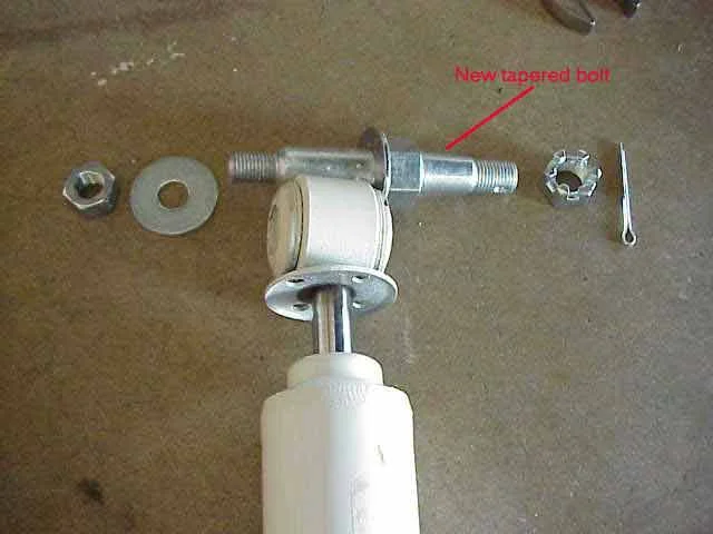

I don't want to take credit for @Jerry Bransford's hard work so I'll just quote his is post from another thread about steering stabilizers:
A good basic steering stabilizer/damper is just a hydraulic shock that is valved 50:50 so it resists equally in both directions. They don't cost much and something from Monroe, Rancho, etc. that isn't expensive is absolutely fine. I run a very basic Rancho but have used other brands with no real difference. Higher-end stabilzers are normally gas-charged because they're sold by high-end shock manufacturers who usually make nothing but gas-charged shocks. There's no real benefit to a gas-charged (aka "nitro") steering damper because hydraulic shock problems like cavitation that make gas-charged shocks good for suspensions don't exist for a steering system.
Go with a less costly steering damper/stabilizer (which will be hydraulic) and you'll be fine. Make sure the steering stabilizer kit includes a tapered mounting stud as shown below. The OE tapered mounting stud is a permanent part of the OE steering stabilizer so you'll need a replacement after you have removed the OE steering damper.

Steering stabilizers are pretty much the same, there's really not much difference in most of them. I would only insure it is the normal hydraulic type, avoid those that are gas-charged as some of them can push on the steering and cause the Jeep to drift.
Also, your OE stabilizer has a stud in it that is a permanent part so you'll need a replacement mounting stud which looks like what is below. Some kits include that tapered bolt, just make sure it does.
This would work fine and it includes the required tapered mounting stud. https://www.amazon.com/dp/B000CB42O2/?tag=wranglerorg-20 The above recommendation for Montroe is a good one too.
