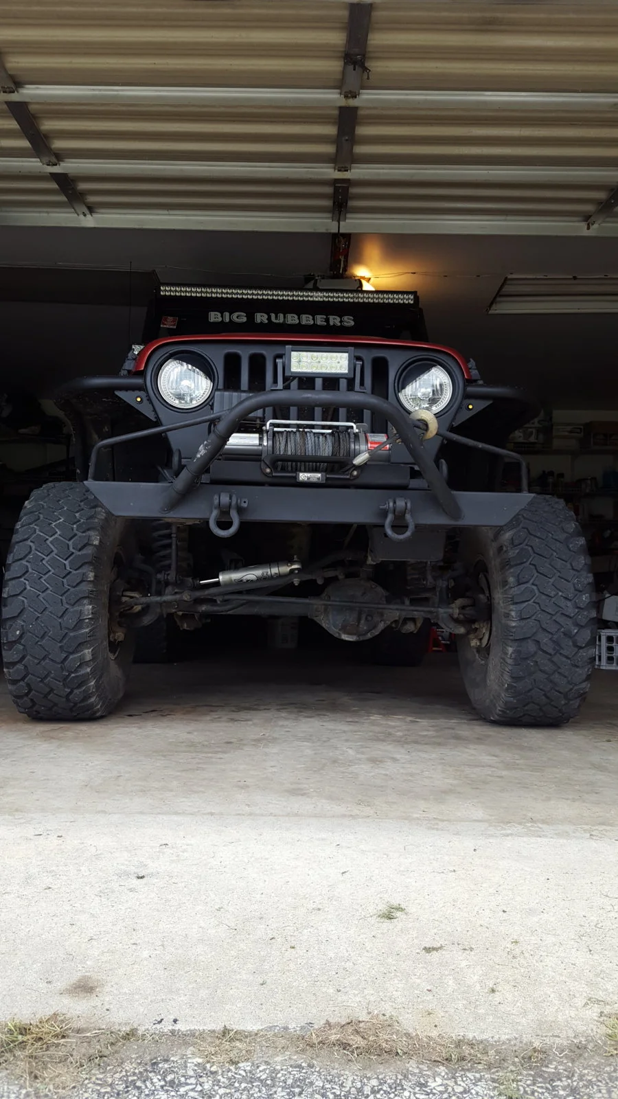

Had death wobble for 4 years changed everything called 4wd. talk to them bought thre Fox 2.0 steering stablizer said it was for 37in. tires said it might pull a little i didnt care if it takes away the wobble to my surprise GONE.. cant beleave it 4 years and its totally gone so happy.

Do you know you did not solve the wobble issue?
It is probably your tires.

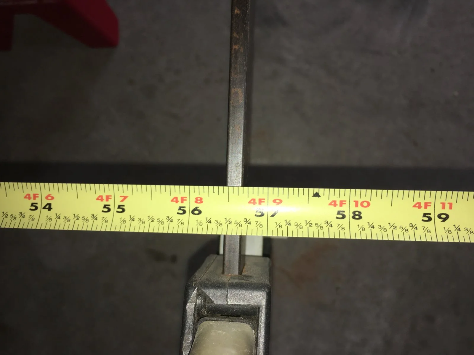

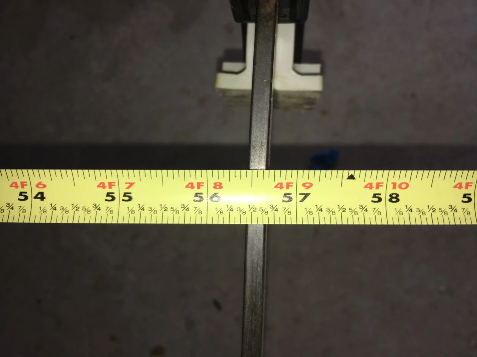

That's why I'm going with the balancing beads. To solve DW. I thought I solved it with a new MC trackbar. It did help. But got it today, first time since May. Trackbar is still good at the axle. Beads first. I expect this will solve it. If it does I'll add the new stabilizer. Stabilizer doesn't solve DW, it only hides it for awhile. Wish I were wrong for everyone's sake, but I'm not. My alignment is perfect

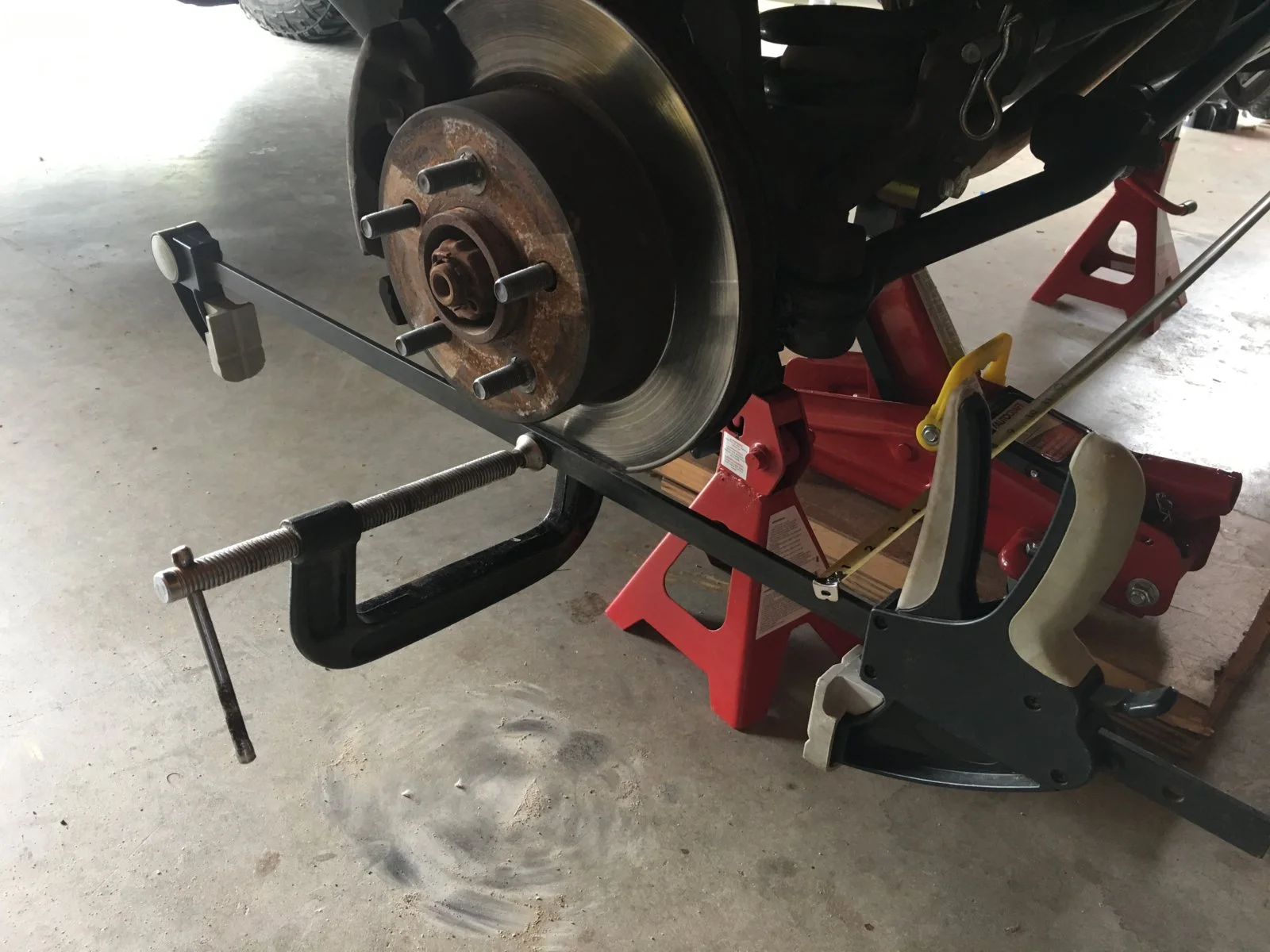

Ok, explain this. I have had a shimmy in the steering since May bw 40-45mph. Then yesterday I got DW in that same mph zone. Arghh.
Frustrated, I removed my front wheels to make sure I had perfect alignment. As you can see from pic above I was dead on. I remounted the front wheels and no longer have a shimmy or DW. WTH?

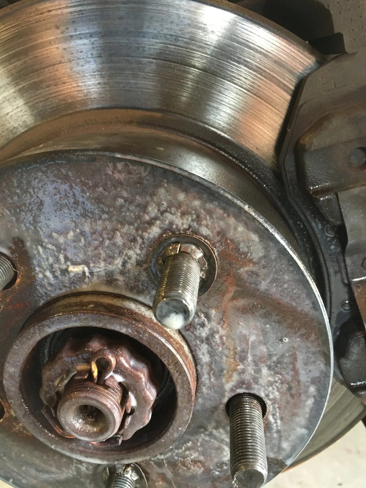

I did remove the two factory lug nut thingies pictured below, from each side.
Could that have fixed my problem?
Only other thing I can imagine is that removing and remounting my tires changed the orientation of each to the other? Of course, that can happen on the road naturally. Make sense? Anyone ever heard of such a thing?
Shouldn't you be toe'd in just a tad? Looks dead even front to back based on your pics.
