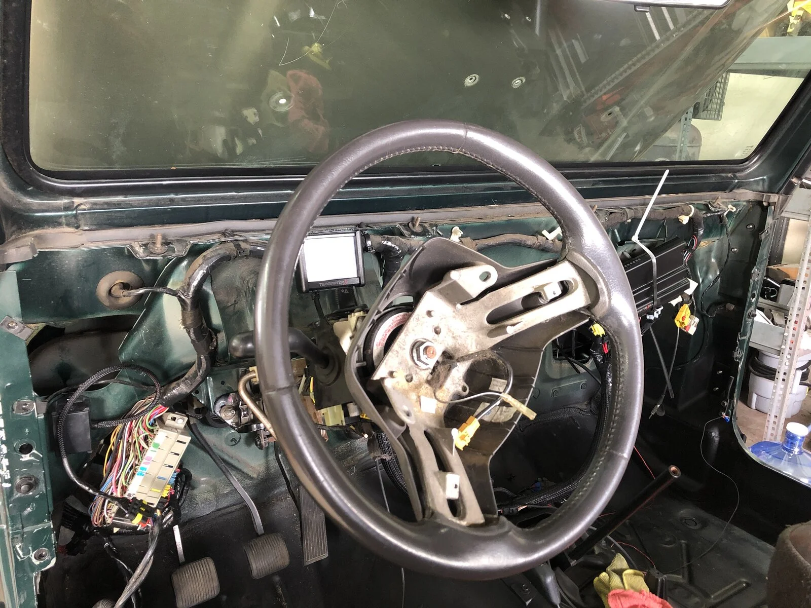

Just took my 2000 in for an alignment and they could only adjust it so far before the tierod and tierod end bottomed out in the sleeve. All new suspension and steering box. I have seperated all the steering shafts for the LS swap. To do the LS swap I had to mount the support about 1” away from the frame. As far as I know, all the steering shafts are keyed and can only go on direction. I have never removed the steering wheel, but I was about to in order to clock it to match the alignment and that is also keyed. Was there something I am missing?

The only thing I could think of is maybe the coupler from steering column to intermediate shaft might not be keyed to only go on one way. I have to take the steering column out again anyways to get the dash back on so ill look again then.
