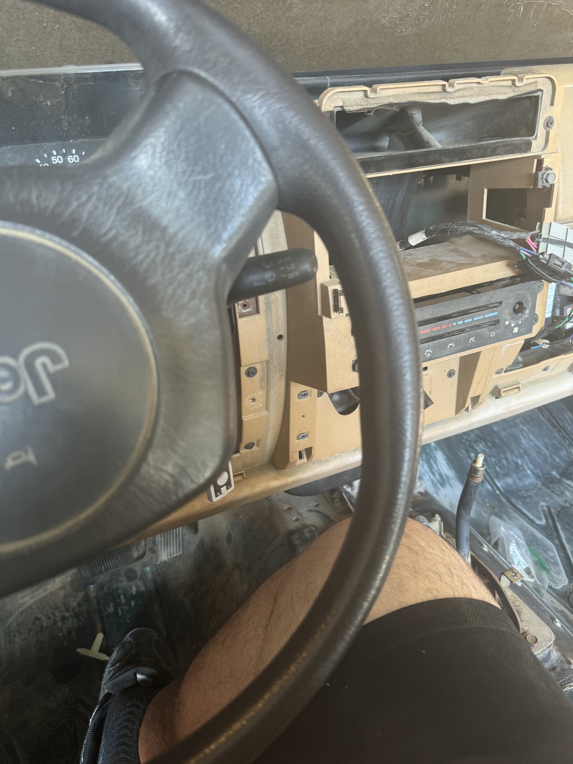

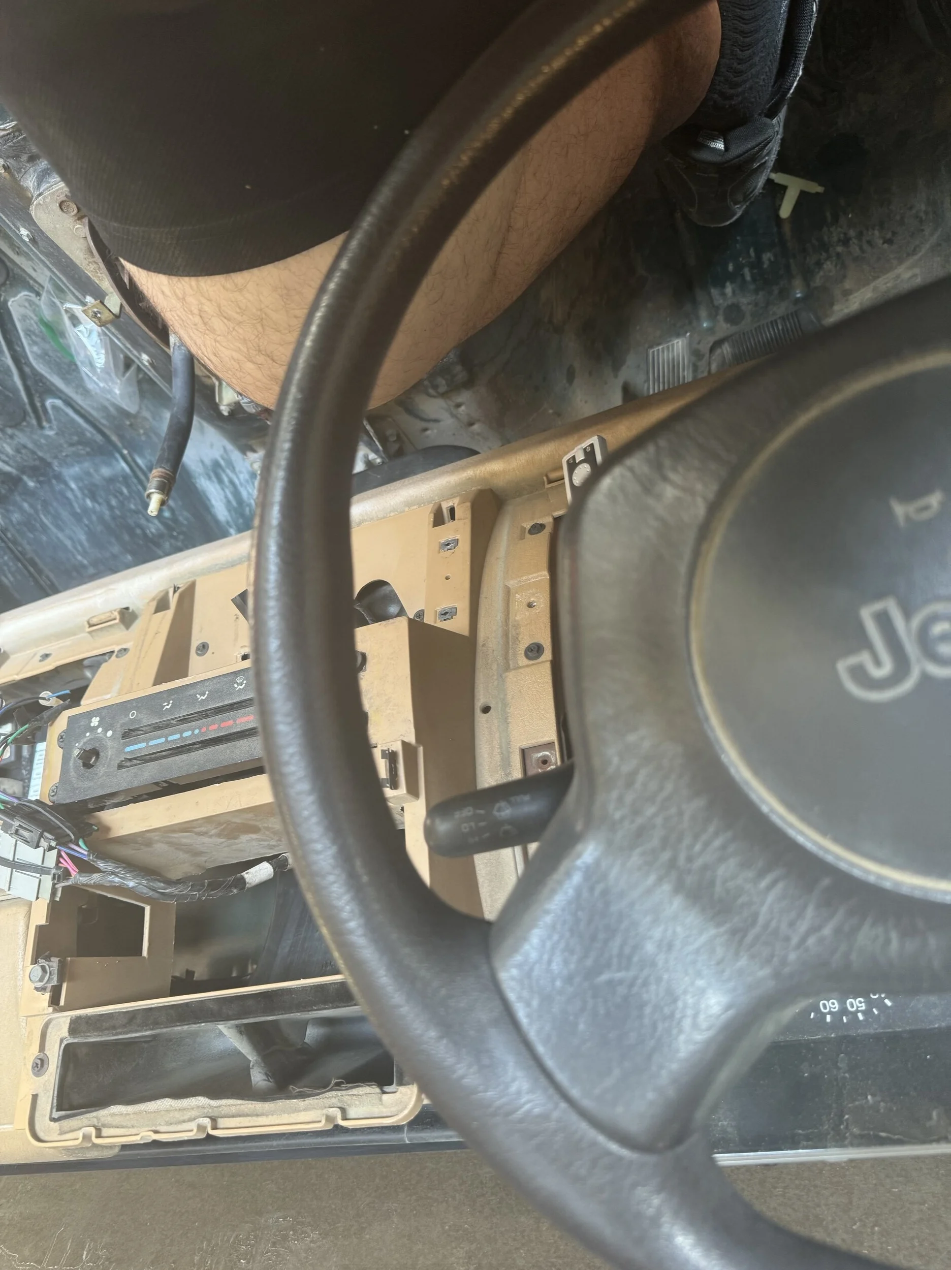

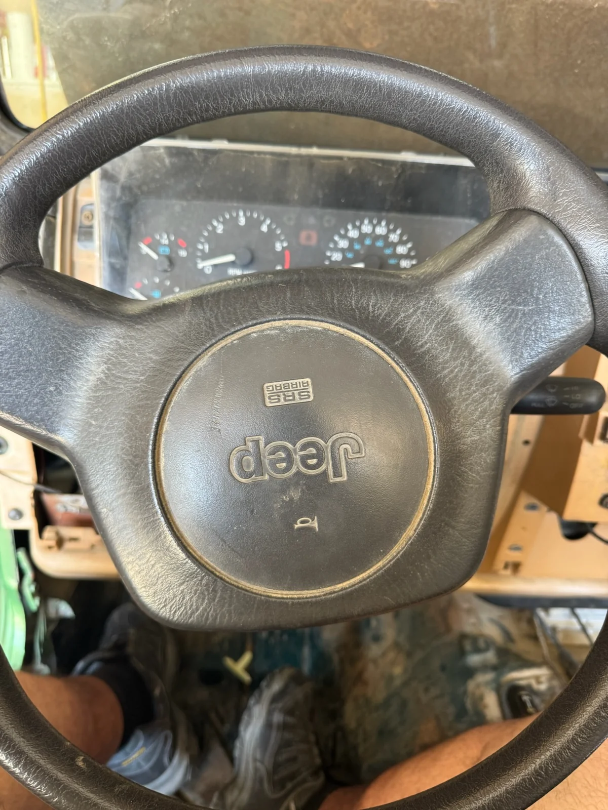

I’m perplexed with how I managed to to screw this up. The bottom of the steering column is keyed and can only go into the intermediary coupling one way. The steering wheel is also keyed and can only mount to the shaft one way. I had the column out to remove the dash. I also replaced all the steering components attached to the Pittman arm. I don’t want to take it all back apart until I understand what I did wrong.

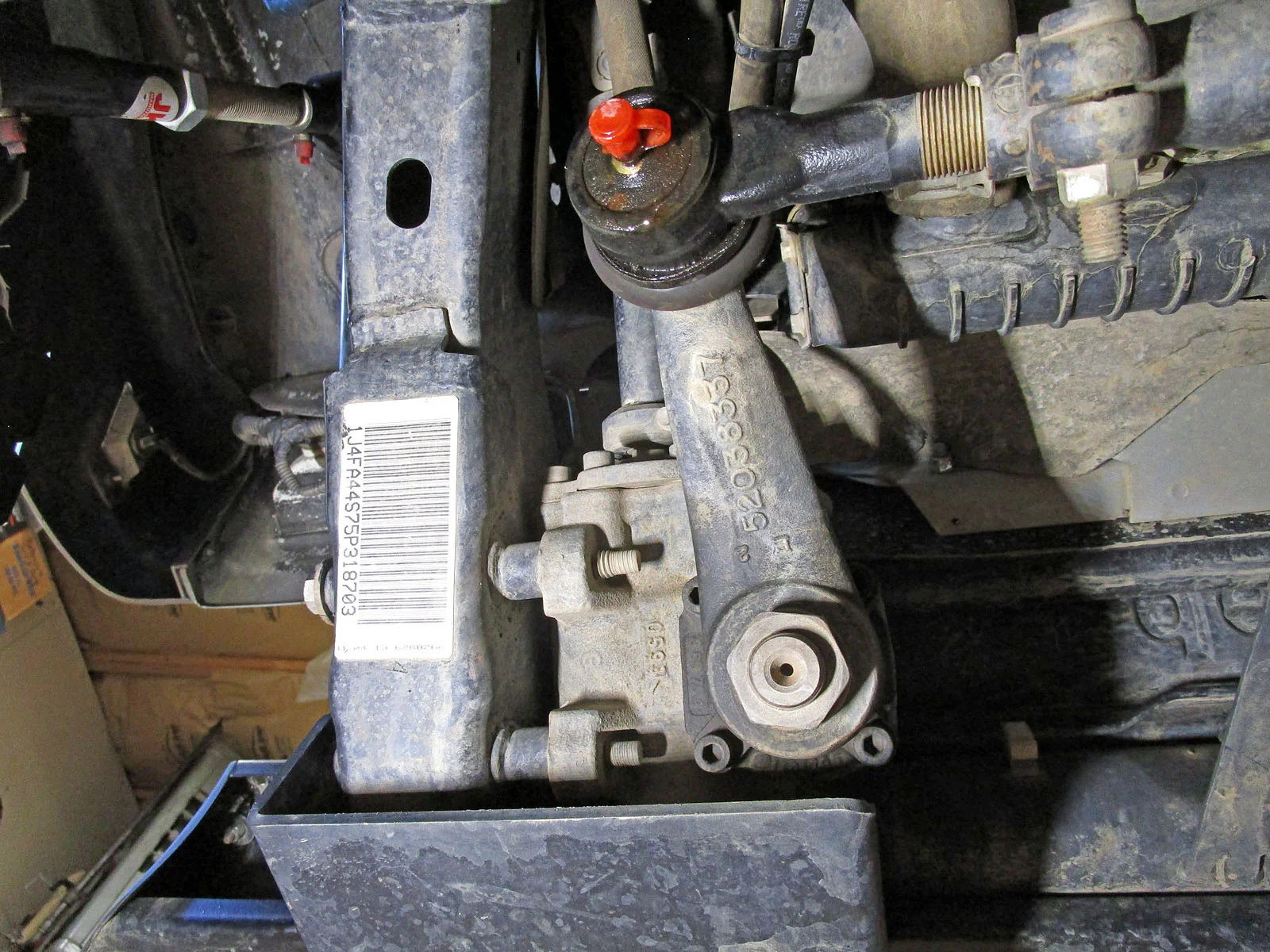

It has to be the drag link adjustment if its the oem pitman arm and only the steering shaft was disconnected other than drag link/tie rod replacement

Correct. I will try the drag list adjustment this weekend and report back. I think the clock spring is ok, because when I was running the vehicle the airbag light was off. I haven’t installed the horn yet so I wasn’t able to test it. I have a replacement clock spring regardless, because when I removed the electrical connectors a few years ago the connector housing on the clock spring broke.
