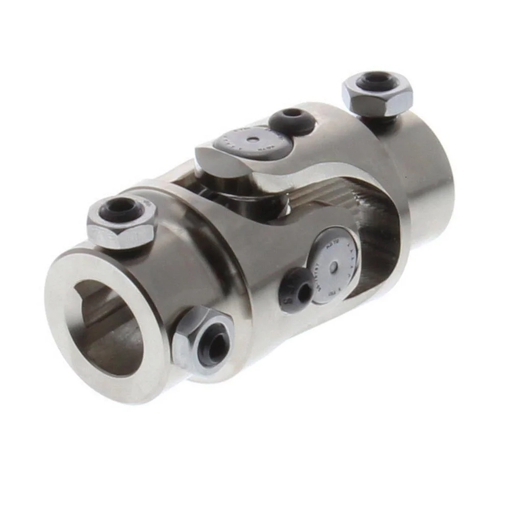

Couldn't hurt to check the steering shaft knuckle for wear.....
https://www.summitracing.com/parts/...laming-river&gclid=CMyCxK6J8c8CFUxsfgodx9cMEQ
