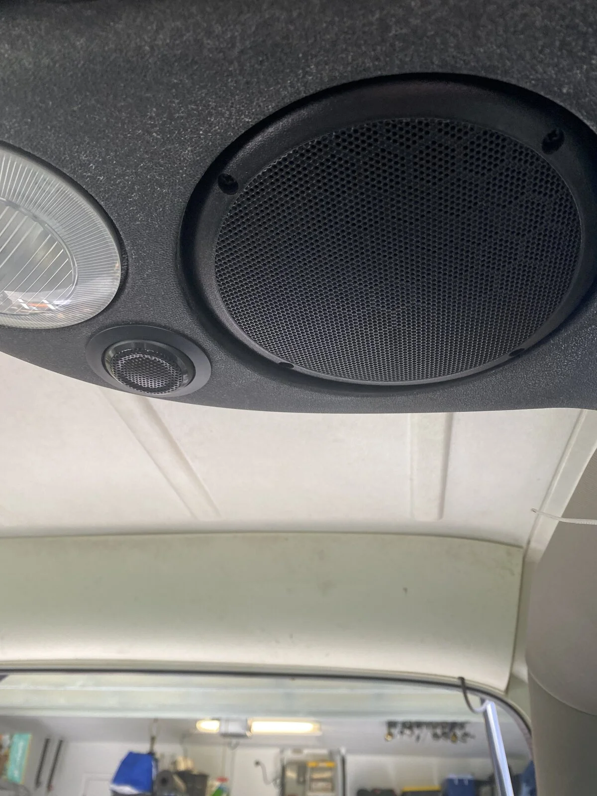

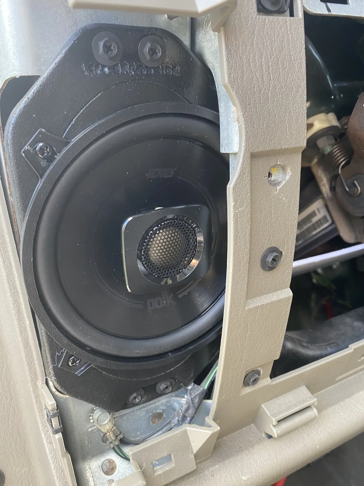

I upgraded to double-din, added the Polk 5.25" in the dash, w/ tweeters above, Polk 6.5" in the sound bar thinking it would be 'good enough'; it wasn't.
I ended up adding an additional pair of 6.5" in the footwells, a small amp under the steering column, and an 8" powered sub under the drivers' seat.
Now it finally sounds good enough that you can turn it up to hear it on the freeway when the doors and top are off.
It won't win any competitions, but it sounds 1,000 times better than the factory setup.
thank you. Can you share a picture of the tweeter mounted above the Polk 5.25" Thank you!

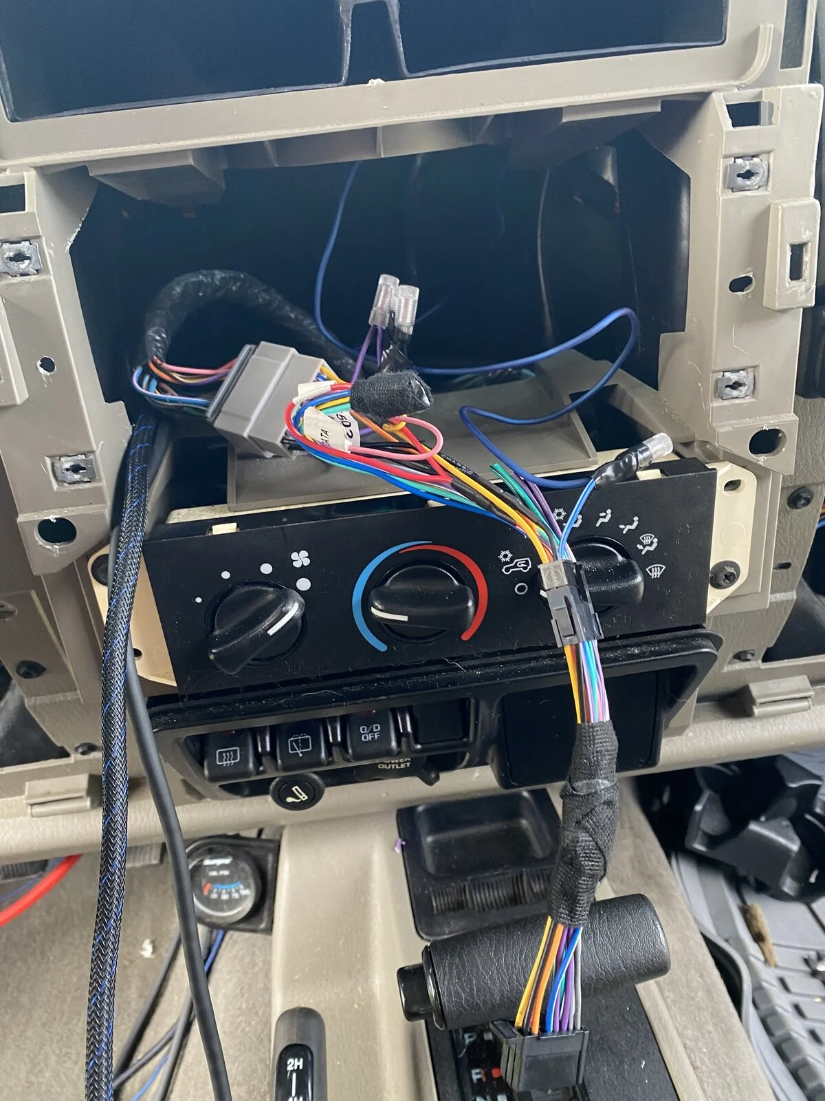

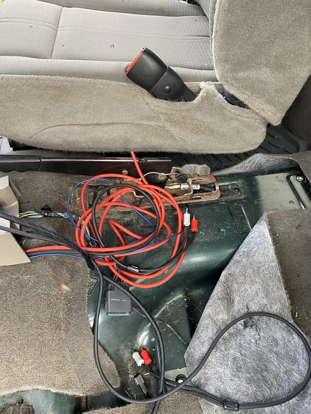

SO....started as a little upgrade and now the whole system is going and being replaced. Ended up with a Kenwood x705 head, JL Audio Amp 75 x 4, new Polk Audio speakers up top (DB522) and in the dash (DB5252) with select increments dash pods, the dash will have the benefit of added tweeters on the dash. The base will be a Sound Ordinance 8" self powered unit in the center console to round out the bass. Struggled with how to deal with the bass but there are many good reviews for the SO unit for us classic rock, country, jazz listeners...
In for about $1,300 as of now and a full day of install I am sure. I am sure this will be a meaningful upgrade from the 18 year old stock system...
Thank you all for the friendly advise will post some pictures of the install to help others and my thoughts on the sound when complete.

Question. Car all apart…project underway and done tomorrow. The old plug from the stock sub in the center console, since I am putting in the SO self powered unit do I need to do anything with that plug? It has a lot more wires connected to it than the sub???
can I just tuck it away somewhere and forget about it?
thanks

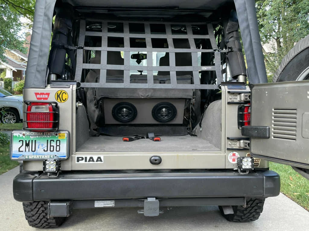

The best write up I have seen was on another forum, but check this out. This guy went all-in.
http://www.jeepz.com/forum/accessories/22414-subwoofer-inside-jeep-wrangler-rear-seat.html
@Chilidawg keep in mind the pics for that write up are for the newer tj seat whereas the instructions linked in that write up are for the early tj seat.
i ended up using the dims for the bottom panel where the subs mount off of the pdf linked and used cardboard to make template for the rest since I needed the box to be deeper for more air volume.
took about 5-6 hours to get a sealed box making my own templates.

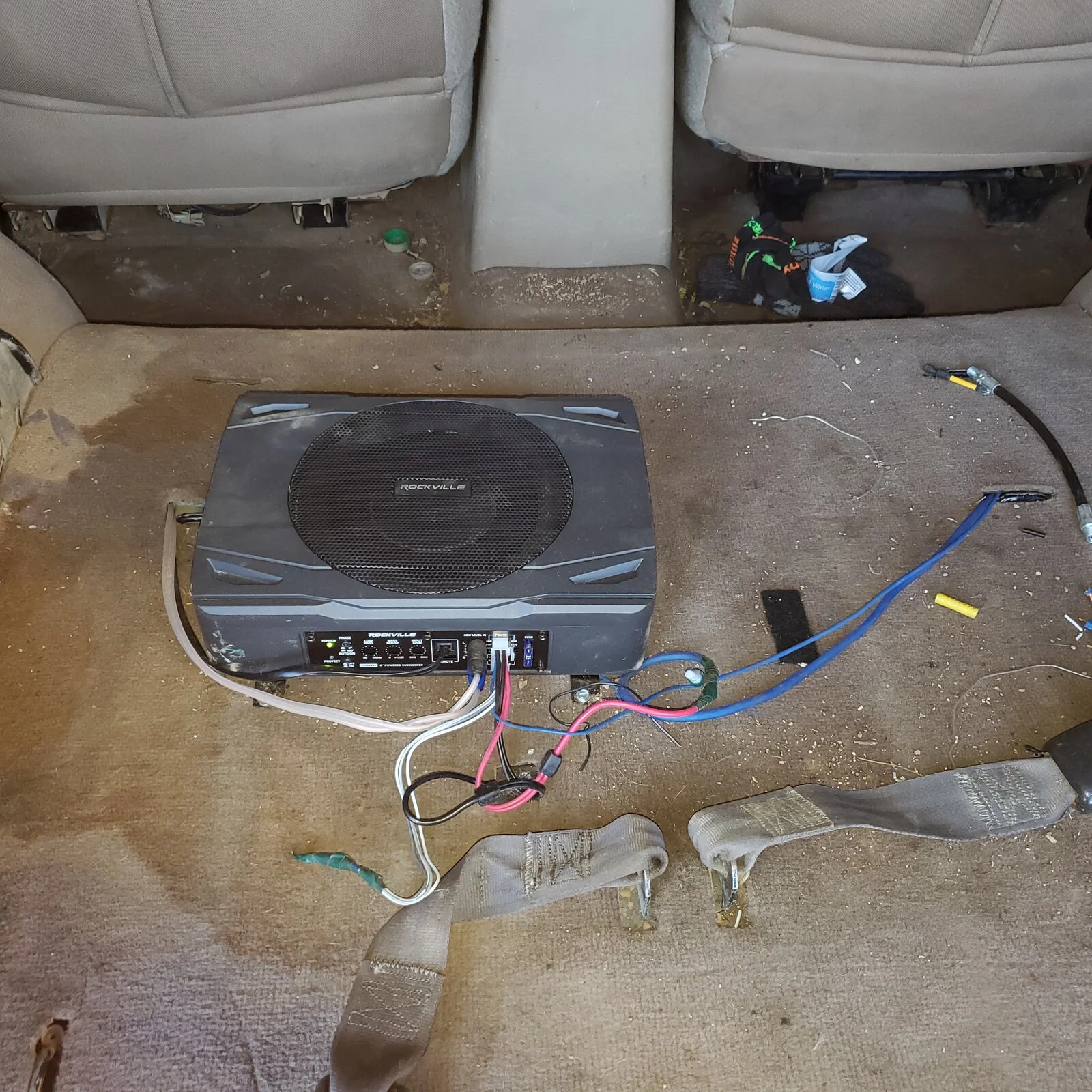

I added a 8" powered rockville sub like $109 with amp kit included. Revised to a newer jvc single din bluetooth deck. Played with power and gain settings and eq features in the dash unit and am now extremely pleased with how it sounds. I was very impressed with just how much bass that powered sub produced. Its literally the size of a amp and fits under the back seat. I horse traded with a stereo shop owner buddy for the deck. Have around 125 in the speakers and 110 in the sub the deck is about 150 bucks. Really impressived for the money spent and how it sounds so far. Still wanting to.build pods for my doors but it lower on the list now
