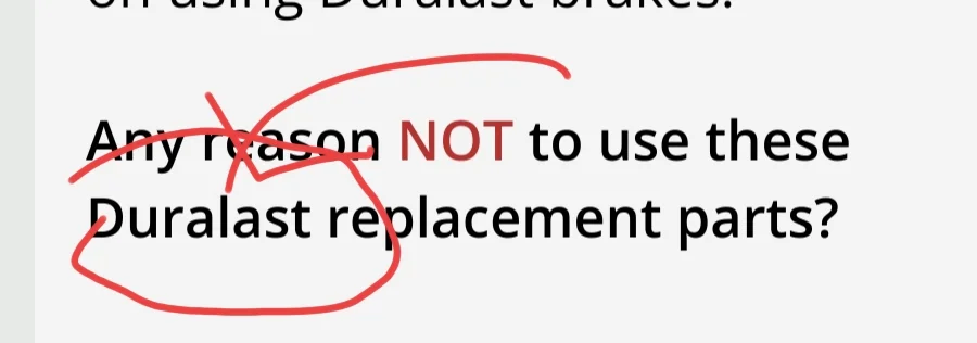

Any reason NOT to use these Duralast replacement parts?
