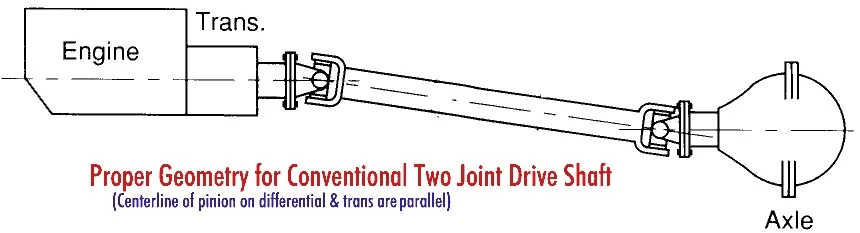

Adjusting your control arms is not the real answer for the rear pinion angle. With the stock rear driveshaft the rear pinion angle still needs to be parallel to the tcase output shaft angle and now, due to your 4.5" lift, the driveshaft u-joints are nearing their angular operating limits. For a 4.5" lift you really need to install a SYE kit into the transfer case and replace the factory driveshaft with a DC (double-cardan) driveshaft. 4" is the usual time for that to be done.
This is how the rear pinion angle needs to look with the factory single-cardan driveshaft which is how the factory adjusted it.
