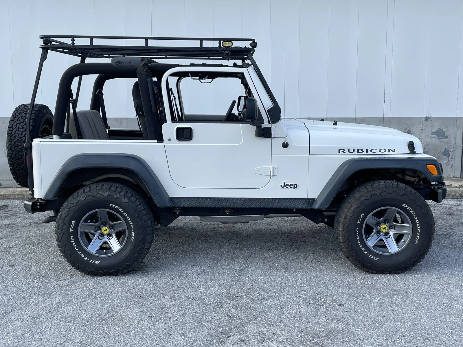

Are those the HD springs for the additional weight of your roof top duck pond?
to be honest I can’t remember what all I did as far as choices- But I do know exactly what the overall package is- Dirk at DPG put it all together. It is definitely just a touch on the firm side....It drives better than any TJ I’ve ever driven- It has proven to me that the selections of control arm joints and other choices can be felt.
