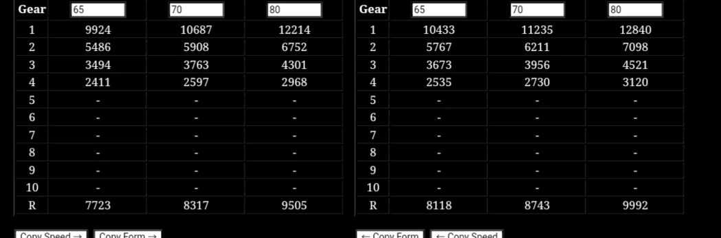

4.88 on the left. 5.13 on the right. (65,70,80mph)

I have almost the same setup: sport,2004,4.0,42RLE, stock 3.73 gears.
I am running 245/75R17 with is pretty much identical to your tire (mine 31.5 in inches, yours is 31.7).
I have purchased used Dana 44 (if I would stay with Dana 35 I would go the super 35 path, with better carrier and shafts) and Dana 30 High Pinion (from XJ) with 4.56 gears. Today looking back, I wish I would go to 4.88, or even 5.13. It is true that with 4.56, here in Houston area, that is flat as tile, I would be completely OK, but not ideal. My RPM at 70MPH will be around 2440, which is not ideal. Ideal would be around 2650 ( this is what 4.88 would provide).
Given your altitude I would not think twice and go 4.88. 4.88 will make your life much easier on highways with altitude changes.
Also, my plan for 42RLE is installing Derale transmission cooler (Jerry has the article here, with instructions and part numbers - I am going to execute exactly as Jerry instructed), performing a fluid flush ( BG Quick Clean, will do in my garage), replacing the filter (Mopar filter only) in it, and installing a pan with drain plug. Will be spending almost 500$ for cooler, filter, BG Quick Clean and ATF+4. Also I use Mopar ATF+4 only, not anything else.
As for stroker - without proper gearing, even with stroker you will not be in the right power band.
If you really want to get max power out of your rig, you can go 5.13 gears, which will be definitely overgeared, but will get you more power to the wheels at any speed. The price will be that you will be around 2850RPM at 70MPH, which some would say that is too high.

You're decision should be a simple one. Regardless of whether you go stroker, you need to regear. Skip the 4.88 and go straight to 5.13. Generally, people don't understand the .69 overdrive in the 42RLE and think 5.13 gears are to much, don't fall into that trap.
Also, add a transmission cooler and temperature gauge. That way there will be no more guess work, and you'll be all set for a stroker, when you're ready.
The numbers tell the story.....Your current RPMs, based on a 31.7" tire and 3.73 gearing, is to low and causing the transmission to work harder, generating more heat.

This, based on a 31.7" tire and 5.13 gearing, would put you where you need to be, plus give you that little extra, in case you ever go to a 33" tire.
